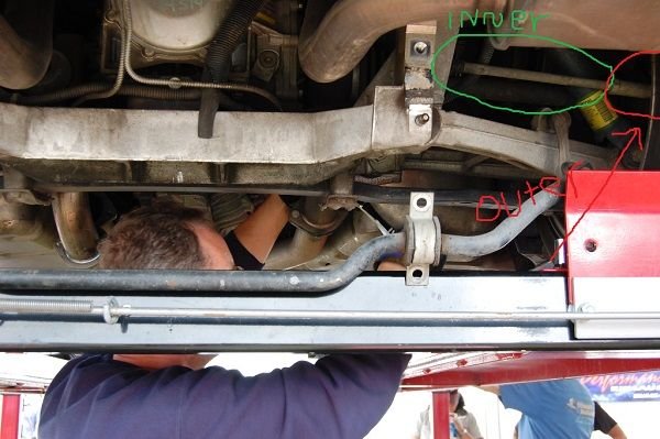

Inner and outer tie rods for one of the rear wheels is failing and allowing that wheel to twist instead of pointing straight per the alignment specs. The tie rods are whats adjusted by the alignment shop to keep that wheel set.
To find out which wheel it is, jack up that side and grasp the tire at the 9 oclock and 3 oclock position and forcefully try to pivot the wheel inward and outward. If you can get a little flex, imagine 350lbs of torque hitting it.
Change both inner and outer at the same time.
Added this pic. The outer screws onto the inner shank and being able to adjust via threads is how you set alignment.

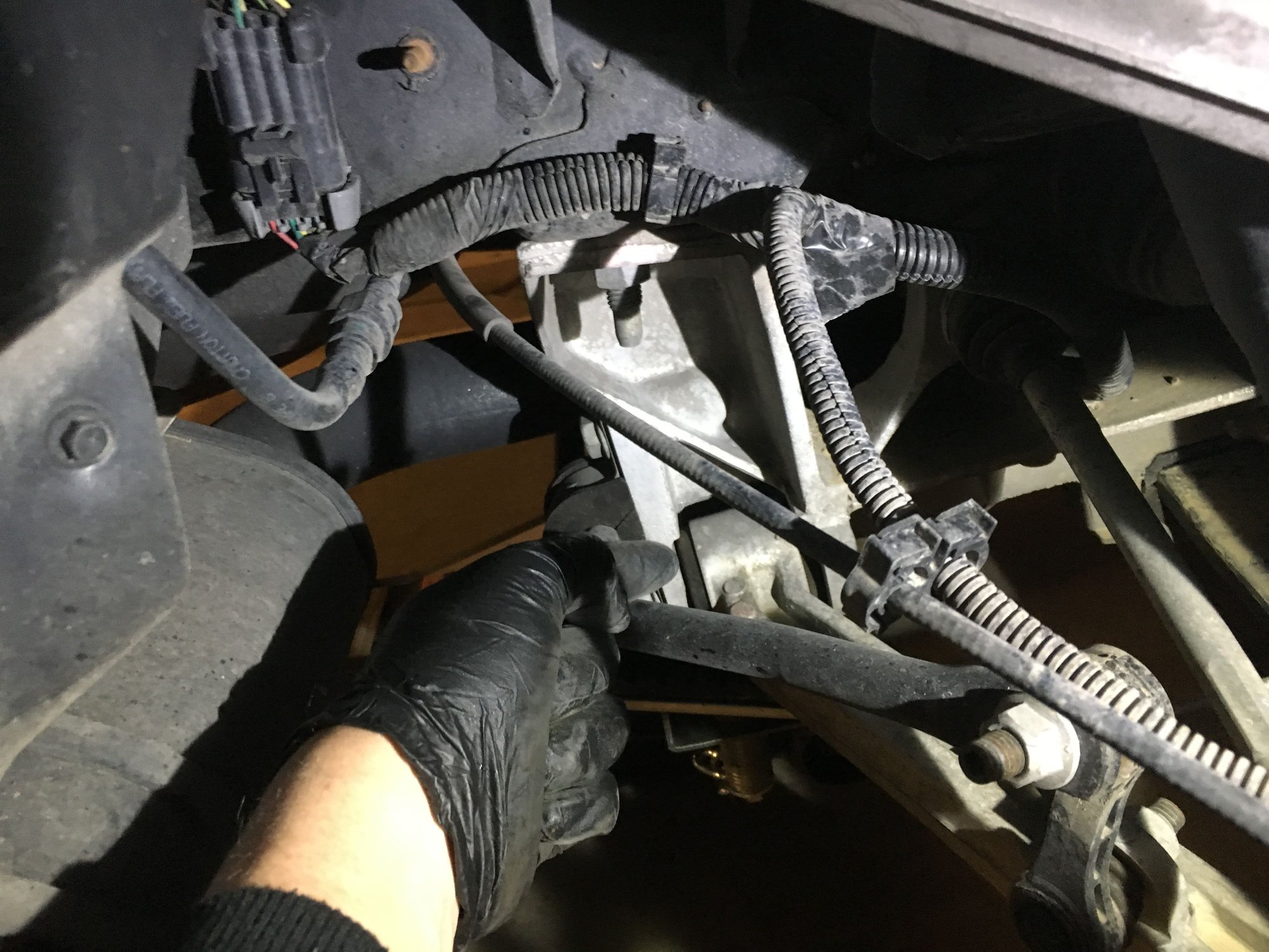

So have to give an update. I have investigated a few things and found the following.
  • Alignment:
    • Still to be done wish I had more time
  • Wheels:
    • All four wheels have damage from bad roads -> this is a work in progress, might replace the wheels with custom wheels and then at the same time replace tires as well
  • Tie rods, Upper/Lower Control arms
    • It is very difficult to notice play in the tie rods when you are working by yourself
    • very noticeable play in the upper control arm bussing (see photo A below)
    • I also think the lower control arm busing also had play in it but again difficult to say working by yourself (see photo B below)
Would the bushing be done in just 20K miles? Does these bushing perish over time? Are there similar bushings connecting the tie rods? Can anyone recommend replacement bushings kit?
Photo A
Photo B

It's hard to believe the bushings would be worn out in 20k miles. They are fairly rugged and seem to stand up quite well.
