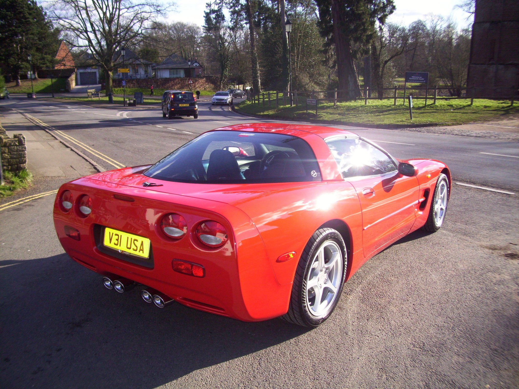

Secondly, due to its low use I do struggle each year to get it through its annual MOT test due to slightly high Lambda sensor readings. Has anyone used a cleaning agent in their fuel to help bring their emmisions down. I have been checking out a product called Cataclean, and just wondered if anyone has had positive results. A rare sight on British roads.😊
