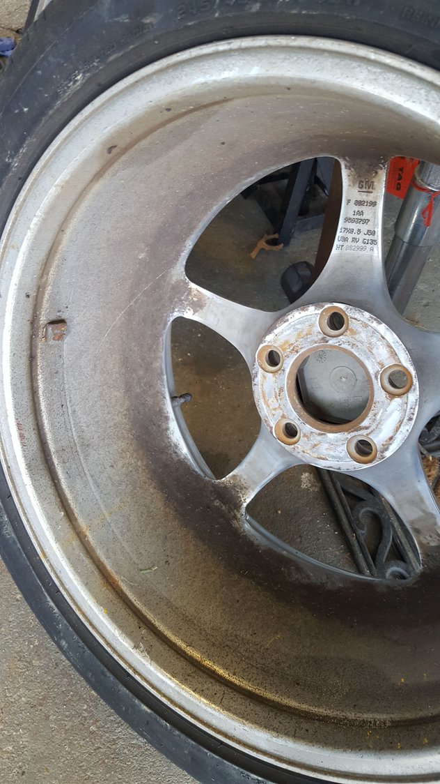

The inside of my polished thin spokes are really bad. I'm not looking for perfection, but is there an easy way to get these things looking 'Ok'?

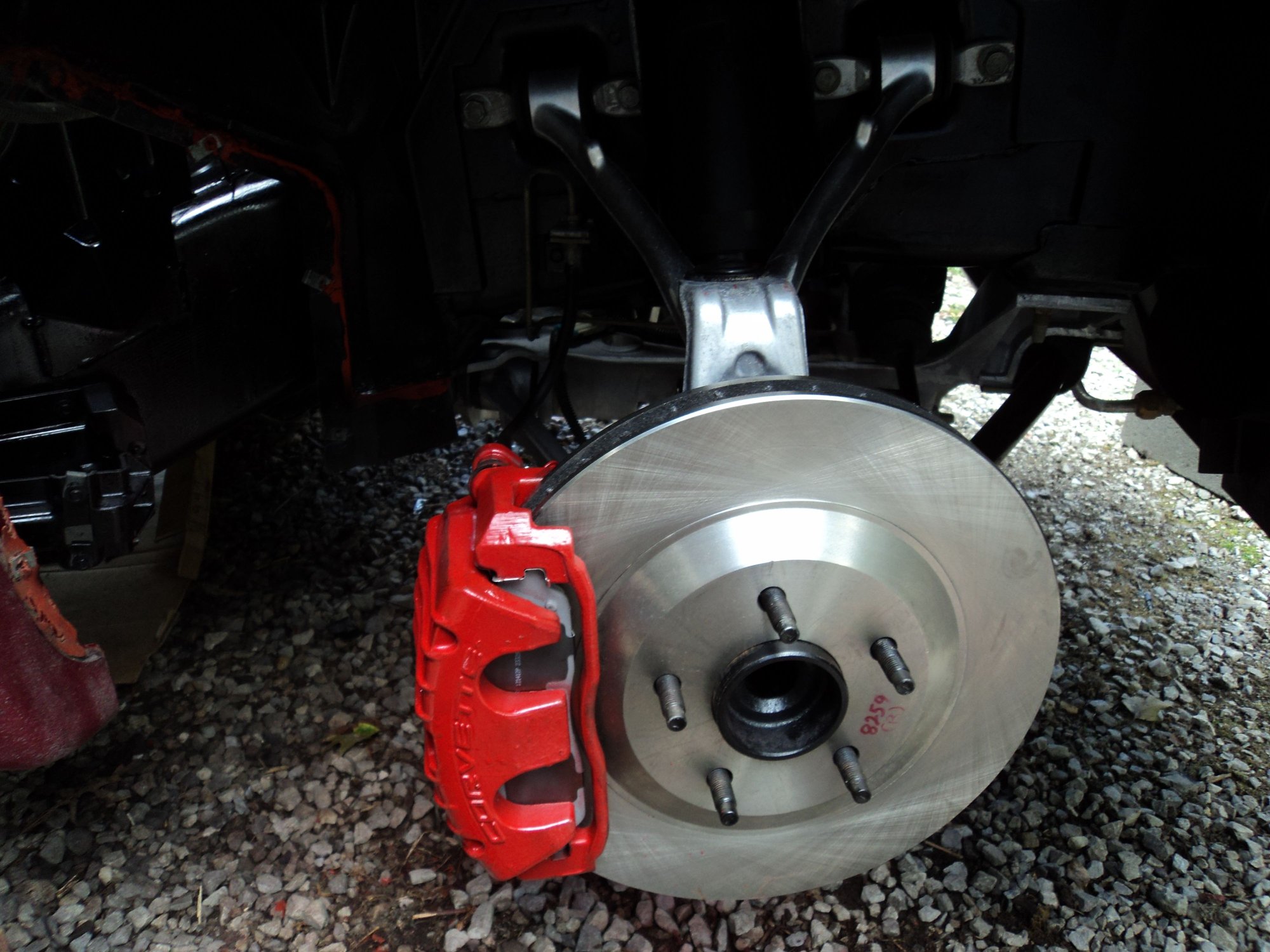

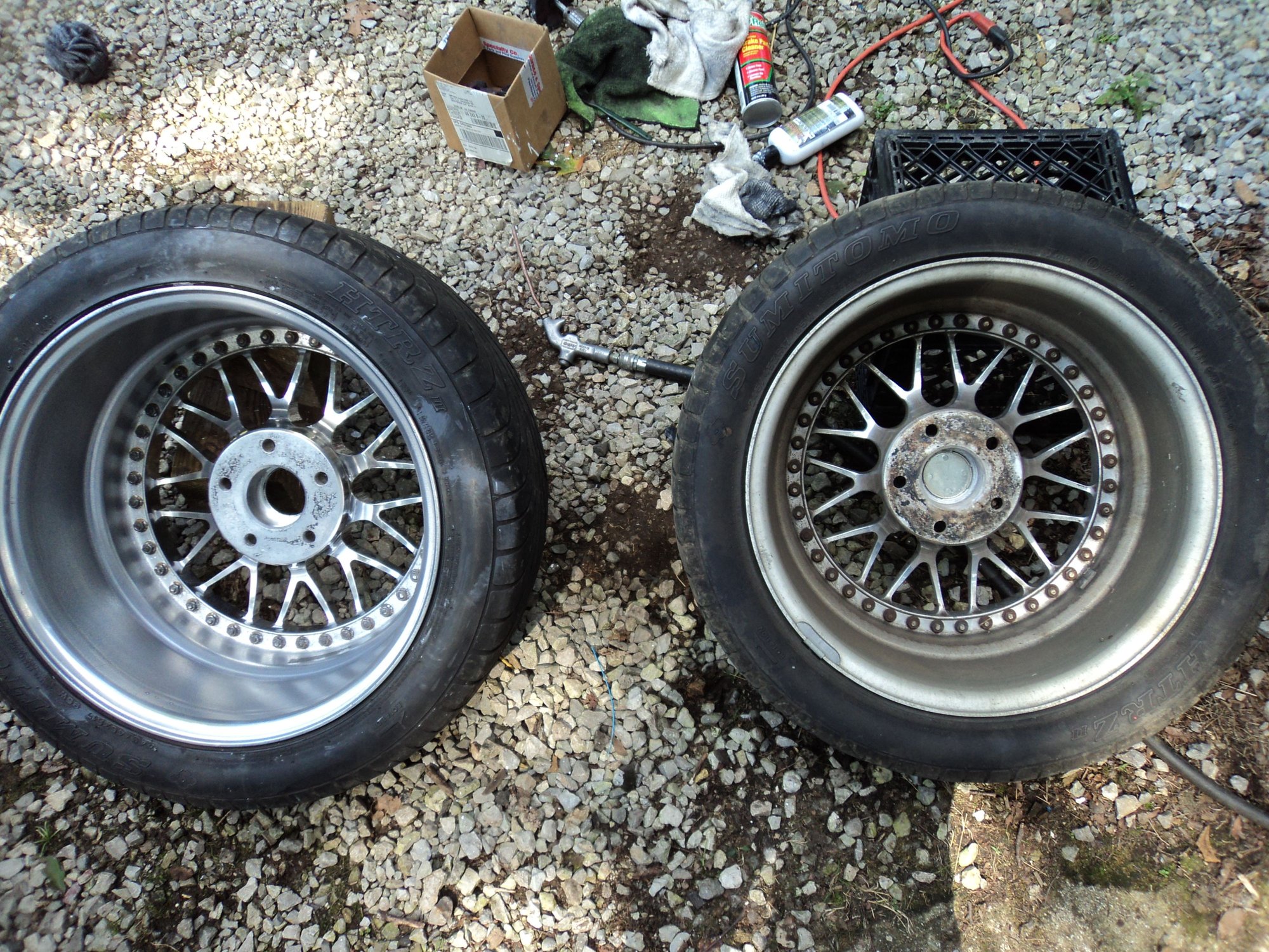

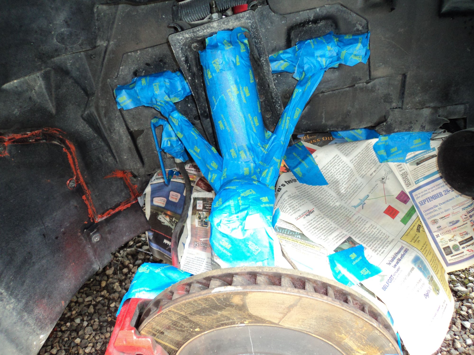

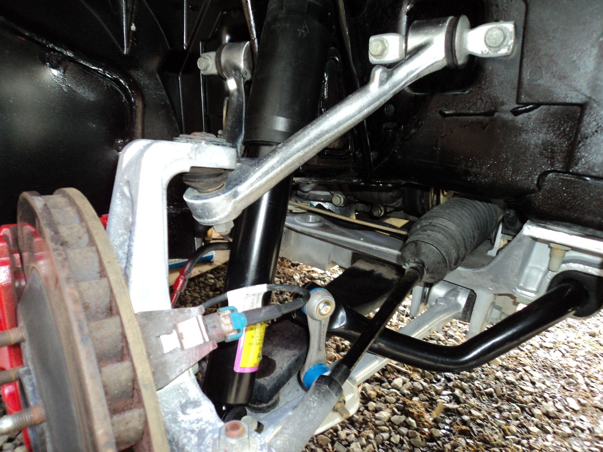

When I did mine, I sprayed them with wheel and grill cleaner. Its acid so be careful. Just spray it on the wheel and let it sit for a few minutes, then rinse it off with a hose. Next I used a soft wire polishing wheel. Then I used black diamond aluminum polish. Also-- While I had the wheels off I sprayed the aluminum parts parts under the car--(see pics) but didn't polish them, just cleaned....I was doing c6Z06 shocks, z51 bars,metal end links (cultragfactoryparts.com and new pads and rotors....
mike v
before & after
cleaned and touched up with some paint also..
Grill cleaner from auto paint supply, then wash and painted..
finished off with up grades...
