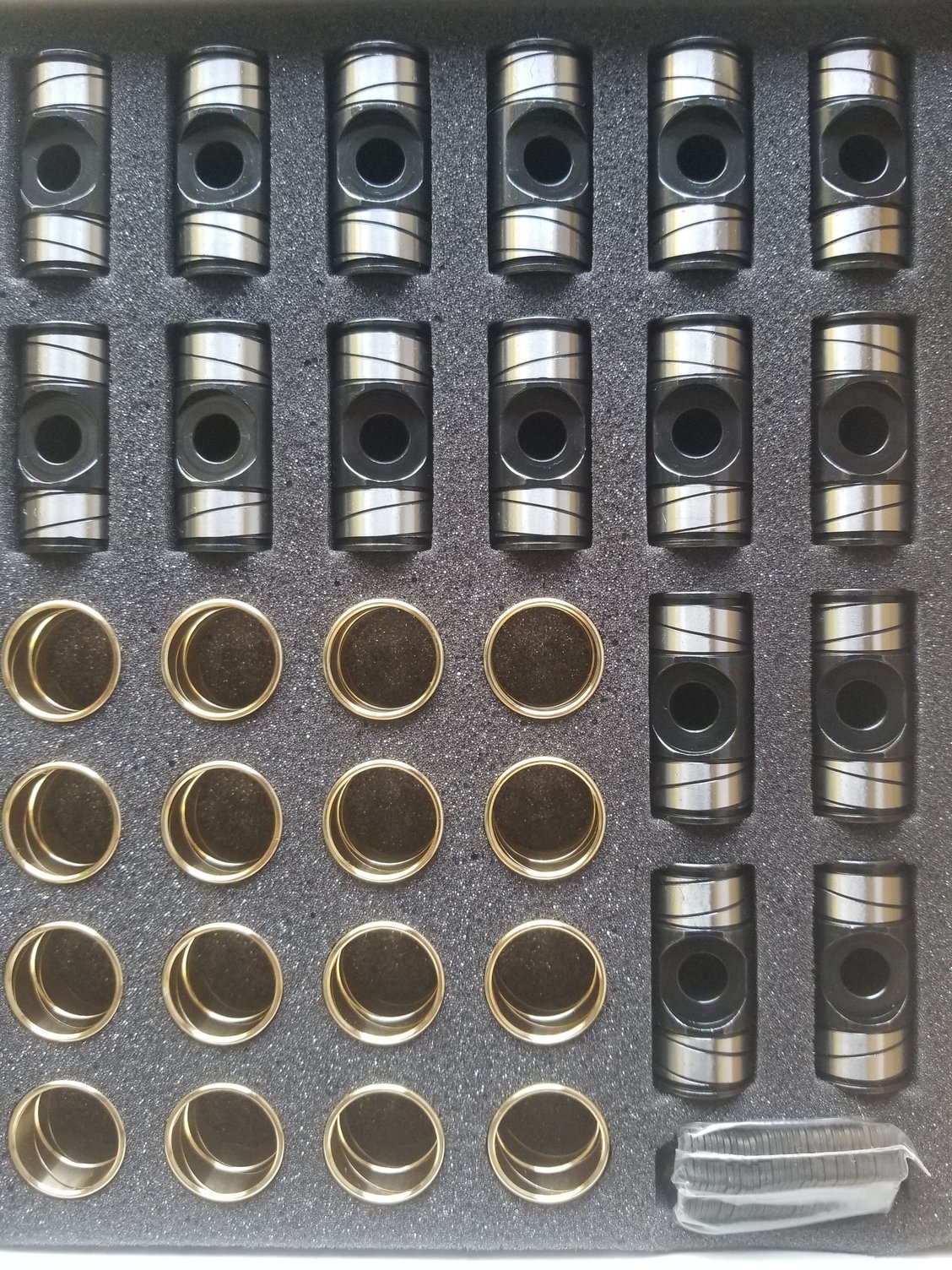

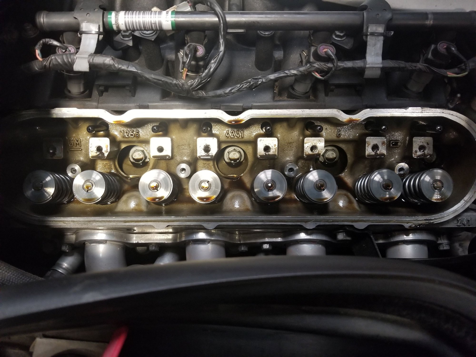

I ordered these from Scoggins Dickey and the new design is awesome and a easy install anyone that is mechanically inclined should be able to do this in about 2HRS. Once you press out your old needle bearings. Take the new trunions dip them in clean motor oil slide them into the rocker arms install the bushings on both sides with lip on bearing facing to the outside of the rocker arm and install c clips. Man I didn't think it would be that easy!

Whenever you install a high lift cam at high rpms you run the risk of the stock rocker arm bearings coming apart. Then scattering needle bearings into the heads. They usually collect in the paths of least resistance. Some times they are found left in the heads and in the oil pan. I did not want to run the risk of failure. So a little bit of insurance goes a long way. This trunion upgrade is per manufacturer for up to .660 lift up to 8500 rpms. If you have any questions about the materials they are made of call CHE in California and ask for Claude.

I think besides the material CHE, straub and BTR, are similar in design. I did however notice that the CHE had what looks to be oil channels cut into the trunions and bushings inside and on the outside between the bushing and rocker arm. I can only assume that this was done to keep everything well lubricated.

Nice video! I did notice that the straub bushings has to be pressed in and I know from the CHE design the bushings slide in perfect no pressing involved very user friendly.
