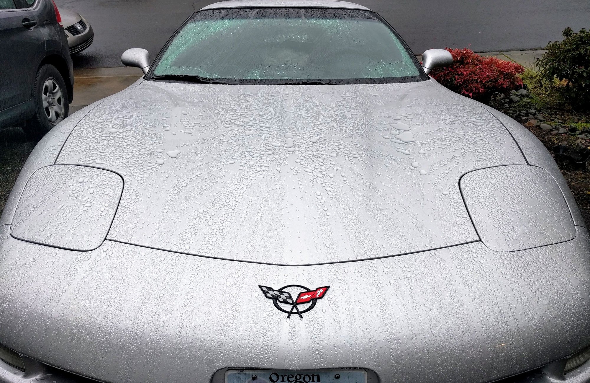

Also not sure what you mean about a busted center spoiler? I just had the nose replaced (got backed over in a parking lot).

Old May 4, 2018 | 02:54 PM

He means the center lower air dam. Big piece of black plastic with a slant to it. Feeds air directly into the rad/condenser, its basically the nozzle for the hoover vacuum that is the C5. It's got springs and is most definitely scraped up from driving. Pretty important for air flow at speed, assuming it helps the fans out too. Look under the front of your car and make sure its there, especially after recent front end body work.

Hmm, not sure I have something like that under the front, I will go look at lunch and see. Anybody got a pic of what is SHOULD look like?
Thanks for all the help on this.
<edit> found it, thanks to the repair video by Frogy, awesome.
