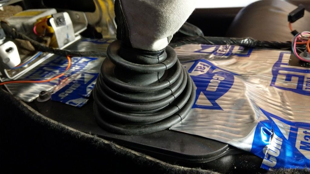

Bought a 03 C5 Z06 a month ago, with a hurst shifter installed. During the test drive before purchasing, I immediately noticed the rattle from the gear lever area - which could have caused me to walk away from the purchase. However, placing a palm over the boot reduced the noise significantly - and I decided to trust the seller that the noise was caused by the new gear lever.
As I had to repair the dim HVAC LEDs, I couldn't assemble the center console without trying to do something about the rattle. I noticed that the drive tunnel almost behaves like a chatter box, being very effective at transmitting mechanical noise. As a previous Lotus Elise owner, I know all about it... I noticed that the center section of the gear lever (fulcrum) missed sound deadening material, and came up with the idea of installing a driveshaft CV boot underneath the shifter boot, which is in denser material than the flimsy OEM shifter boot.In combination with a layer of of Fatmat (Dynamat ripoff), I'm hoping that this will help reduce the audible rattle.
Will report back after test drive!
hurst shifter cv boot fatmat

Correct. It did however quiet down other sources of noise (exhaust, road etc) and removed the high pitched part of the rattle.
The remaining rattle now seems to propagate through the gear lever to the gear **** itself.

I might do the same and replace it with a C6 Z06 shifter, but the CV boot reduced enough of the high pitched rattle so that I can live with it for a while.

The final solution:
Removed all the noise. Gears are now correcly spaced and it doesn't take an iron man to change gear.
