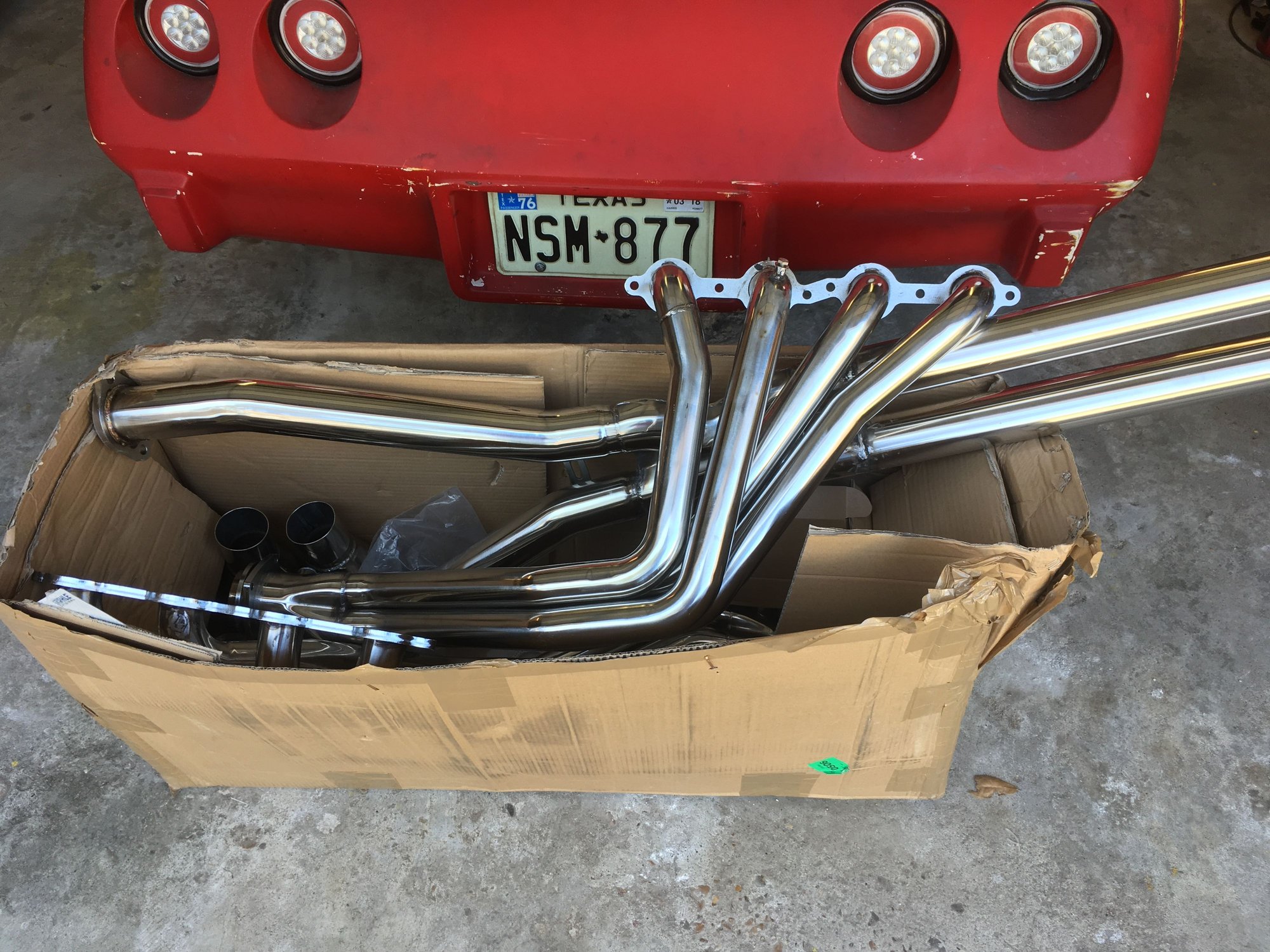

Unboxing:
I was pretty impressed with the quality when I first received them. They were not packaged well, and the box was beat up, but they had not sustained any damage outside of small scratches. Again, fine for my purposes. Using a magnet, I discovered the flanges were not stainless like the tubing was. It appears to be steel with chrome or ceramic plating. Not ideal, but these are not the parts that I need to worry about rusting out. The exhaust flange also showed daylight in the middle when I held up a straight edge. It wasn't so much warped as it was bowed in middle. This has not been an issue, as I tightened the bolts in the middle first, and it pulled the flange flat.
The exhaust flange gaskets were cheap, and the collector gasket was completely wrong. It came with a flat flange gasket, but you need a donut. 3" donut gaskets are hard to find, but finally discovered that Walker #31556 fit the bill.

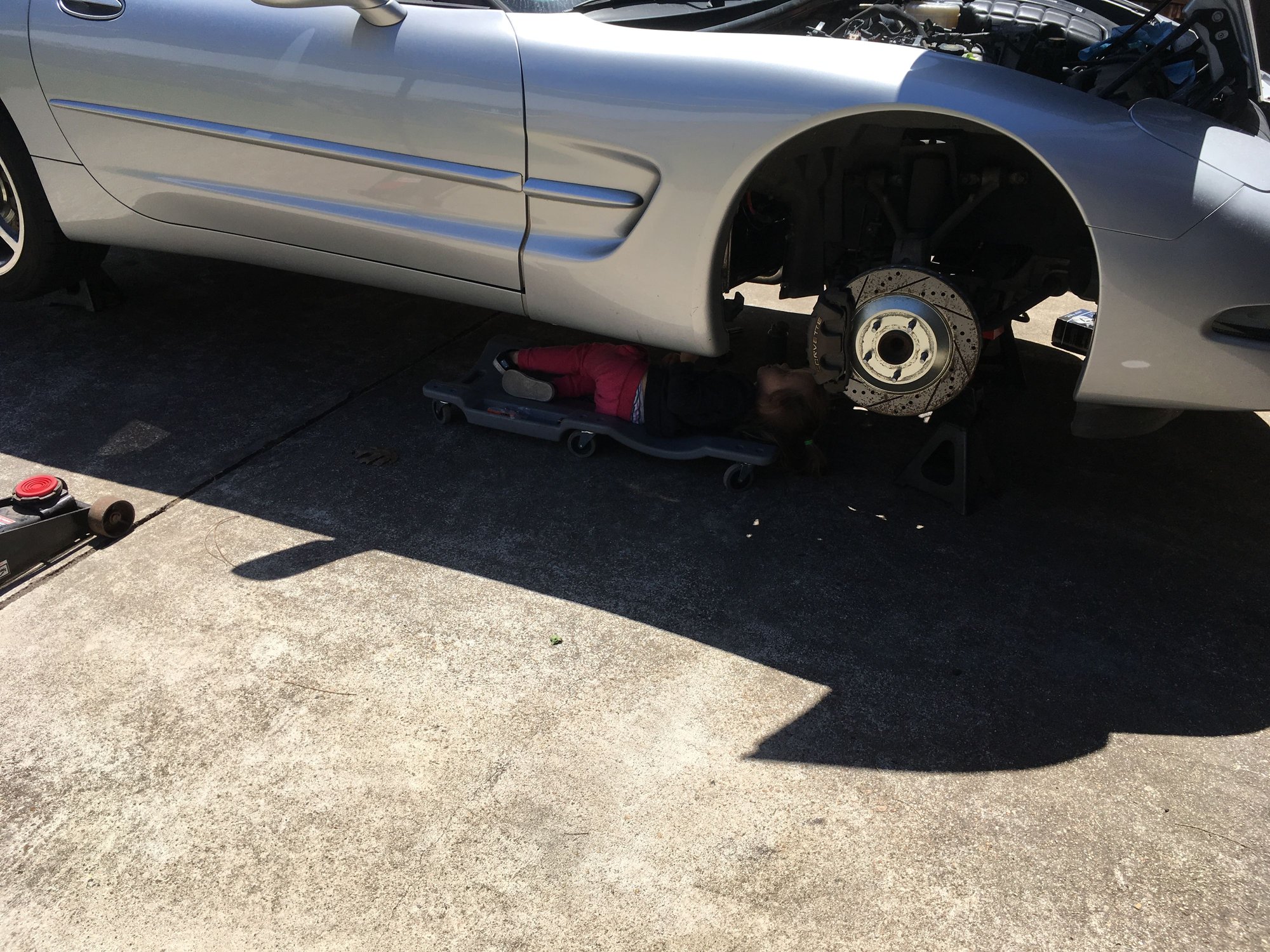

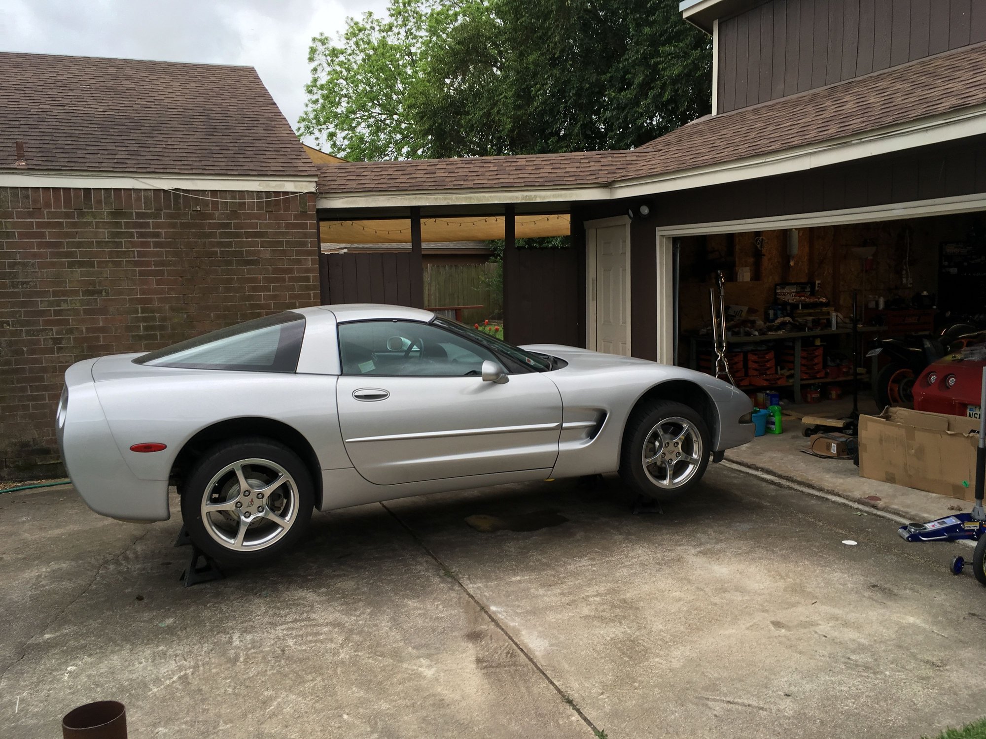

I ending up doing the install in my driveway on jack stands. Easily doable, but I would recommend a lift to anyone who has one available. The old exhaust came out easily, but did end up cutting the studs off the drivers side manifold.
From the driver's side I removed the alternator, steering shaft, and valve cover. I also had to unbolt the motor mounts and lift the engine. The passenger side I had to remove the valve cover, starter, and once again lift the engine. The tabs near the collectors kept getting hung up, and in the end not matching up to the hanger on the bell housing. In hindsight, I should had cut them off.

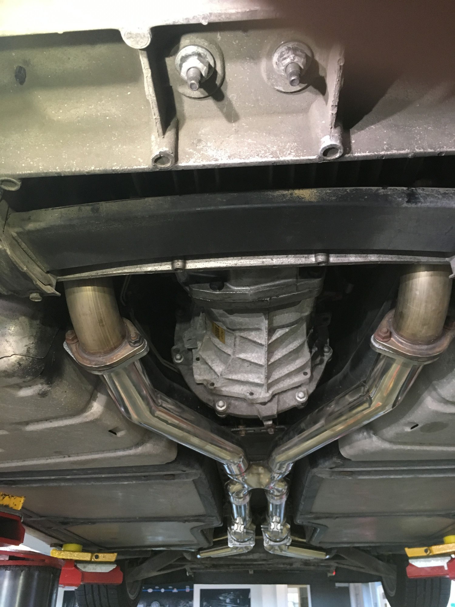

The tunnel plate had to be cut to allow clearance for the o2 sensors and their wiring. I could not figure out anyway to run the o2 extensions WITHOUT running them through the plate. Any other way would have them draped directly over the primary tubes.
The x-pipe also presented a challenge as my extensions ran parallel from the x-pipe and ended up being closer together than the collectors. My fault for welding them on beforehand.

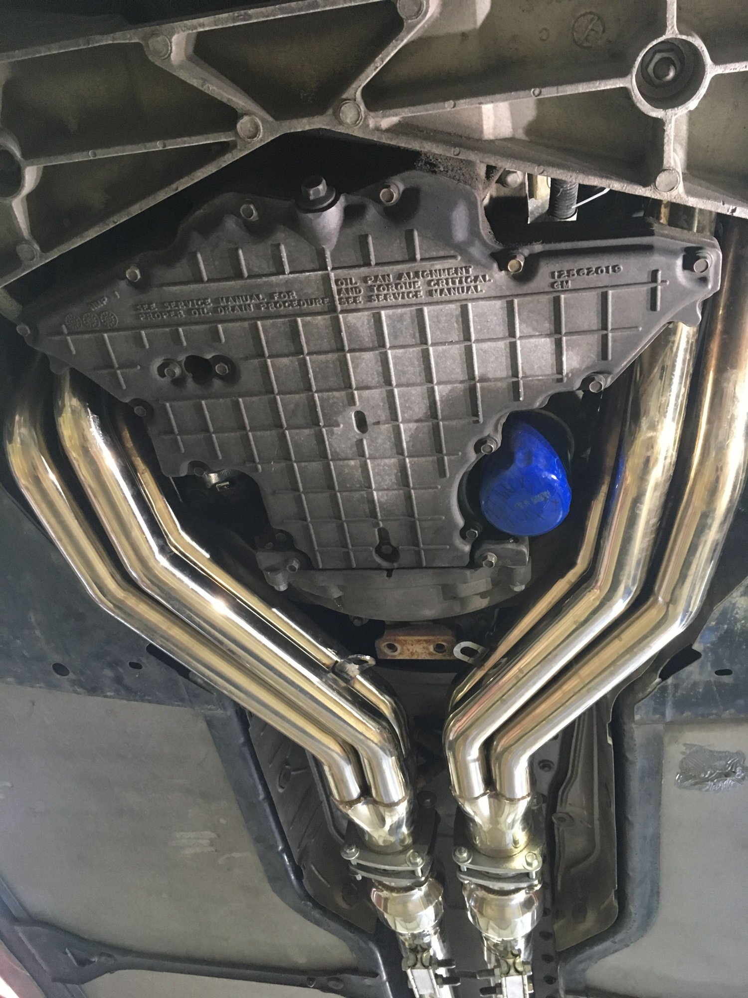

Just wanted to give an update. I've been chasing a creaking noise that started shortly after the header install. I decided to fab up a plate to connect the bellhousing exhaust hanger to the tabs on the primary tubes. If you check out the pictures above you'll see that they didnt line up and I just neglected to use them. Well it turns out that not having them connected was my problem after all.

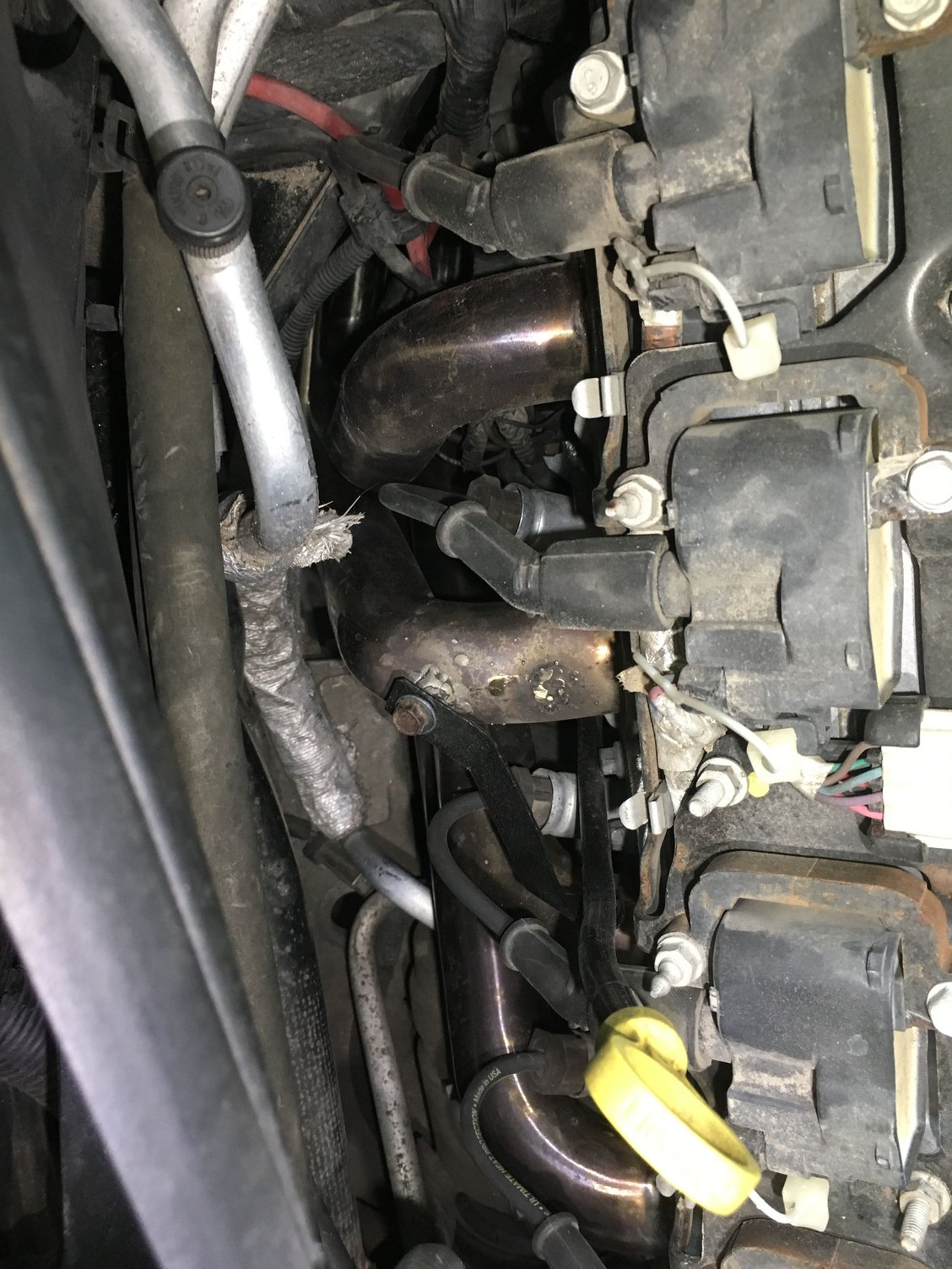

Do all the spark plug wires and bolts clear the header tubes? It looks like #5 is pretty close.
Clearance is pretty good, Cylinder 2 actually is the tightest. The rubber boot almost touches. It doesnt seem to be a problem, after all this time there is no discoloration or melting. I would probably have even more clearance with aftermarket wires

Clearance is pretty good, Cylinder 2 actually is the tightest. The rubber boot almost touches. It doesnt seem to be a problem, after all this time there is no discoloration or melting. I would probably have even more clearapnce with aftermarket wires
Got it...thanks
