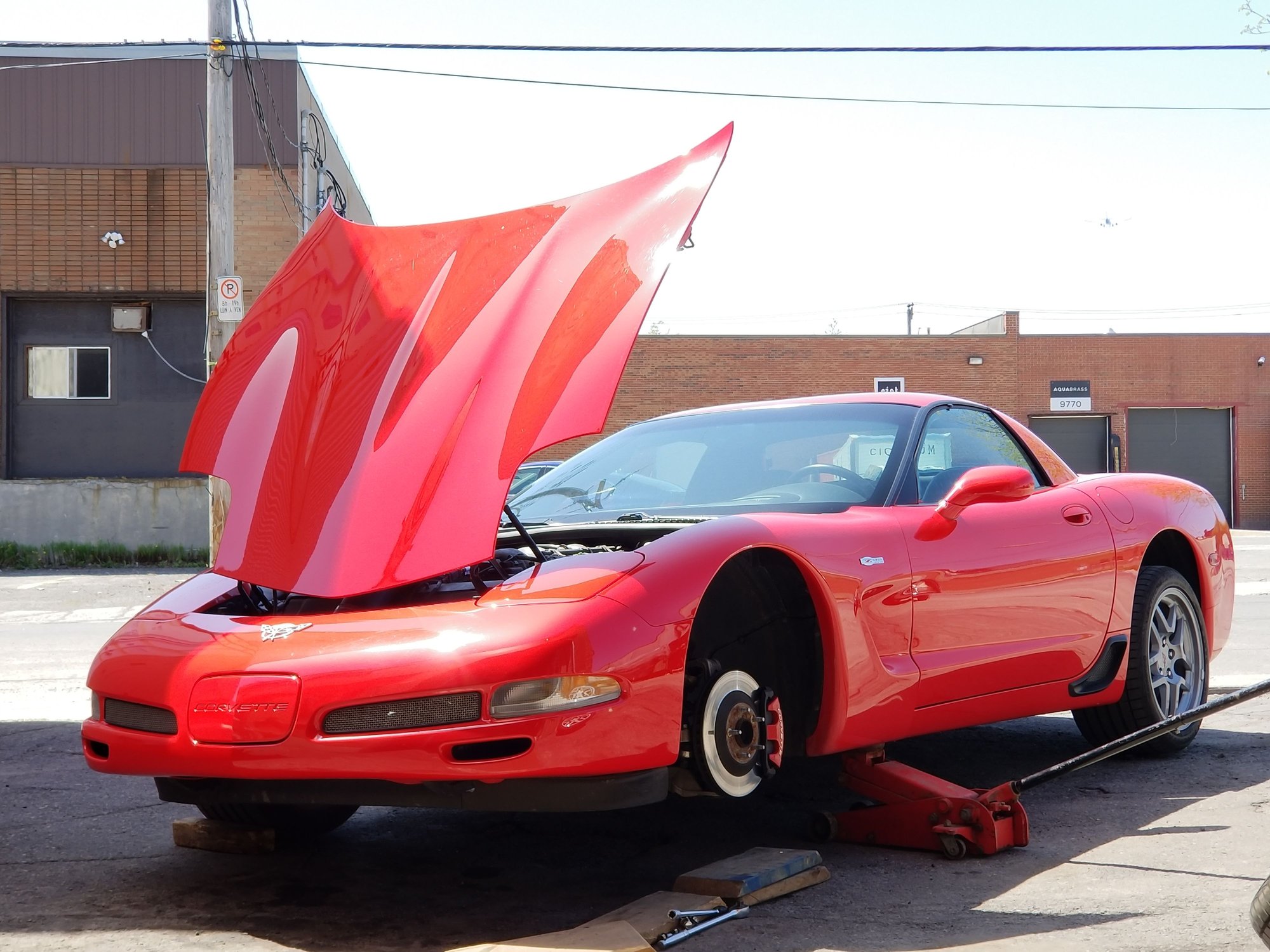

I had to abbandone Tick Master install after realizing the driver side header needs to either come off or be loosened/dropped down.
This is the first time i try to jack up the vette outdoors. I normally put it on my two post lift for all maintenance projects. I need to figure out how to get the car high enough to loosen X pipe and header while being able to fully open door.
So, if anyone is trying to replace a stock master cylinder and has long.tube headers, calculate more time than needed to do this job.
