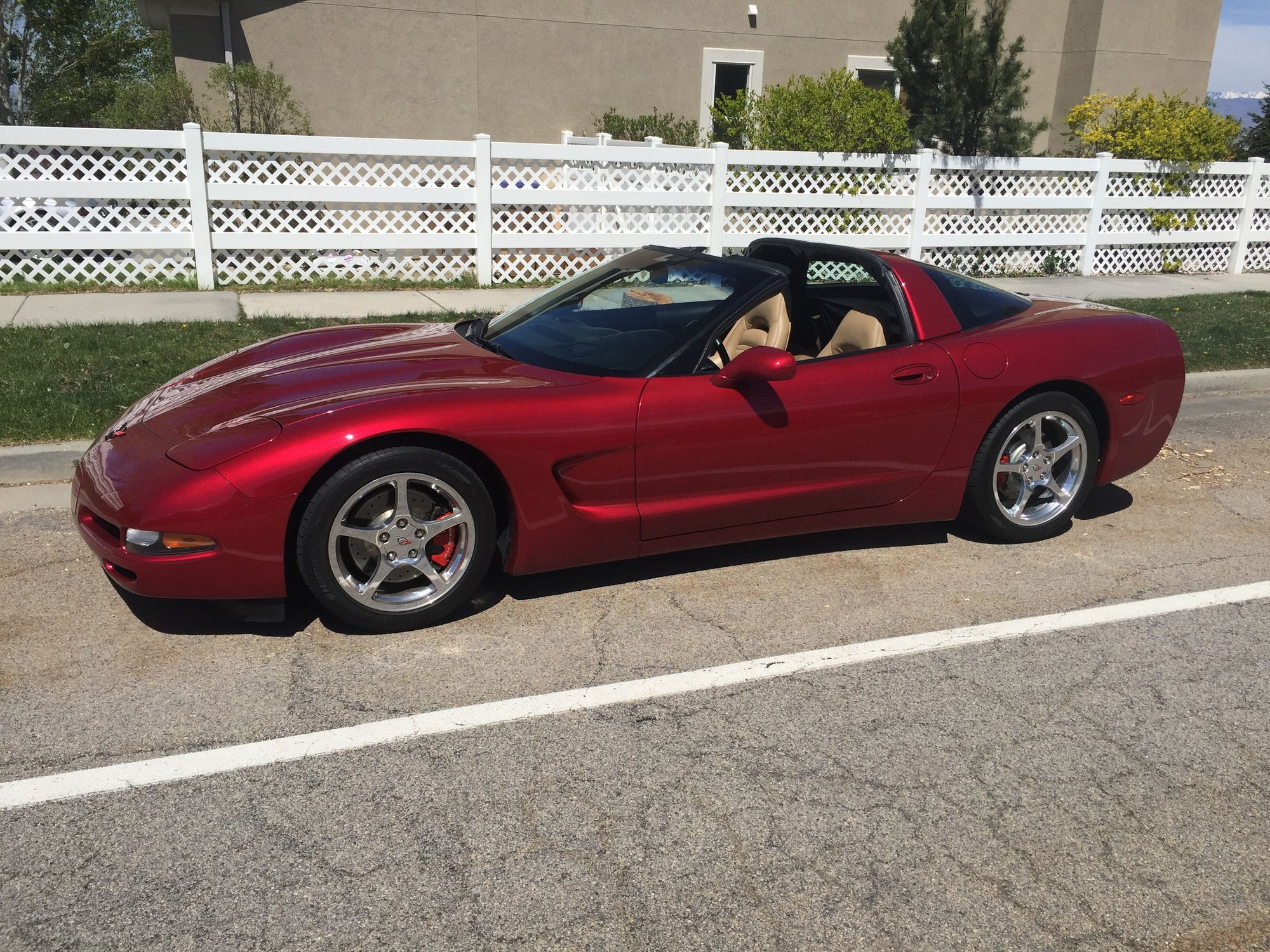

Scrapes on the front bumper and radiator support are all I can think of. You should be okay. My front bolts are bottomed out which is only about 1/4-1/2” higher than yours.

My ride height
