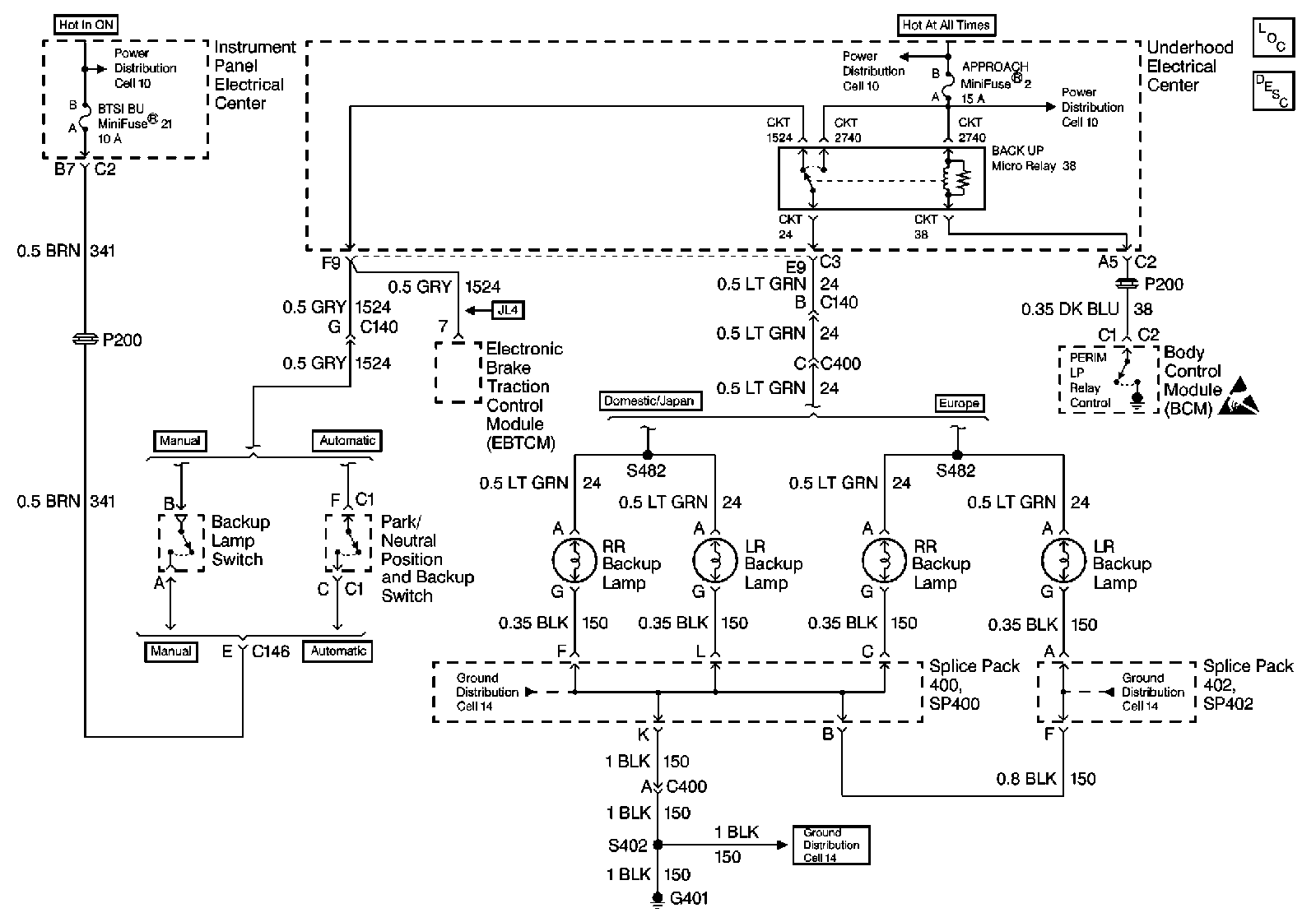

Check Fuse 21 in the passenger's floor. Since the short happened when in reverse, Fuse 21 is probably blown.
Relay 38 and Fuse 2 in the underhood panel are for the approach lights and are not involved when car is put in reverse. Check schematics:

Originally Posted by 8VETTE7
That fuse #21 in the passenger foot well fuse box is the most likely cause of your problem.
But I do not agree that relay 38 is only part of the approach lights.
Following the diagram the power from fuse #21 passes through relay 38 when that relay is in its normal position.
That is true but I wrote too fast
