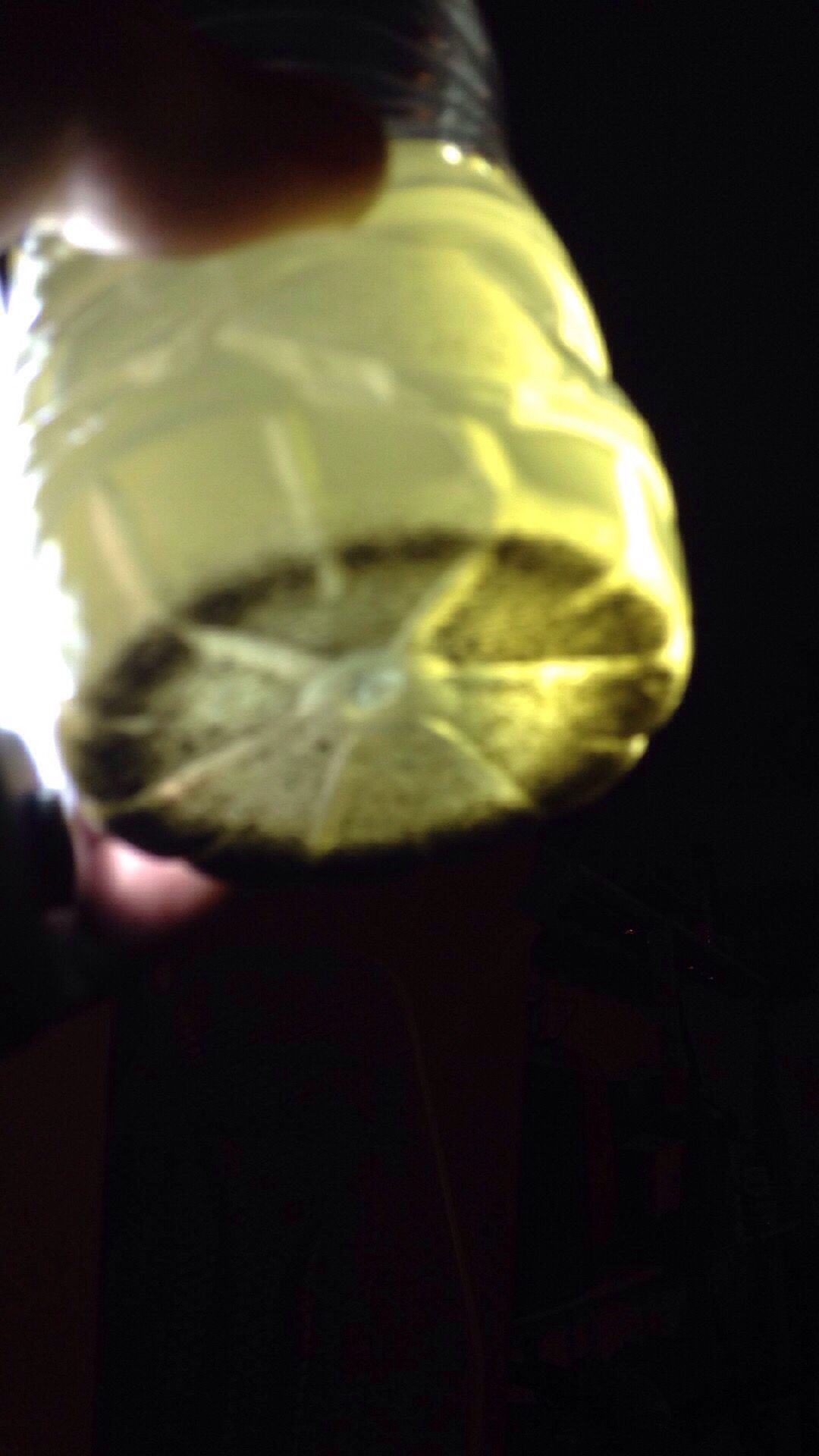

Plugged suction port, also orifice tube was plugged, will be flushing lines and evaporator coil, new condenser, compressor, drier, etc.
Old Nov 9, 2018 | 08:09 PM
1999corvettels1's Avatar
1999corvettels1
Joined: Jul 2010
Posts: 3,994
Likes: 386
From: Chandler AZ
This is flush solvent in a empty water bottle, see some crud that sunk to the bottom. It's near impossible to capture the solvent, most went all over the place and puddled under car.

Was looking up pictures in my old threads with the crud that clogged up my A/C, to show somebody asking about A/C Pro.
Searching for the pictures, I saw that I missed your question somehow, so I answered. Lol
It's cooling pretty good now.
