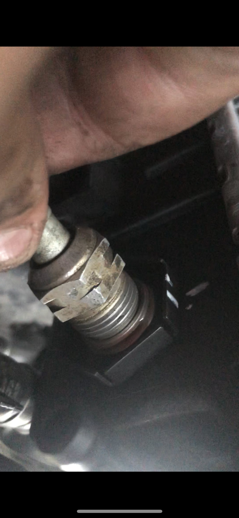

Can you post a picture of the fitting on the end of the trans line???
The trans line fittings changed around 2001. The early year cars used a flare on the end of the tube that mated to a matching flared surface in the fitting on the radiator. The later year cars use an oring on the end of the tube that fit into a matching fitting on the radiator. I believe the thread sizing on the fitting on the end of the tube also changed. BOTH screwed into the fitting on the radiator, however.
A picture of the fitting on the end of the tube would help a lot.
That’s the transmission cooler line end. See how it is not fitting into the radiator, it’s supposed to go in and tighten it. The radiator thread is smaller. I don’t think my tips are interchangeable on the trans cooler lines.

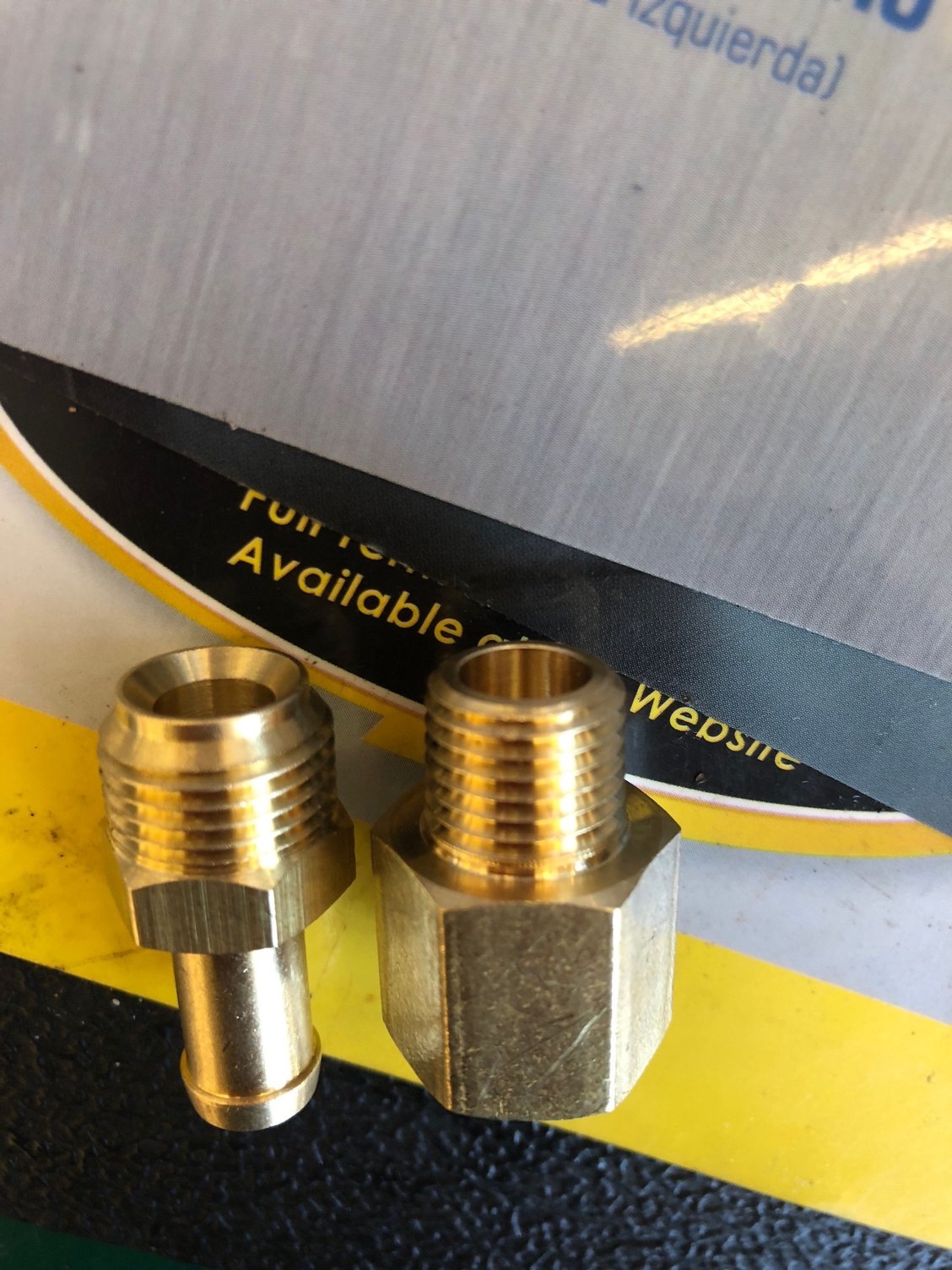

yes I do I have the old radiator I’m at autozone and oreilly trying to find an adapter so I realiZed I need a 1/4 female to 3/8 male. I found one at autozone but it’s not inverted flare or for trans cooler lines so the thread is wrong.

If that is the replacement radiator in the picture, it is NOT the correct radiator for the later year C5's.
Here is a pic of a radiator from a 98 automatic:
and here is a pic of a radiator from a 2001 automatic:
Notice the difference in the fitting part that is in the radiator between the above pictures. Also notice the difference between the fitting on the end of the line/tube. Your picture above shows the later year fitting on the end of the line/tube from the transmission. So you need a radiator for the later year automatic.
Who ever you are purchasing your replacement radiator(s) from is sending an early year replacement and that will NOT work. Furthere there are a number of threads about this same issue on this Forum and there are no "adapters" available.
Suggest that you purchase an authentic GM replacement radiator from a GM distributor or play the "keep trying to get the correct part" game from an aftermarket supplier. JMHO

So the picture has 2 fittings one on the left and the right. I found the correct fitting wel almost and that’s the one on the right. The one on the right is 1/4F to 3/8M , I need the one on the right to have the left thread. It’s invented flare thread which fits perfectly while the right doesn’t. Idk where to find it.

If the hard line from the transmission has a flare, then you need a 1/4 male pipe thread on one side for the radiator and a 3/8 female flare fitting on the other side for the line. That's fairly common at auto parts stores or plumbing stores. Flare threads ≠ pipe threads.
I'm not sure if the AC-Delco part # I gave was for flares or for the other threaded fitting that's more like a compression fitting with a rubber O-ring. Both styles were used on the C5's, I think.

I have spent ALL DAY YESTERDAY FINDING A DAM ADAPTER. So I realized the tip on 2004 corvette auto radiator transmission cooling line can be token off. The dealership told me no, they are a bunch of a**holes trying to make you buy the GM factory radiator. I took it off with this bad boy, now all I do is plug it into the aftermarket radiator and I have a new thread that came with the aftermarket radiator instead of adapting my old line.
Solved it on my own. No need for cutting it. It comes off
