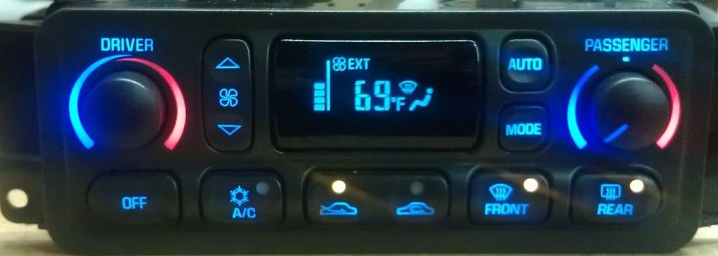

Originally Posted by gellisvette
1999 as fare as I know it has electric climate control? It has that little vent in the dash board.
First picture is Electronic, second is Manual
Old Jun 9, 2018 | 10:36 AM
gellisvette's Avatar
gellisvette
Joined: Mar 2014
Posts: 18
From: PERRYSBURG Ohio
Default Heater vent
ok it’s the top one electronic controls. By the way how do you replace the lights in that unit?

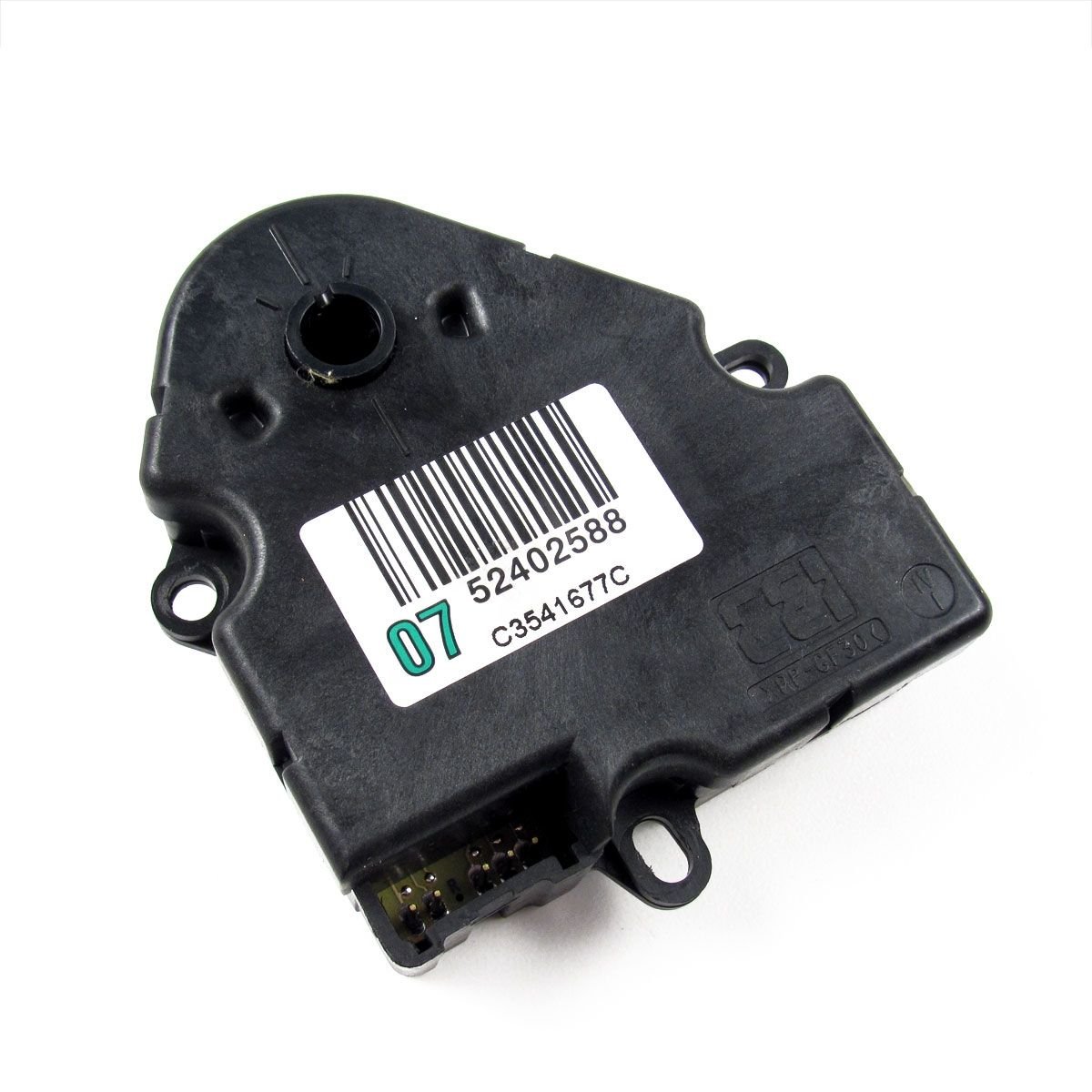

Which lights ? The one in the center that displays the temp or the surrounding bulbs?
ok did the code check found several HVAC 3 codes BO361hc,BO363h,BO441hc there you have it. I would like to know what these other codes are? Any suggestions.
From the codes listed, it's pointing to the left Blend Door Actuator.
B0361 Left Actuator Feedback Short to GND
B0363 Left Actuator Feedback Open
B0441 Left Actuator Out of Range
B0361 and B0441 are Current codes stored.
Try the reset procedure first. If it didn't do the job then it has to be replaced.
Brand: GM ACDelco
Manufacturer Part Number:89018365 15-72971
Other Part Number: 52402588 / 16163982
Placement on Vehicle: Left / Right
Or you can go with an aftermarket part:
DORMAN 604-106

ok pulled the fuse whaited a long time replaced it. Same thing same codes. What do I need to replace? The HVAC unit in the dash?
Old Jun 9, 2018 | 12:17 PM
SG Lou's Avatar
SG Lou
Joined: Dec 2010
Posts: 3,938
Likes: 498
From: Fords, NJ
ok pulled the fuse whaited a long time replaced it. Same thing same codes. What do I need to replace? The HVAC unit in the dash?[/left]
Left Blend Door Actuator
DORMAN part # 604-106
