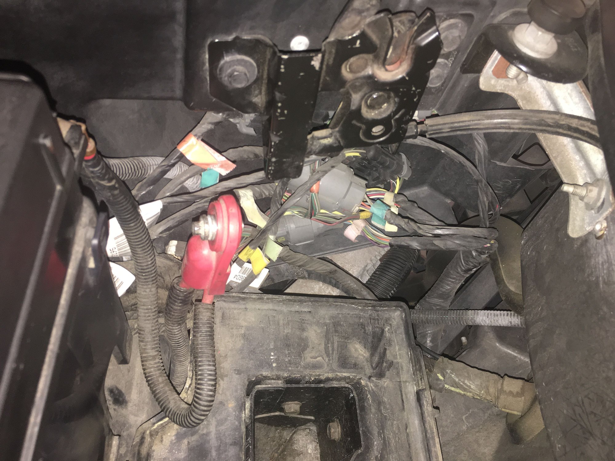

You don't want to change out fuses that aren't blown. That's kind of like changing out a working light bulb. Like johnson-rod commented, something caused your battery to discharge, maybe a pinched wire. You have to determine what caused the discharge.
Maybe posting pictures of the areas you were working might help people assist you. At this point charge up the battery, but depending on what is causing the battery to discharge, connecting the battery could be dangerous. Did a large gauge wire get pinched? If so, you could have some heavy arcing, melting, and maybe fire. Instead of connecting the positive battery terminal to the battery, you may want to connect a test light in series between the positive battery terminal and the positive battery cable. If there is a significant power draw, the light will illuminate. Perhaps googling how to use a test light for troubleshooting. Have any friends that are good with electrical troubleshooting?

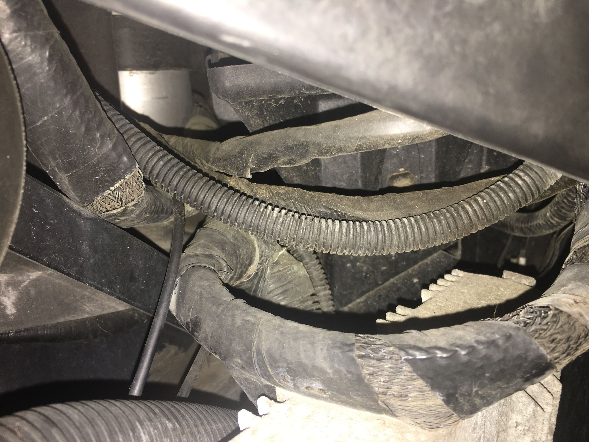

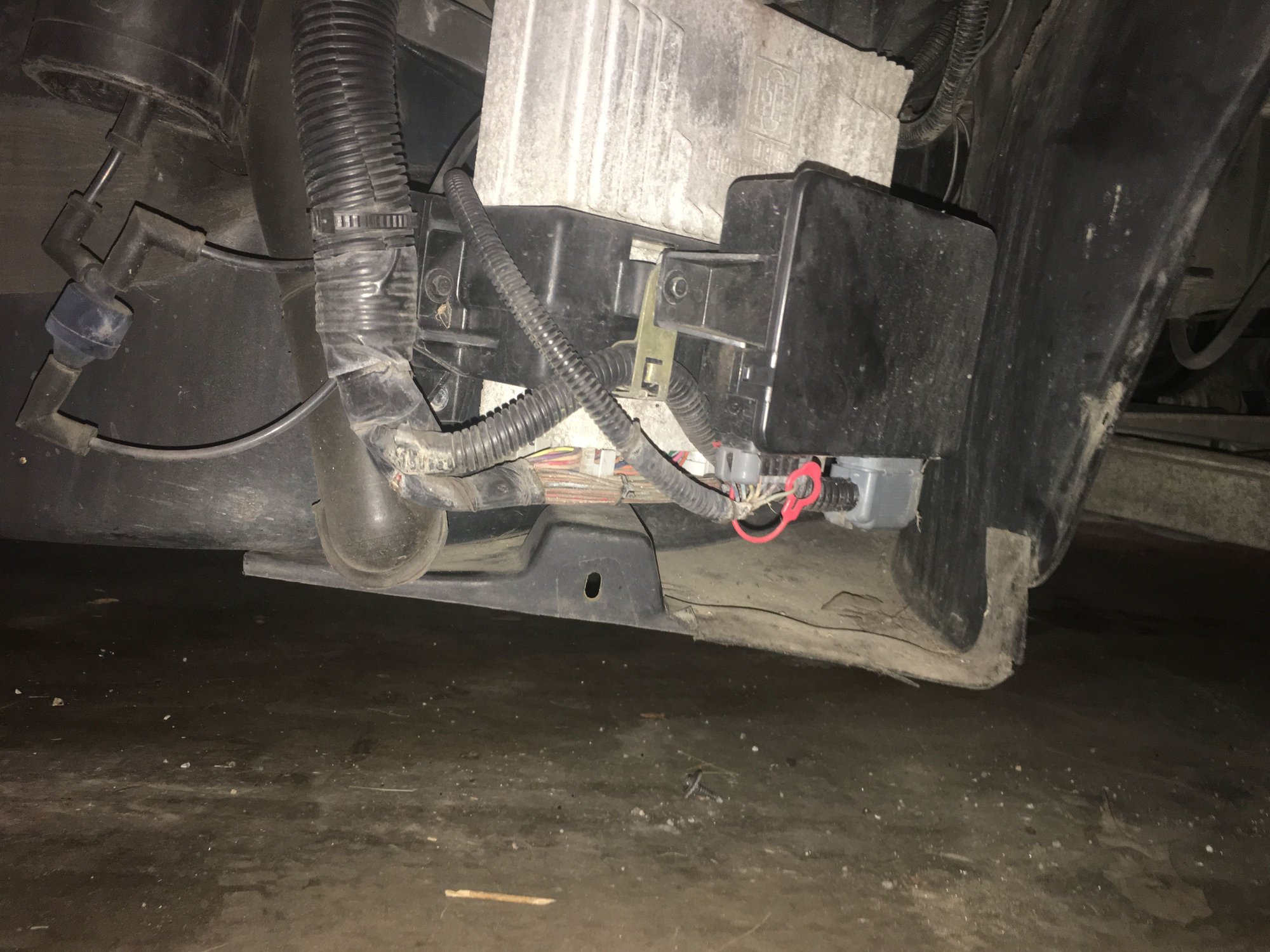

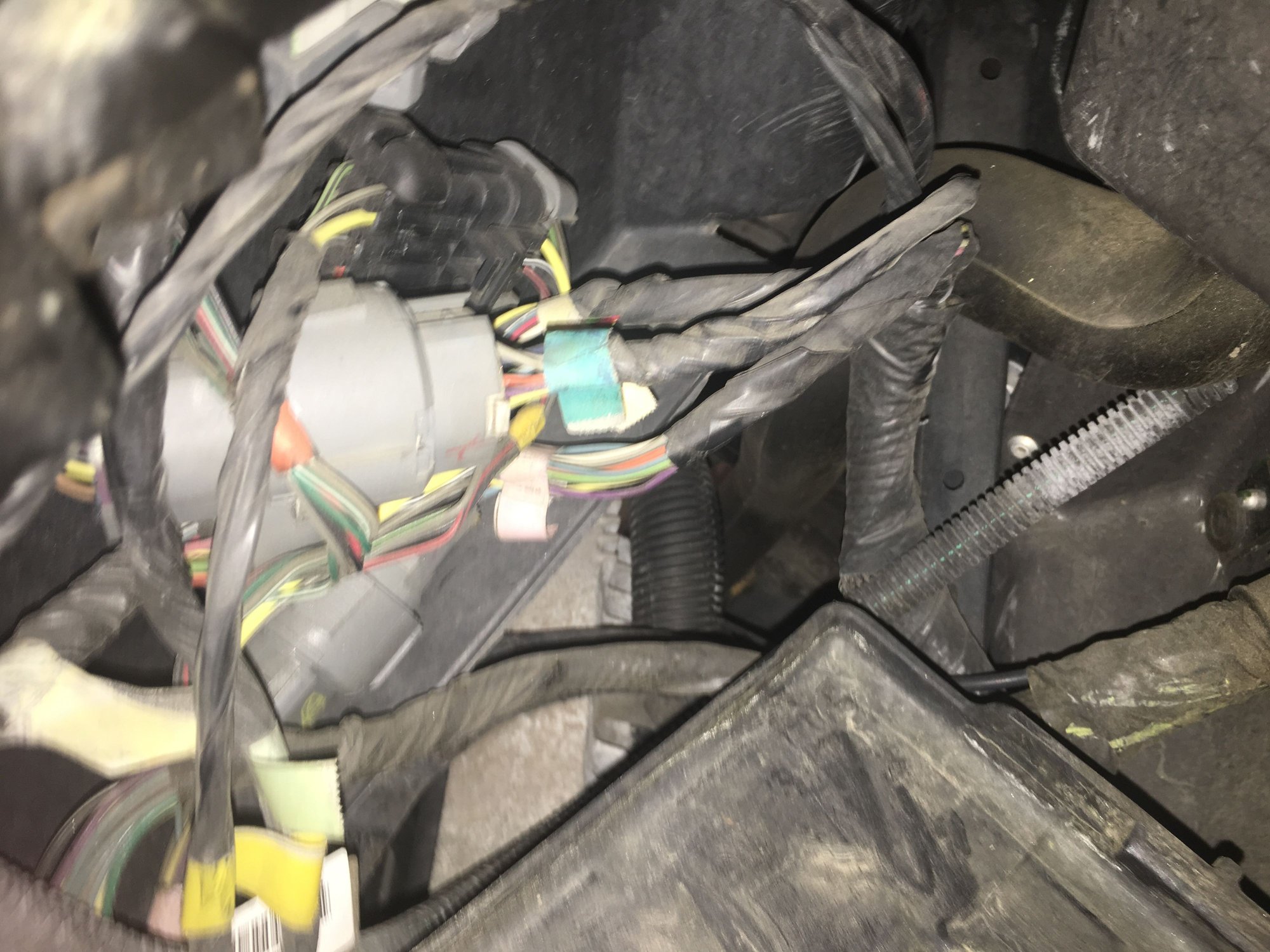

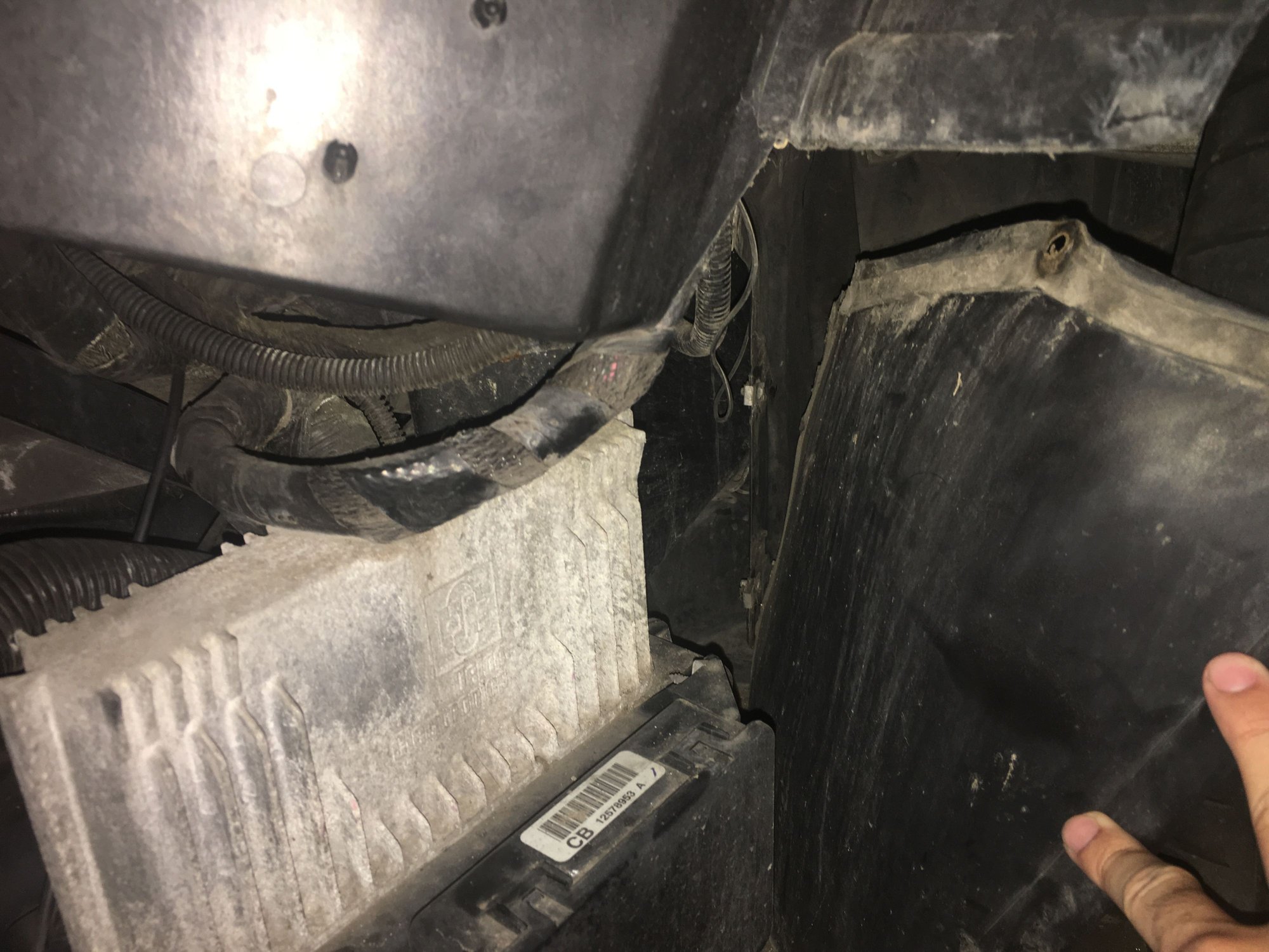

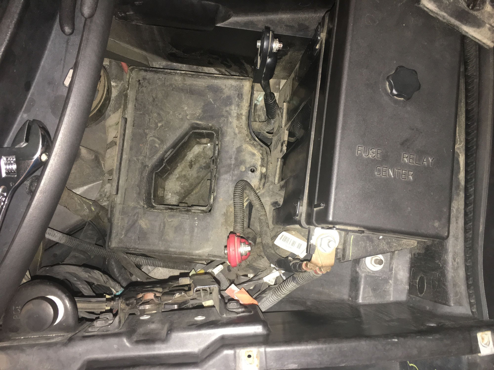

Here's pictures of the area I was working on when it happened. Passenger side, 1998, auto. Sorry if a little dirty also lol
