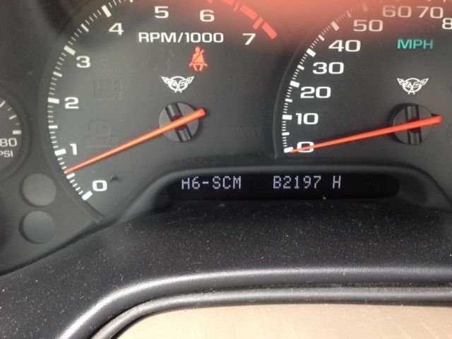

I pulled codes this morning. I think this pretty much confirms switch problem Thanks for responses and advice
B2197 Seat Reverse Switch Shorted to GND
