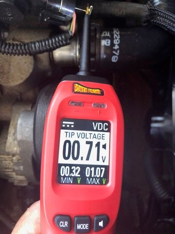

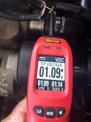

The DTC's 1220 and 1221 are causing your "reduce engine power" when either of those two DTC's set. Would have to do some digging into why the Traction Control message illuminated also.
The P1220 will set if the TP2 signal is less than .13 volts or greater than 4.87 volts for less than 1 second. P1221 will set if the TP2 disagrees with TP1 (there are 2 TP sensors within the TPS housing) by more than 7.5 %.TP1 is a "pull up" circuit and if you connect your DVOM to the dark blue wire the voltage should be less than 1 volt at idle and above 3.5 volts at WOT. TP2 is a "pull down" circuit and when you connect your DVOM to the pink wire you will be reading about 3.8 volts at idle and below 1 volt at WOT. These were the voltages readings from my 2001 back probing wires with KOEO.
White and Purple- Low Ref. - .03 volts (should be less than .1 Volts)
Yellow/Black and Green- 5 Volt Ref.- 5.01
Dark Blue- TP1 Signal - 1.09 Volts idle- 4.32 Volts WOT
Pink- TP2 Signal -3.94 Volts idle- .71 Volts WOT
Enclosed is pictures of the TPS Sensor 1 and 2 signal voltage at idle and WOT

Well what if it were a wiring problem ??...you can change 100 sensors and it still would not work...right ??....it's always not a bad part !!...the test only takes 15 minutes but you will KNOW that the wiring integrity is OK.
I'm sure you have a multimeter so the first thing is get some t-pins like the ones I'm using in the pictures. I got mine in a box of 50 from Amazon years ago but you can probably find them maybe in Staples or a Michael's...or if you have a thin thin paperclip and unbend it that will work. Just go straight in with the clip until you feel it hit the back of the pin....With key ON and engine OFF you should have:
1) white and purple are low ref. grounds-- should be less than .1 volt
2) yellow/black -- 5 volts ref. and the dark green -- 5 volt ref.
3) dark blue-TPS 1 signal-- less than 1 volt at idle and above 3.5 volts at WOT (pedal to the metal)
4) pink wire TPS 2 signal) -- about 3.8 volts at idle and below 1 volt at WOT (pedal to the metal)
Let me know if you have any issues. I did a video with my Labscope doing a "TPS Sweep" a few days ago and will post it here...not the best video, I was using my iPhone....and this is the BEST way to see what the Sensor is doing...a voltmeter can't pick up any drop outs that would affect the TPS's operation !!
