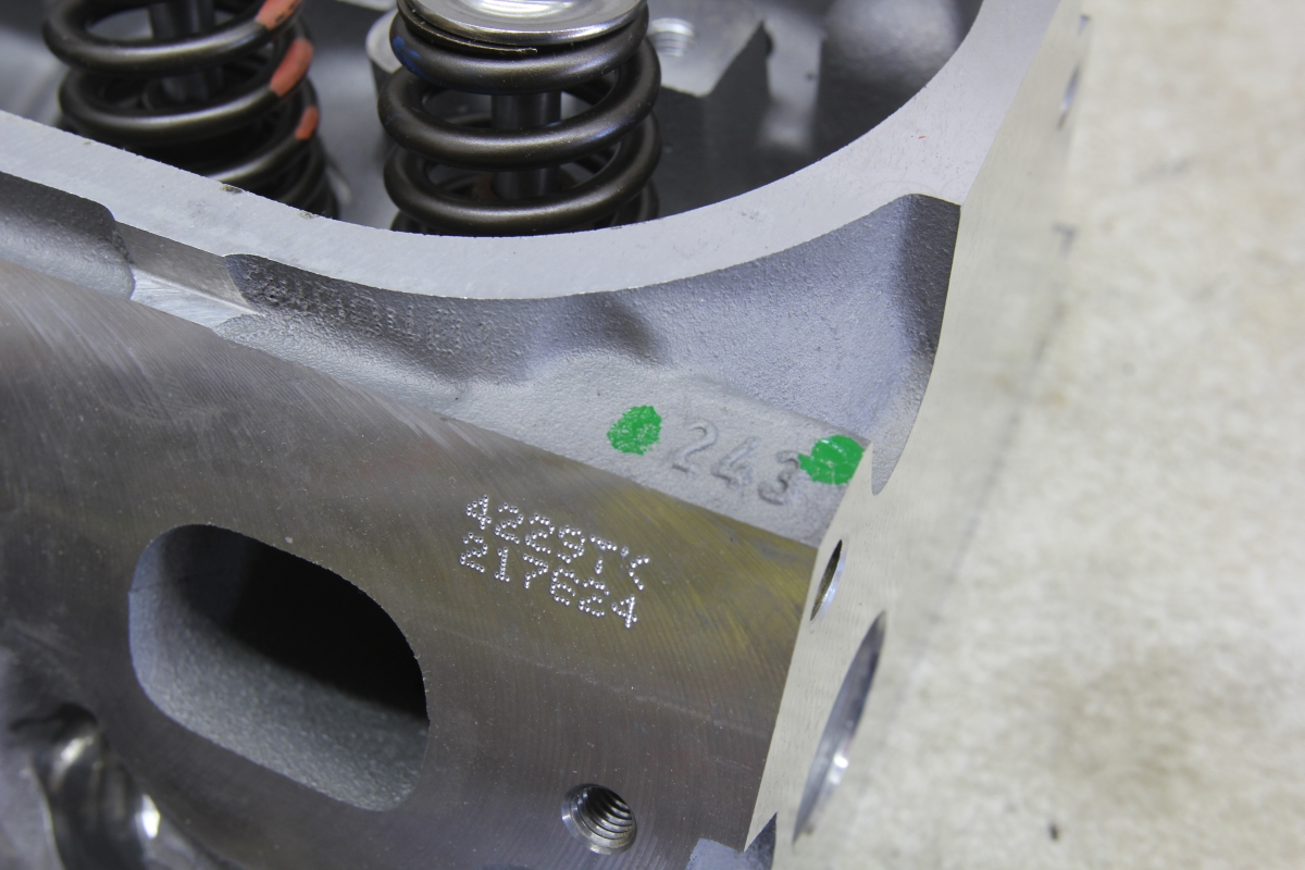

Is there a marking at the front of the head visible with the valve cover on like the 243 on this:

853 would be correct for a 2000...but I still don't think those ever came with yellow springs.
Here is what I think...someone who had that car had a friend with a Z06 and that friend did an upgrade on cam and springs. He gave his old cam and springs to his the previous owner who installed them in your car. There is really no way to know for sure without pulling the cam.
Regardless, those springs are no good and you should change them all...the question becomes what to put in. My amateur recommendation is the factory blues.

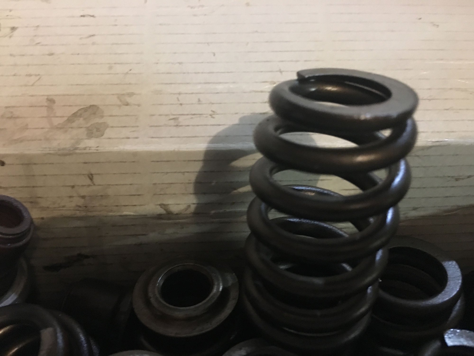

Originally Posted by 8VETTE7
From the picture below that looks like the front of the drivers side head. If that is correct then the spring that is broken is the exhaust valve spring on cylinder 1 and not a spring on cylinder 2.
sorry I mean cylinder 3 my bad it’s next to 1. Causing a misfire because the valve in 3 wasn’t working right.I was just so excited to find it...mind went blank !

The order goes in odd numbers 1,3,5,7 in this case it was cylinder 3 spring not cylinder 1. The spring snapped I believe the 3rd coil down it looks at the top only by that picture.

Of the 3 valve springs shown in the picture. The center one snapped.
