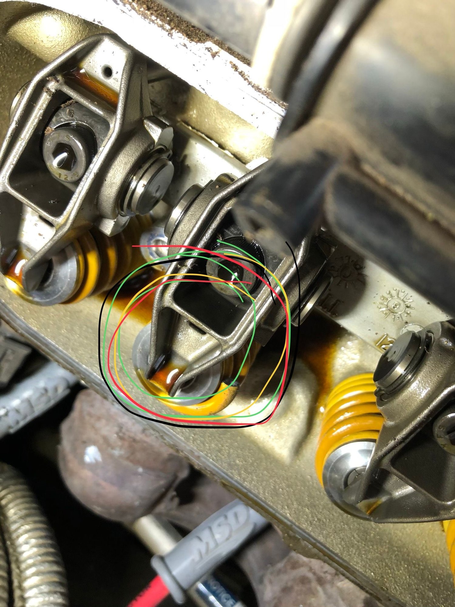

So I found a broken spring on cylinder 3 yesterday. I was wondering how I would need to go about getting the one spring off and replace it with a new one.

LS spring compressor, tools to remove rocker, a method of holding up the spring- google it there's a couple different ways, compressed air, stuffing the chamber with rope etc. I would do them all
