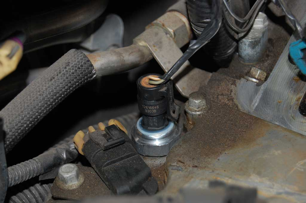

I wonder about the sensor...its in a bad position and is often damaged working on top of the motor...

Originally Posted by Speedy007
Which sensor on top of the motor ? I think the oil pressure switch is at the back of these ones ?
It is at the back...here is a pic of it with the intake removed:
I know your intake didn't have to come off for the spring change, but the wire is routed by the valve spring covers and is very easy to damage.

Got the switch out and replace runs like it’s in top shape. All codes off in pcm. Tools used long pliers not much help. 1-24 inch screwdriver to break the bottom of the old sensor. Socket 1-1/16 deep well half inch with a long 8 inch 3/8 extension. Adapter to 1/2 inch and 3/8 swivel. The issue was getting the old out after it’s unscrewed, it’s a tight fit for any hand or pliers I would recommend using a 14-16 in needle nose to get it for future people.
