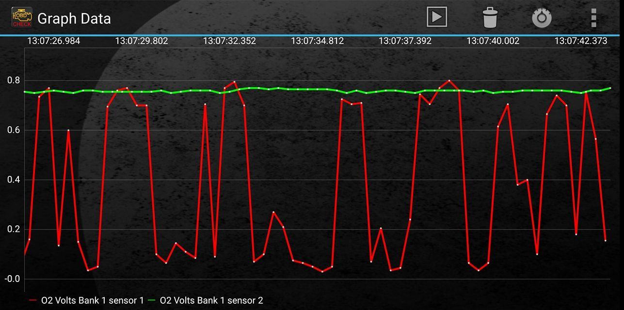

Well today I was watching my 02 sensors on the Torque Pro graph and I noticed two jumping around like crazy. Bank 1 Sensor 1 and Bank 2 Sensor 1.
Check engine light isnt on but it does work because it came on one before.
Did I maybe get a defective 02 sensor from the store? The rears are not that important because Florida doesn't care about emissions and I read anything past the cats wont affect engine performance.
Thanks for any help.

Code p1153 is for bank 2 sensor one and the graph that you posted is for bank 1 sensor one. It looks fine by the way.

Ok so those graph lines don't have to be similar to one another? That's what I was worried about.

No. The graphs that you posted are for one side (bank 1 in your case). Front sensors should be in constant motion from about .100 to .900 volts
Rear sensors should remain nearly flat. If a front and rear sensors mimic each other on the same side the PCM will assume a failed cat. Bank 1 looks fine on your car. Rear readings are a little high but that maybe caused by many factors.

Ooohh no I see I had it wrong in my head what side was what and what sensor was located where. I pulled over to google it and then I pulled up the app and since the app grouped them the way it did it threw me off. Everything does look in order then. I really appreciate the feedback and clarification.

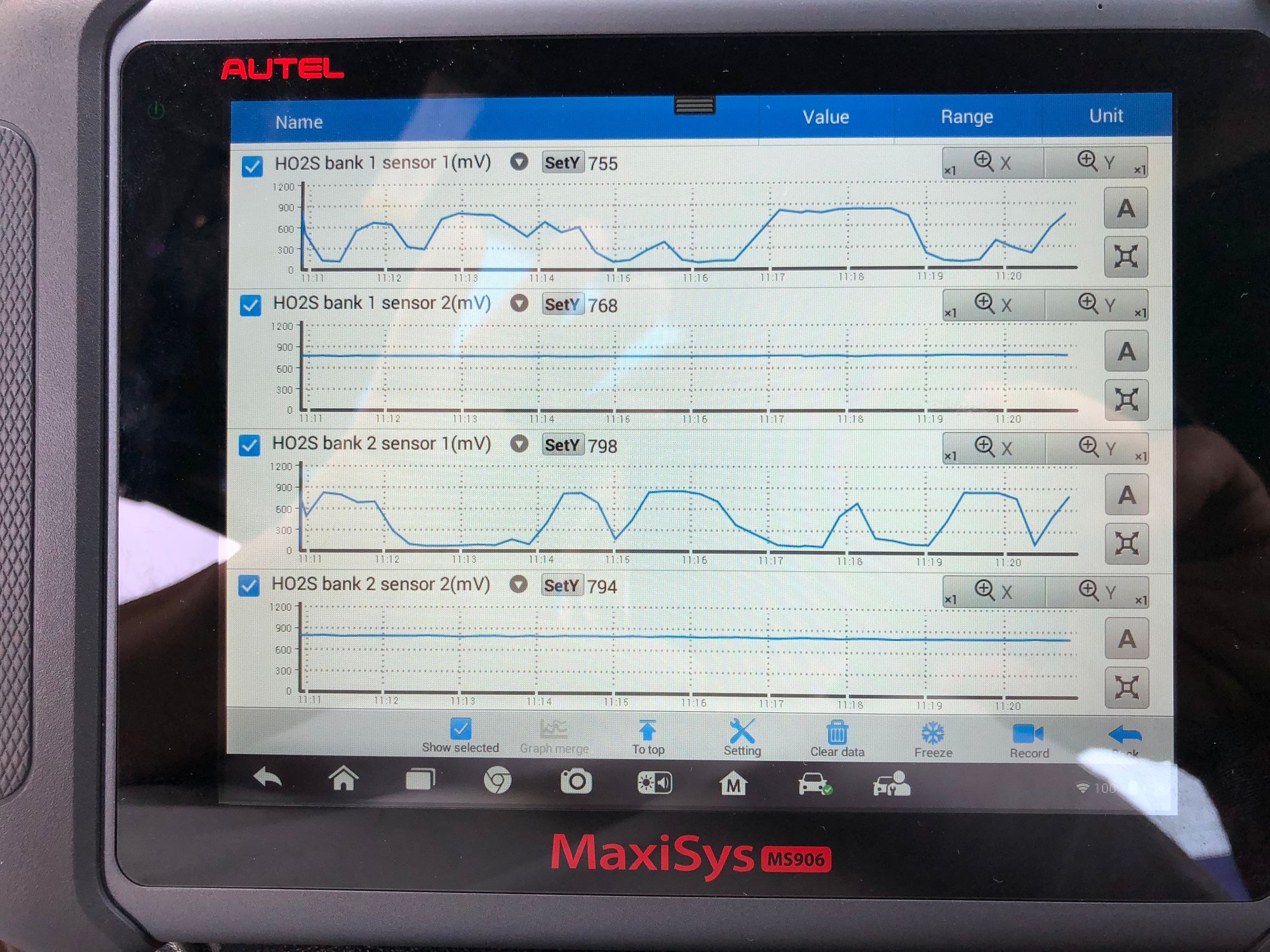

Looks fine !!...switching ok !!...these are mine !!
