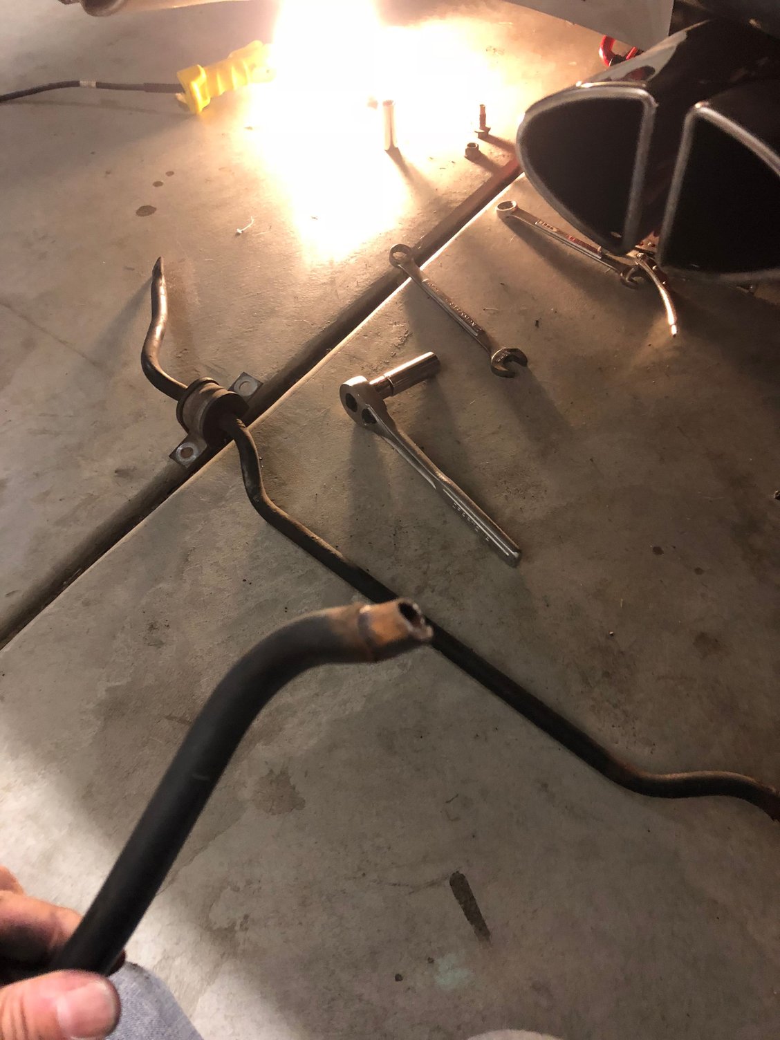

BUT FIRST, I'll be replacing a freaking rear sway bar that randomly "popped" on the exit ramp. SMH
Smoken1 , I'll be going with an aftermarket replacement, lol

I have a stock rear sway that you can have if you will pay for shipping. It is in really good condition. I removed it to upgrade to the C6 bars. Let me know if you want it.

Super cool of you to offer; thank you. Unfortunately, I had already ordered one from Summit by the time I read this post.
