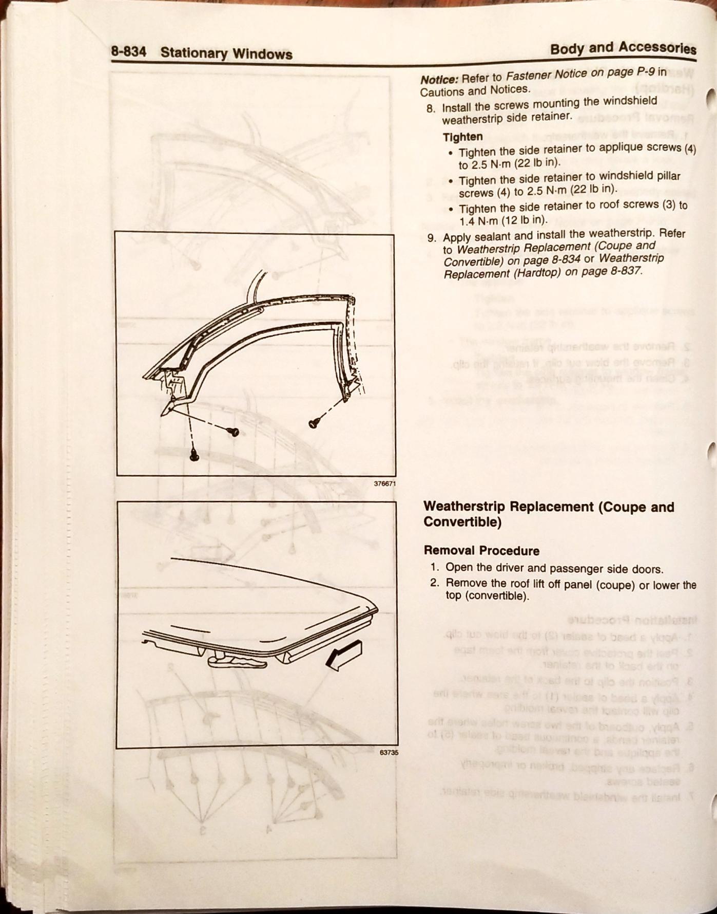

Here are some shots out of the FSM on how to remove the channel.

The weatherstripping and the window channel were glued together by the PO I assume. Should I strip these two completely then re apply the weatherstripping OR just reseal them together with a little bit of new windshield urethane?

If you change weather stripping make sure you keep the blow out clips as they aren't available any more. I had the windshield in my C5Z replaced in 2007 which ended up ruining the weather strip when they replaced it they didn't carry over the blow out clips from the old weather strip. Car was only 4 years old and the clips were no longer available.

The car was missing a blow out clip that why I'm doing this right now. My issue is do I I need to completely disassemble the retainer and rain channel preced and glue them back together?
