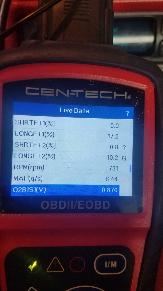

Old Aug 1, 2018 | 05:27 PM
robert1989's Avatar
robert1989
Joined: Nov 2011
Posts: 181
From: Franklin Square NY
Originally Posted by rwobs777
i guess wait till everything is buttoned up....takes awhile for those fuel trims to come back down...don’t know if your scanner has a fuel trim reset function.
Old Aug 2, 2018 | 08:01 AM
C5 Diag's Avatar
C5 Diag
Moderator, Tech Contributor
Posts: 15,604
Likes: 4,060
From: Cape Coral, Florida
Originally Posted by robert1989
Hey !!...so these snapshots are with the tuned PCM and MAF all hooked up and driving the car for a bit ??...Bank 1 looks a little lean at idle and Bank 2 has a total fuel trim of +11 but lets look at these numbers after a day or 2 of driving if you haven't done so yet !!...a nice drive to Jones Beach a few times would be in order...LOL !!
