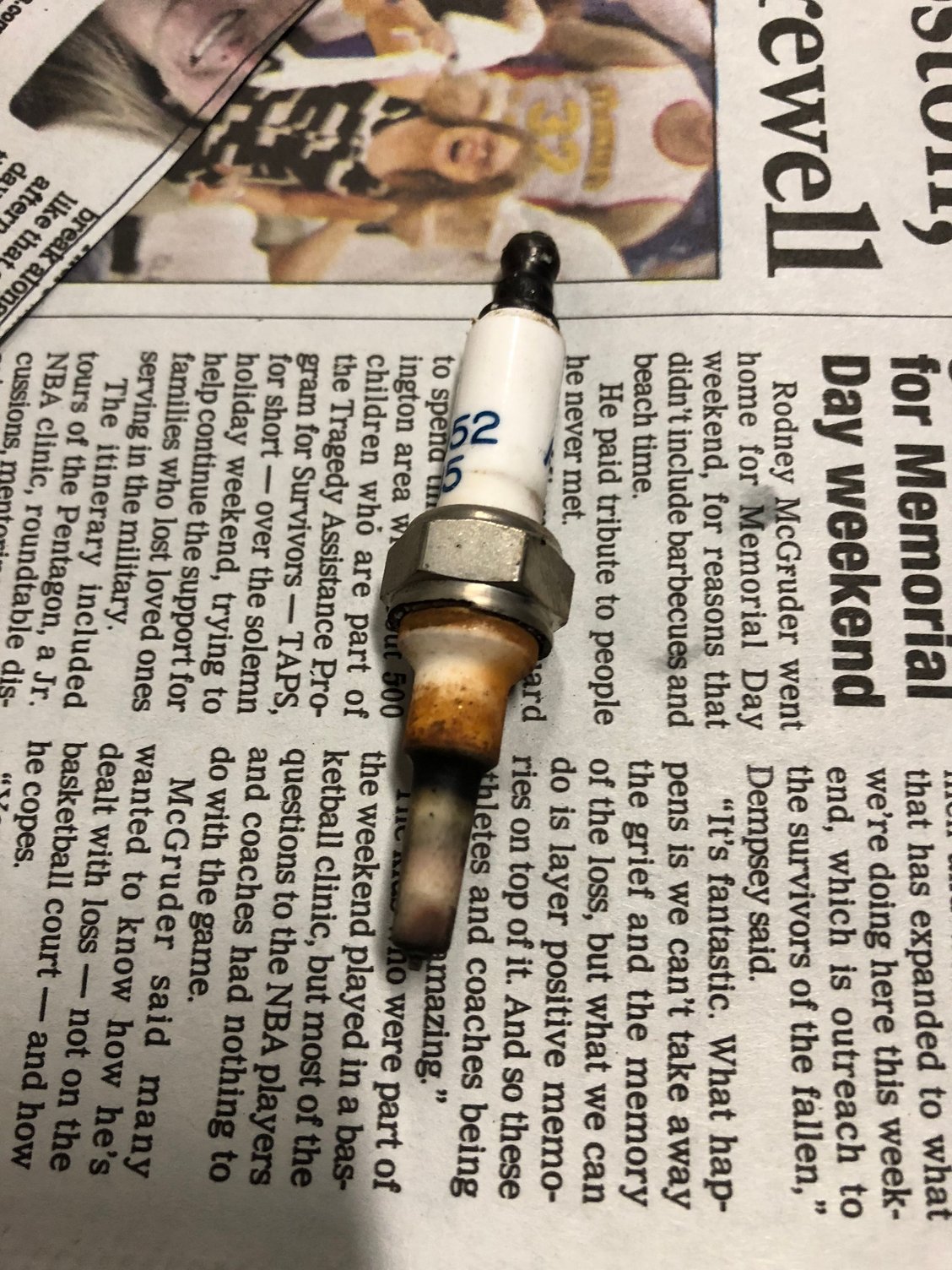

Have a 99 with 52k miles. Still had the original plugs/wires so I decided to replace. While pulling one of the plugs the threads decided to stay in the head. I was not even use very much force when it broke and I was using a socket made just for plugs. I have read a couple of things that I can purchase some type of extractor and try to back out the threads. I am not a mechanic and am nervous that I might do more damage with the aluminium heads if I do not do this correctly. Need advise on how difficult this is or should I just call in a professional? Also, does anyone have the name of a quality extractor? I have only seen a few and do not want to purchase a cheap/poor quality if I decide to give this a whirl. Thanks!!

Is that an OEM PLUG????? Man,,,,,,,,,,,,, Ive never seen an OEM Delco plug do that. Record and post the noise for a better assist.
BC
After seeing this one this would be about my 40th time. 10 on a LS1 TA's with over 200k miles on original plugs (mainly #8). People hate to change #8 so they leave it and change the others. The others on normal GM cars that over heat a lot and people never changed the plugs.

The older style CHAMPION Spark plugs were WELL KNOWN to break just like that. I thought it was the end of the world when it happened to my 72 Nova. Just like the OP, I was very worried until I was guided in the correct direction and found the correct extractor.
