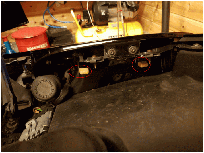

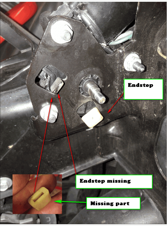

Also the bump stops that cause the motor to stop on close may be missing or damaged. The headlight control module (HCM) uses a current sensing circuit to determine when the headlights are opened or closed. When the headlight assembly contacts the bump stops the current in the circuit rises telling the HCM to shut off power to the headlight motor. If the bump stops are damaged or missing the motor may close the doors past the normal stop point and jam the gear so that when you turn the lights on the current in the circuit rises immediately and the HCM mistakenly thinks the doors are already open and against the open bump stops and shuts off power BEFORE the doors ever actually open. You can test this out by turning the manual control **** on the passenger headlight counter clock wise a bit and then try the switch will open the doors.
Here is some info on the bump stops:
https://www.corvetteforum.com/forums...ght-shake.html
Damaged bump stop
https://cimg2.ibsrv.net/gimg/www.corvetteforum.com-vbulletin/2000x1504/80-headlight_187c481b7ff3348b76bd0f289856d9 80fd5629b7.jpg
Missing close bump stop
Open bump stops
