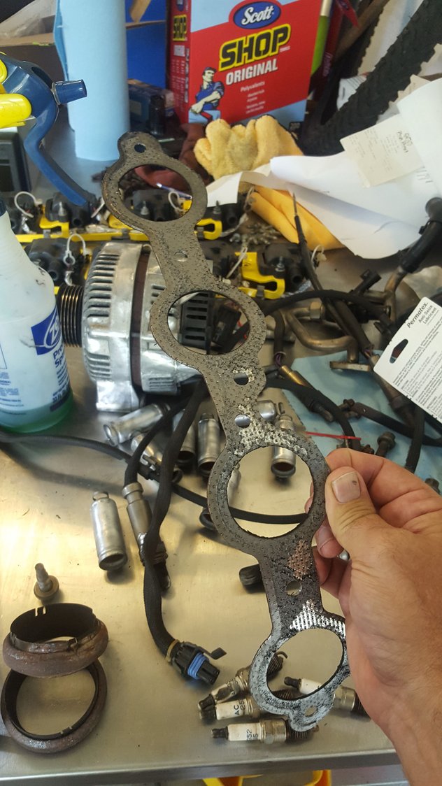

I had composite gaskets. I guess my car has a story, but I don't know it.

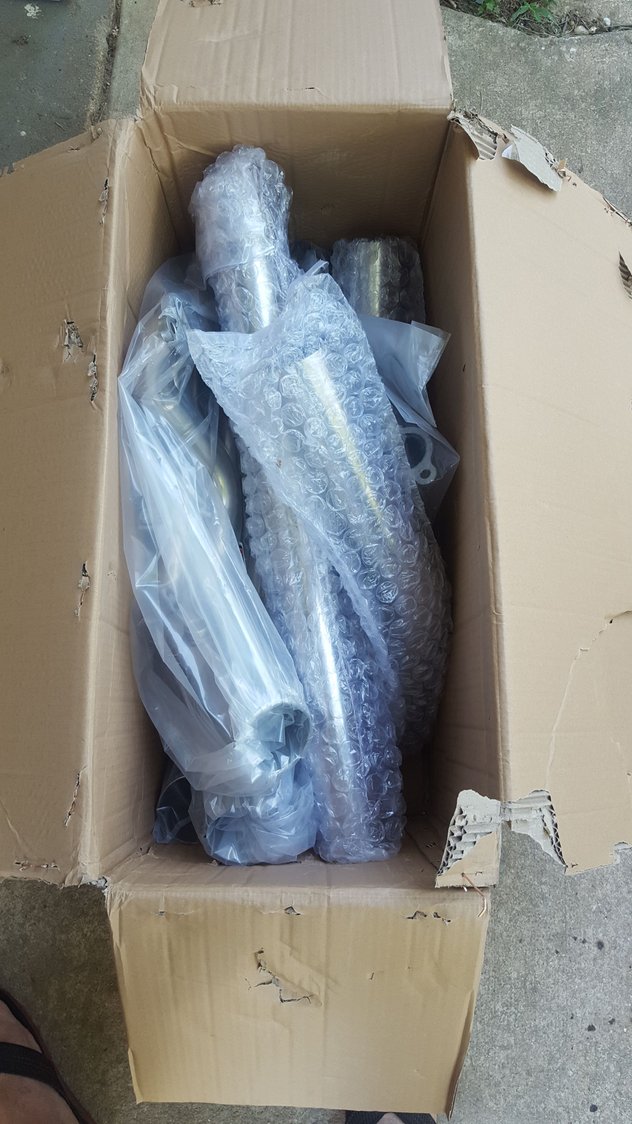

The new Headers arrived packaged well.

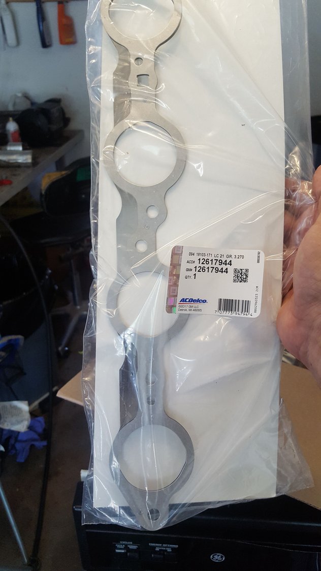

New MLS AC Delco gaskets

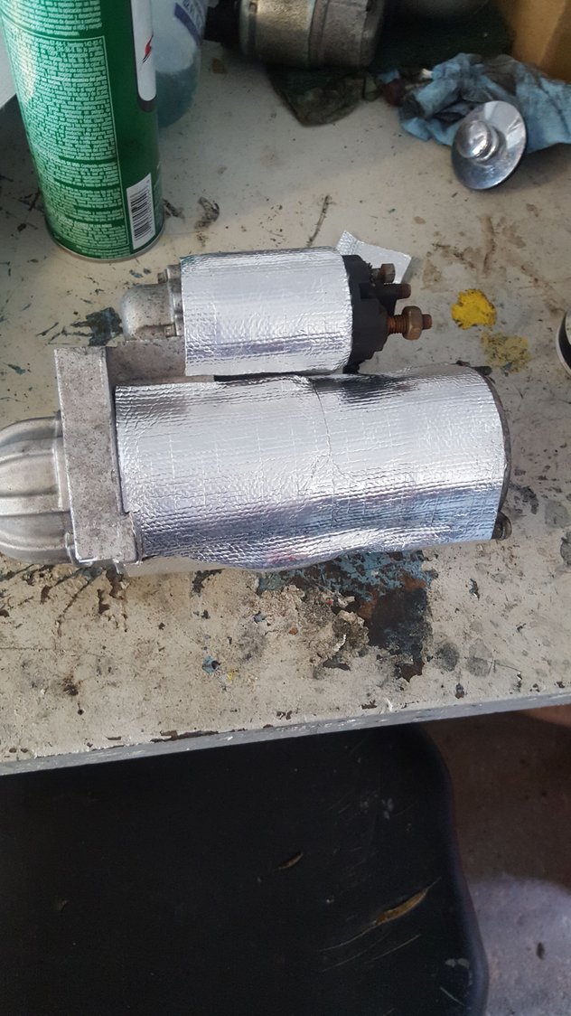

I bought this heat wrap
I wrapped the starter on one side. Hopefully it helps

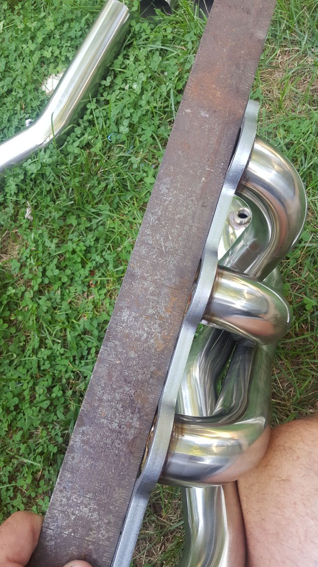

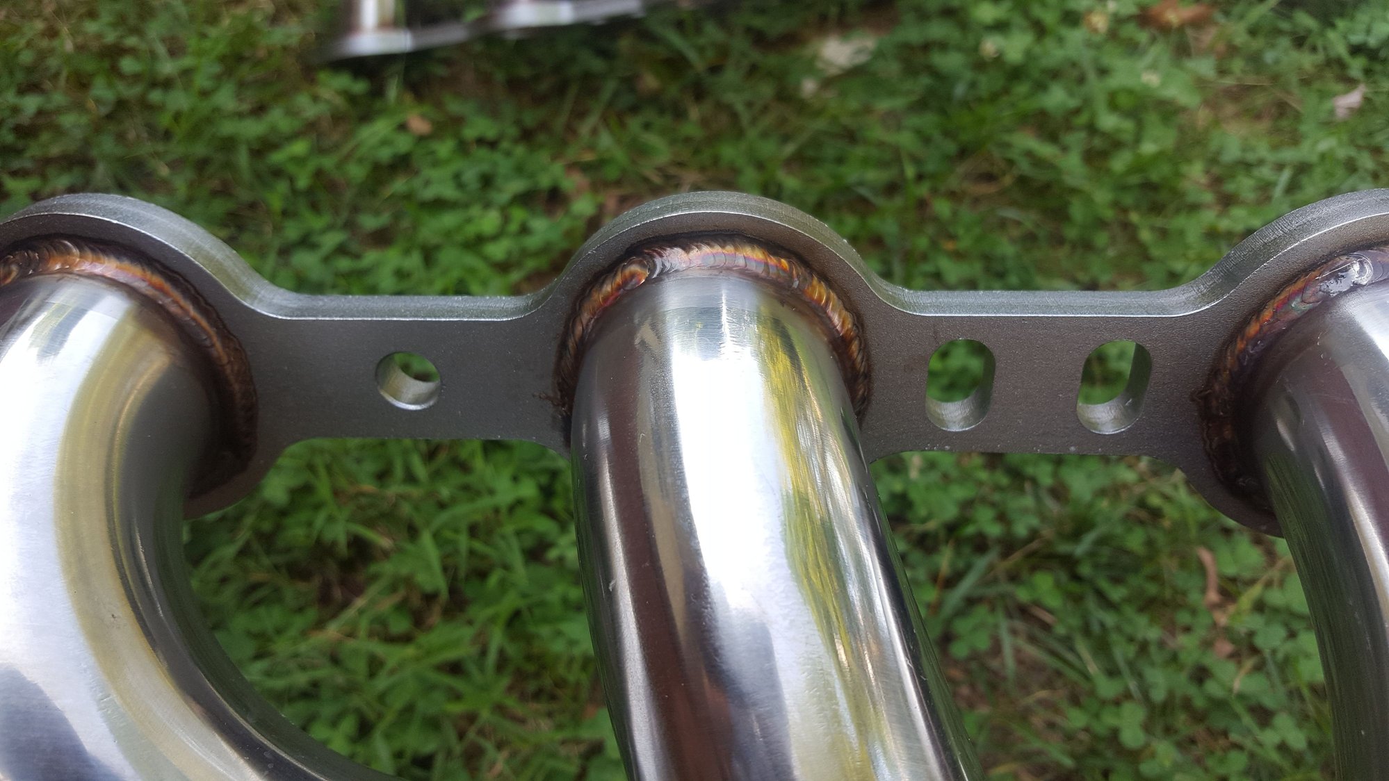

The welds look fantastic

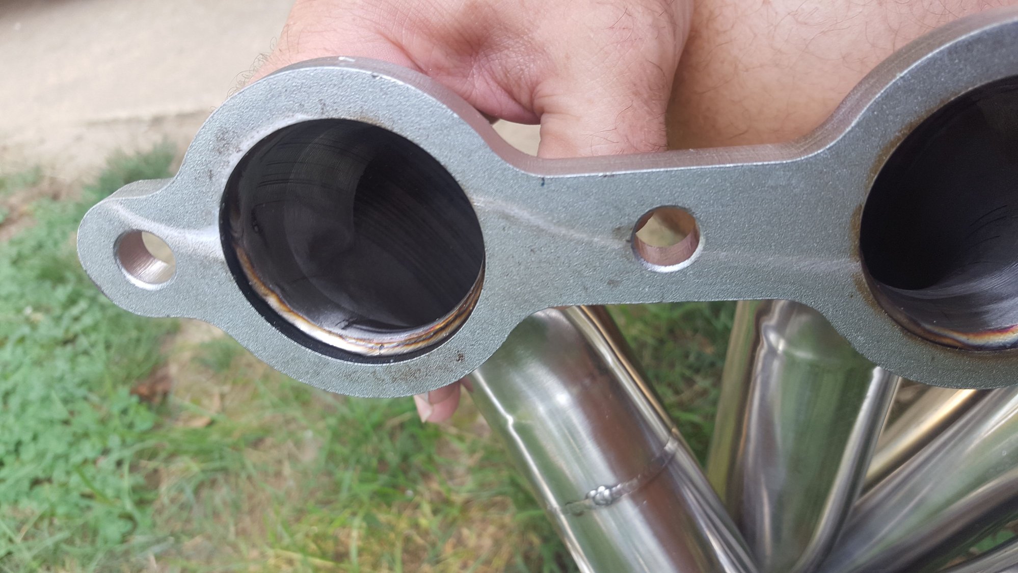

No garbage in the ports. Everything was de-burred
My rusty straight edge said, good.

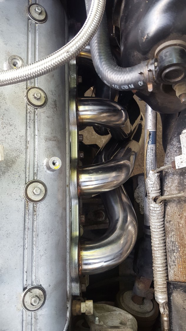

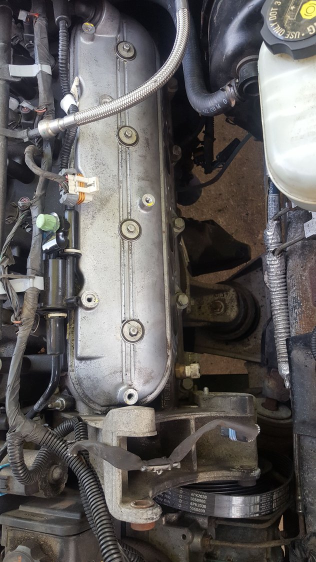

Drivers side in. Plenty of clearance
Both headers fit perfectly. No steering shaft issues. The O2 sensors fit fine. Biggest issue was/is keeping the wires off the headers on the passenger side. Only one O2 sensor extension is needed (for the passenger side). I did fire it up open and it was LOUD. After I shut it off, I went to start it again and just got a click. I probably have a bad starter connection. Installation at this point has been a breeze. Both went in, in about 2 hours. That included putting the coil packs, plugs, alternator back on. More to come
