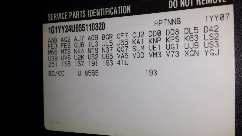

One thing you can do is locate your RPO Code Label. Based on production year, it may be in 3 different locations.
First, the rear cargo covers, usually the right one, on the underside.
Under the center console lid, or on the inside of the glove box door.
It looks like this.
Here is the list of RPO Codes for your 2000
https://www.corvetteactioncenter.com.../2000rpos.html
Match your codes on the label with the list from the link above and that will tell you what your car is equipped with.

Perfect! I did find the "build sheet" codes in the glove box but of course all greek to me.
Very helpful.

Weird. I just took a photo of my RPR codes from glove box sticker and was matching them with the list and found 8 codes from sticker that aren't on the RPO code list. They are: BGR, DL5, NC1, UV6, VG6, VG8, YF5, and 1SA. Any idea where I might find/search for a list that might have them? I tried googling and got a couple of sites that had the list but none had the above mentioned codes. I did find that it does have the 3.42 gears as another member had said that it would which was my original question.
The car is a 2000 c5 vert. with manual.
Thanks.

Here ya go :
1SA is the base car with no options. Base car included the following:
1SA Corvette Base Equipment Group. Includes standard bucket seats and 4 speed automatic. 1997-2000 models included Delco Cassette radio. 2001-2002 models included Delco CD radio, 6 way power drivers seat and Active Handling. 2003-2004 models added dual zone electronic A/C. All model years included leather seats. No cost.
BGR Plant Code Bowling Green, KY, USA
DL5 Decal Roadside Service Information
NC1 Emission System, California LEV
UV6 Display, Head Up
VG6 Label, Information - Bumper Impact
VG8 Vehicle Label, Notice to Buyer
YF5 California Emissions
Here is the COMPLETE List for the entire C5 production run.
C5 Regular Production Order List:

G90 Axle, Rear, 3.15 Ratio
G92 Axle, Rear, Performance Ratio
GU2 Axle, Rear, 2.73 Ratio
GU6 Axle, Rear, 3.42 Ratio

Originally Posted by WetMountainMan
Mine...
G92 Axle, Rear, Performance Ratio ... What does this really mean?
My 04 has the same 2 RPO Codes....Beats the hell out of me why that is
Here's my label:
Here's my label:
Yeah strange. GM in it's wisdom.
