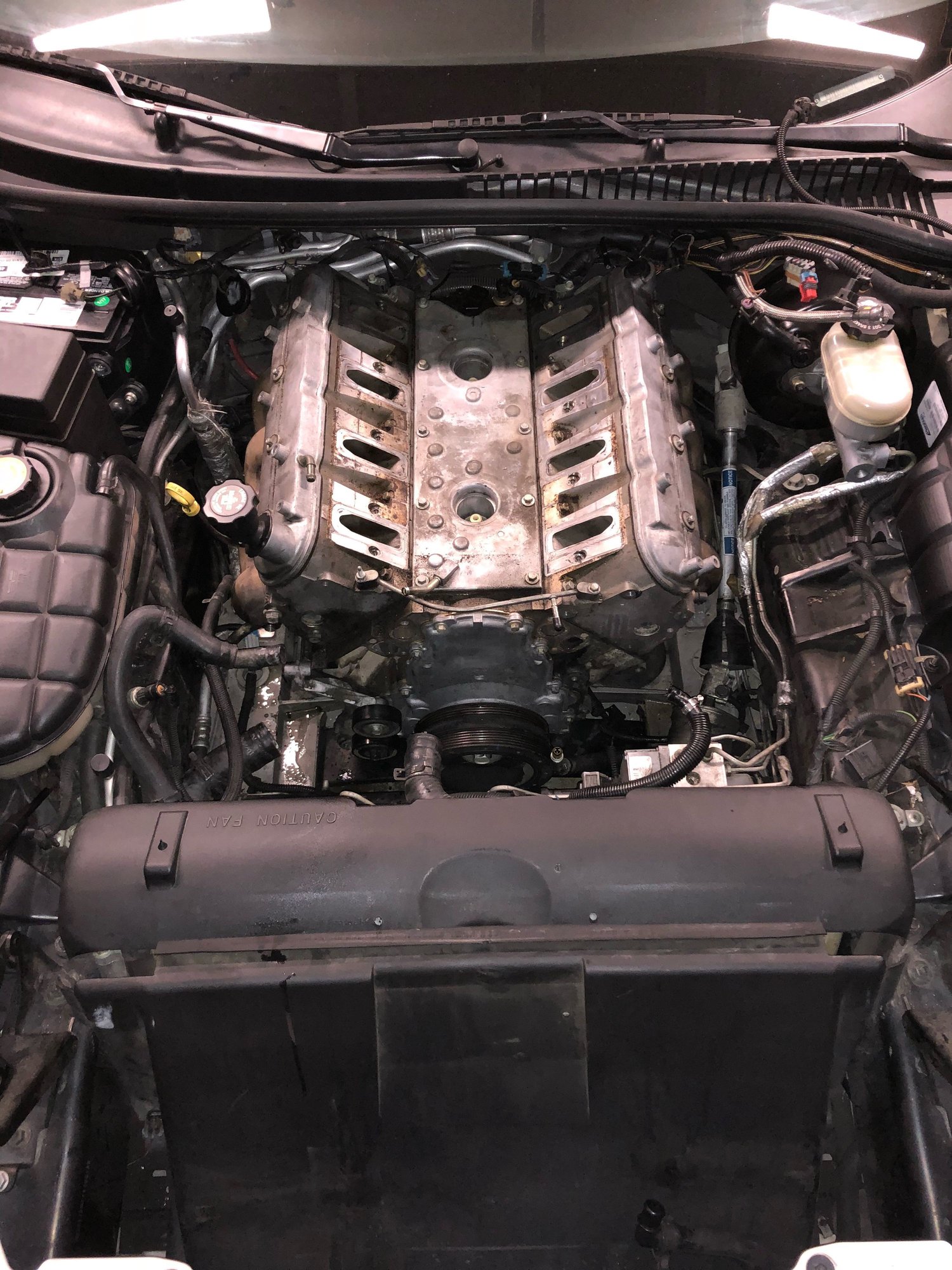

Hi guys! So I am in the middle of pulling out my tired old LS6 in preparation of sending it off to have it rebuilt locally. They will be handling everything from the valve covers to oil pan internally. While its gone, I thought it would be a good time to go through the rest of the engine compartment and r&r anything that makes good sense while I have some downtime and accessibility; I'd like your input.
Spark plugs
Oil pressure sensor?
EGR valve?
Water pump is only 2,000 miles old, so I will put new gaskets and reuse.
AC compressor? Cheap and a pain in the *** to install once its all back together, does it make sense to replace along with the other components at this time? Car has 68k miles on it and the AC blows ice cold. I will say that when removing we have no idea how much oil spilled out so I think I am going to have to flush the entire system and all parts in order to start from scratch and reinstall / measure oil.
Power steering parts or?
o2 sensors?
Radiator?
Knock sensors?
I am also going to detail the engine bay, re-wrap the wire harness in fresh electrical tape and generally clean it up.
Despite what it probably sounds like, I am not really a big fan of just throwing parts at cars. That being said, I plan on keeping this forever and figure its had a hard life and has some decent miles on it so perhaps its better to be very proactive and start replacing parts before they cause headaches later on. The last thing I want is to get everything back together after a large project like this and have issues within a few months.
Anyway, feel free to tell me I am crazy, justified or somewhere in between.
Thanks as always, I would never have tackled such a project without the help and resources of this forum!

We are SOOOO close to getting this out. Question, is it possible to pull with the bell-housing still on? Not sure how the heck you are supposed to get to those bolts with the motor still in the car. Any input would be great. We are ready to drop the cradle and get the party started. Thinking about taking off the TT bolts and trying to pull the motor / bell-housing as one. Also, do you need to do anything towards the rear of the car to help with the TT angle to get the motor out?
Thanks all!!
Old Aug 19, 2018 | 12:07 PM
93Polo's Avatar
93Polo
Joined: Oct 1999
Posts: 31,977
Likes: 487
From: Guinness Its whats for B'fast JAWGA
CI 3-4-5-9 Veteran
Yes you can get it out with the bellhousing on by removing the 5 bolts that attach the bellhousing to the torque tube.
The subframe must be lowered with the factory oil pan. A C6 LS2 oil pan will go in and out without dropping the subframe. We used a transmission jack to lower the subframe. We use a jack stand to support the torque tube in the tunnel. I would remove the shifter. You can leave the front accessory bracket with power steering pump attached. The power steering lines between the rack and pump must be disconnected from the rack. You must use a crows foot or a line wrench (what we use) Go slow so you can look for any wires, lines hoses etc which could be damaged. It is really a 2 person job.
You can unbolt the bellhousing from them motor in the car. You can access the top ones with a wrench and the intake off the motor. I prefer the path of unbolting the bellhousing from the torque tube. Yes, I have done both.
In the future we do not disconnect the AC compressor but unbolt it from the block and ratchet strap it to the frame. We also leave the fuel rail connected to the fuel line laying it over on a fender protector on the windshield.
