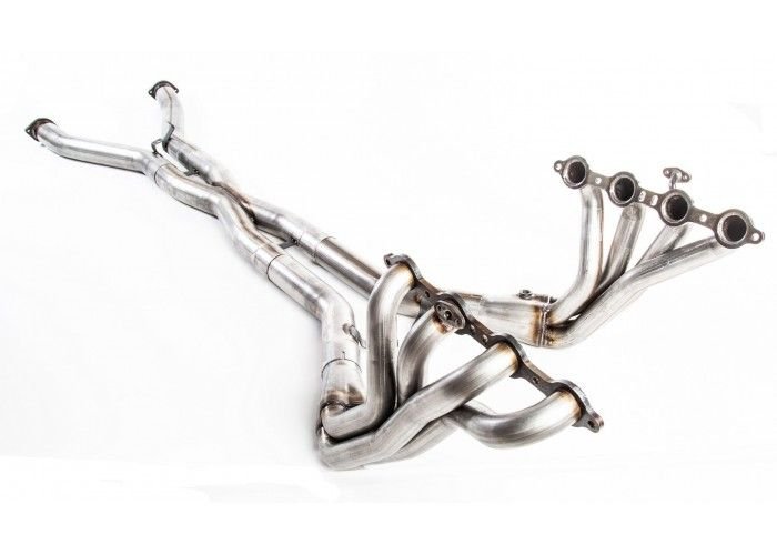

Get a set of American Made TPS Headers

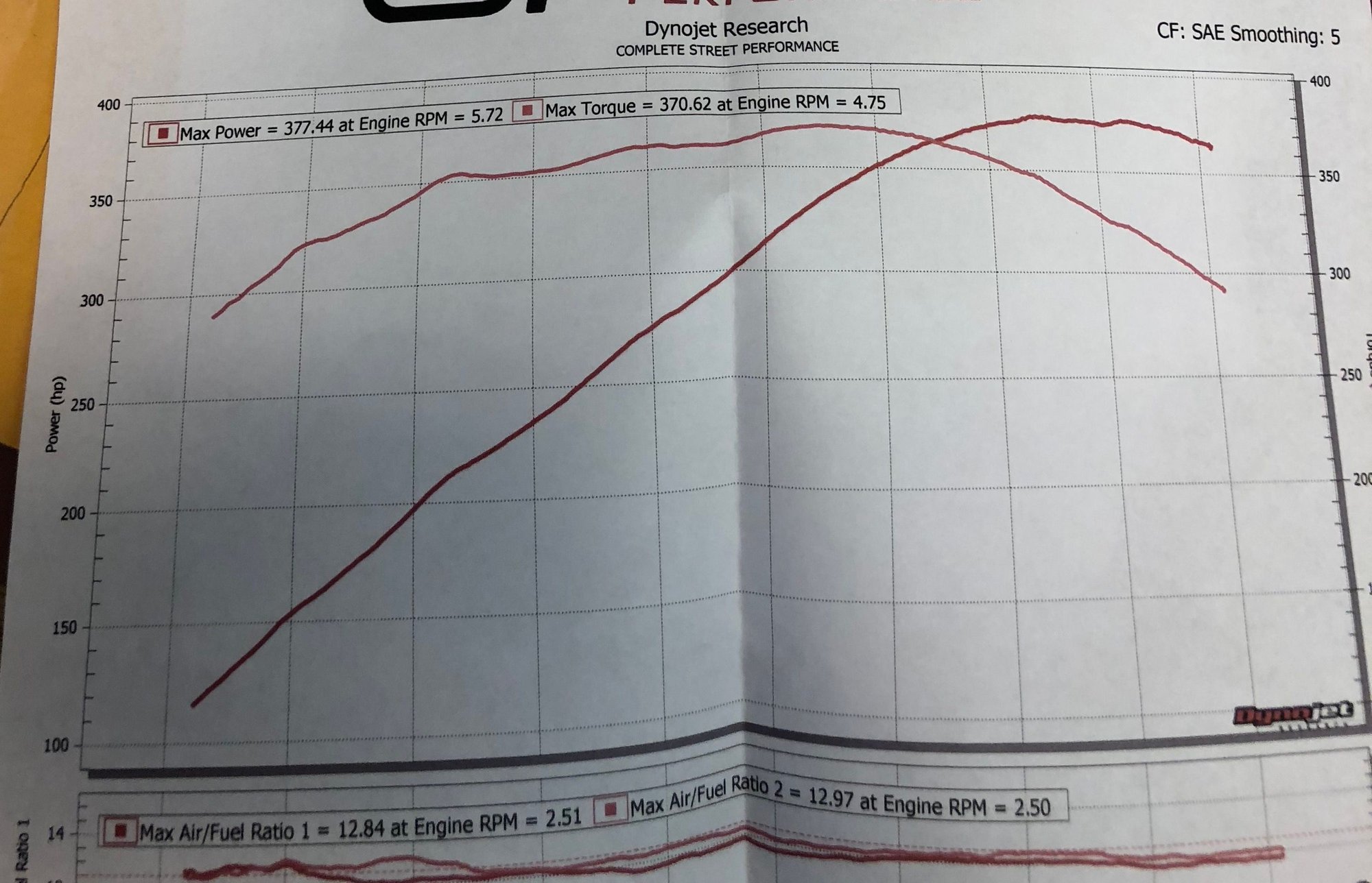

These Numbers are for our TPS RPM Headers & X-Pipe on a Bone stock C5 Z06 (180K Miles) with Tune. Bottom Is baseline , Top is headers only No Tune and middle after Tunning. 372 RWHP/ 362 RWTQ
$999 Shipped to your door
http://www.tpsmotorsports.com/tps-rp...-w-x-pipe.html
