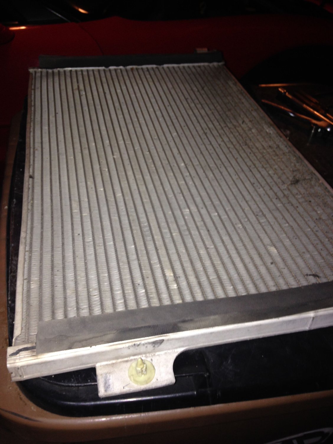

Old condenser has 2 foam strips to seal edges to plastic shroud, new condenser doesn't, I'm thinking of carefully removing them and glue them to new condenser.
The condenser I just pulled out has a sticker showing September 2000, my car is 1999, so apparently it has had a condenser replacement already.
The old condenser has 2 plastic bolts that the shroud sits on, and 2 metal almost flat washer/nuts, they were near impossible to get off (the washer/nut things) and I had to use force to get them off.
Again the new condenser doesn't have these parts, and it doesn't seem the plastic bolts are able to be removed from the old condenser, they are sandwiched on, and will have to be broken to removed.
I need a way to secure the shroud to the 2 condenser mounting points, maybe a hardware store will have something, speedy nuts might work, but not sure if they would touch radiator.

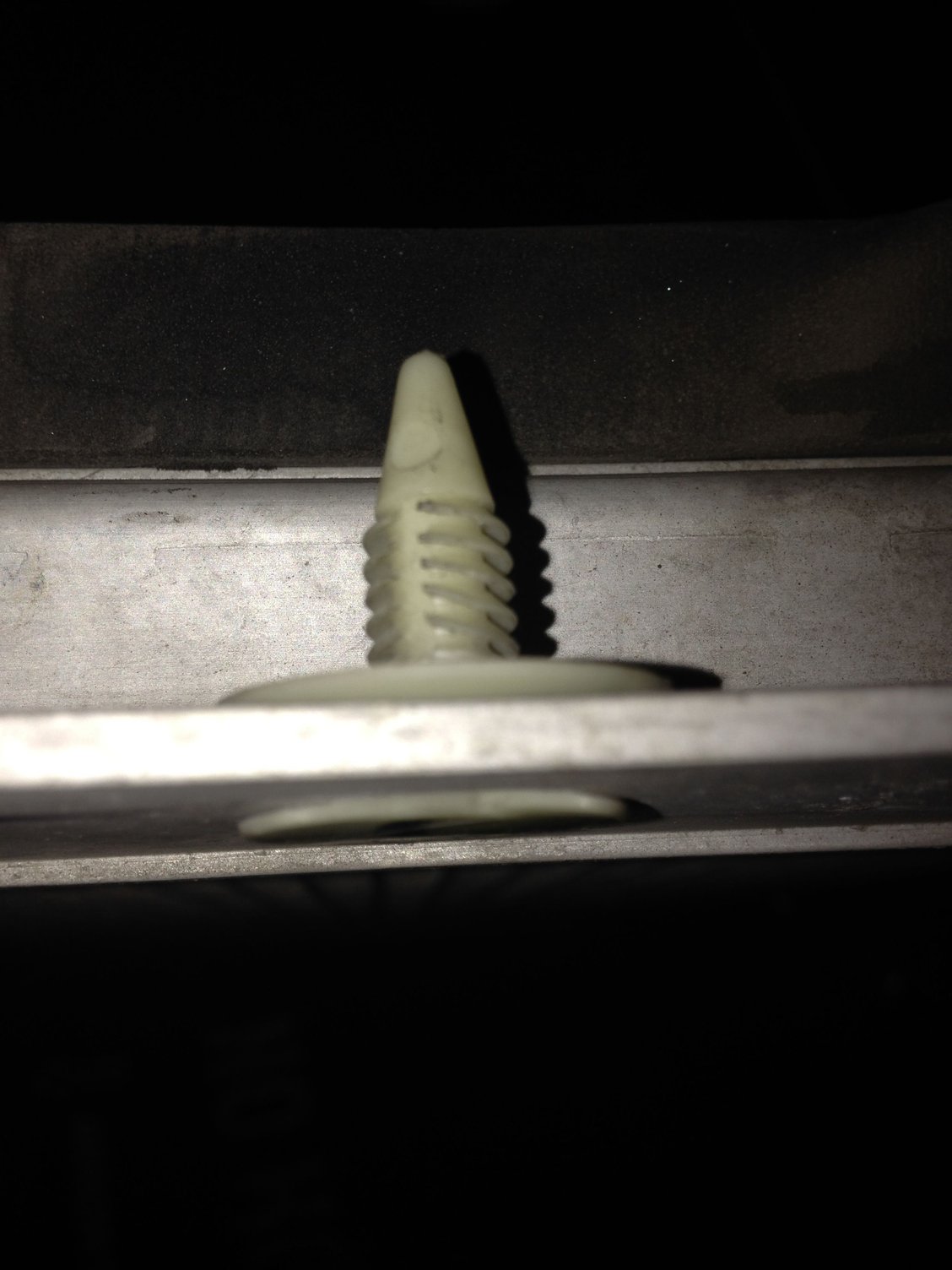

Foam strips, may transfer to new condenser coil.

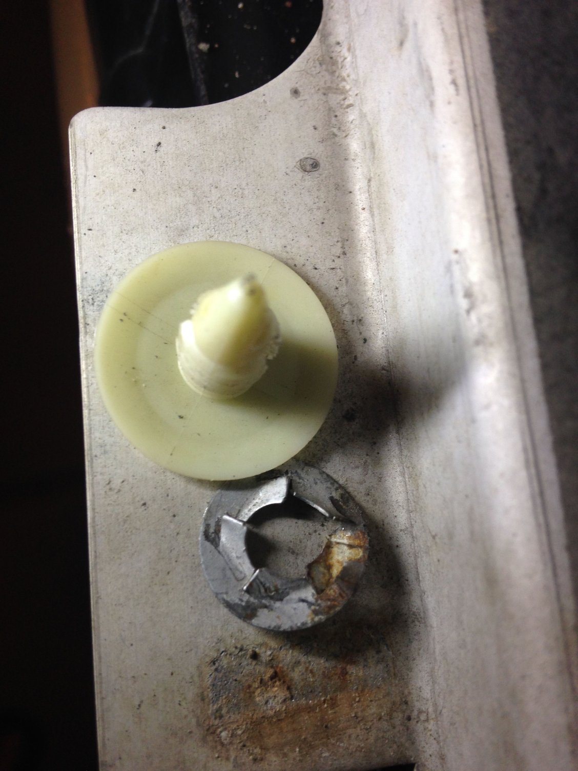

These were the hardest part of getting the condenser out.

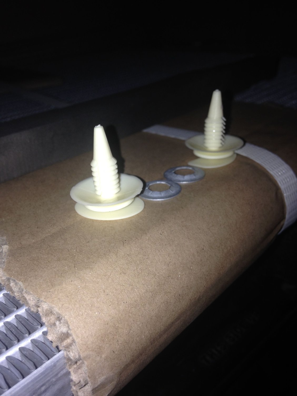

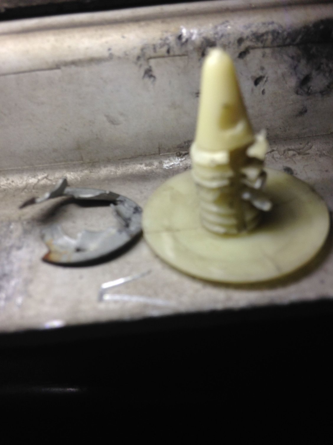

I haven't transferred parts yet, but found and bought 2 new plastic bolts (forgot the name) and 2 "push nuts" the thin metal things at Russ's True Value, $2.39 with tax.
For future removal to make it easier, I would cut the push nuts with some snips, vs using a flat head screwdriver to pry it off, one just broke as you can see in the picture, the other took a lot of work and chewed up the plastic bolt thing.
I tried to buy new foam, as these have rips, but couldn't find anything the same size and same density so I'll reuse them.

​​​​It really isn't issues, I just wasn't sure if the parts attaching condenser to shroud were available and kinda tore them up, but now knowing they are available new and easy to find, no big deal.
Once condenser is out you can get the plastic bolt things out by sliding it to one side and push the ear through the hole of condenser with a screwdriver.
Or just buy new ones and only transfer the foam pieces.
The condenser I bought through Amazon was right under $80.00 with free shipping, and including sales tax.
Maybe more expensive condenser like AC Delco has new foam strips and the mounting hardware?
I'll try to get pictures of new condenser before putting it in the car.

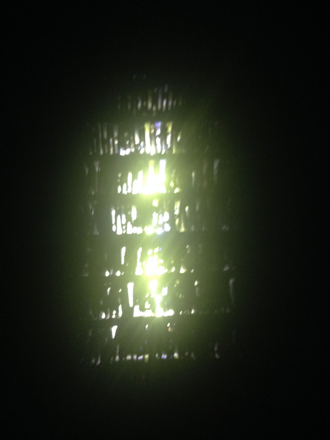

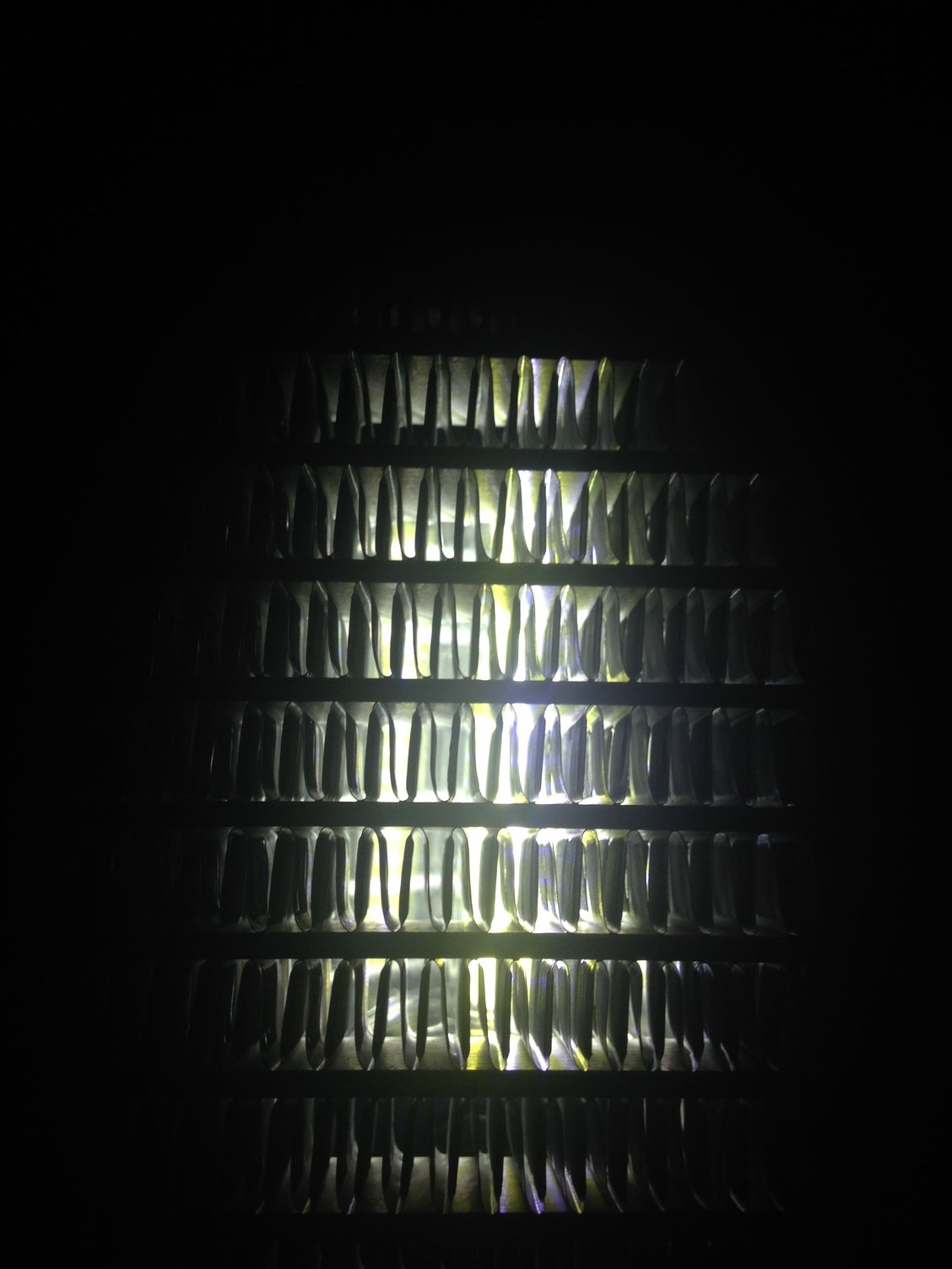

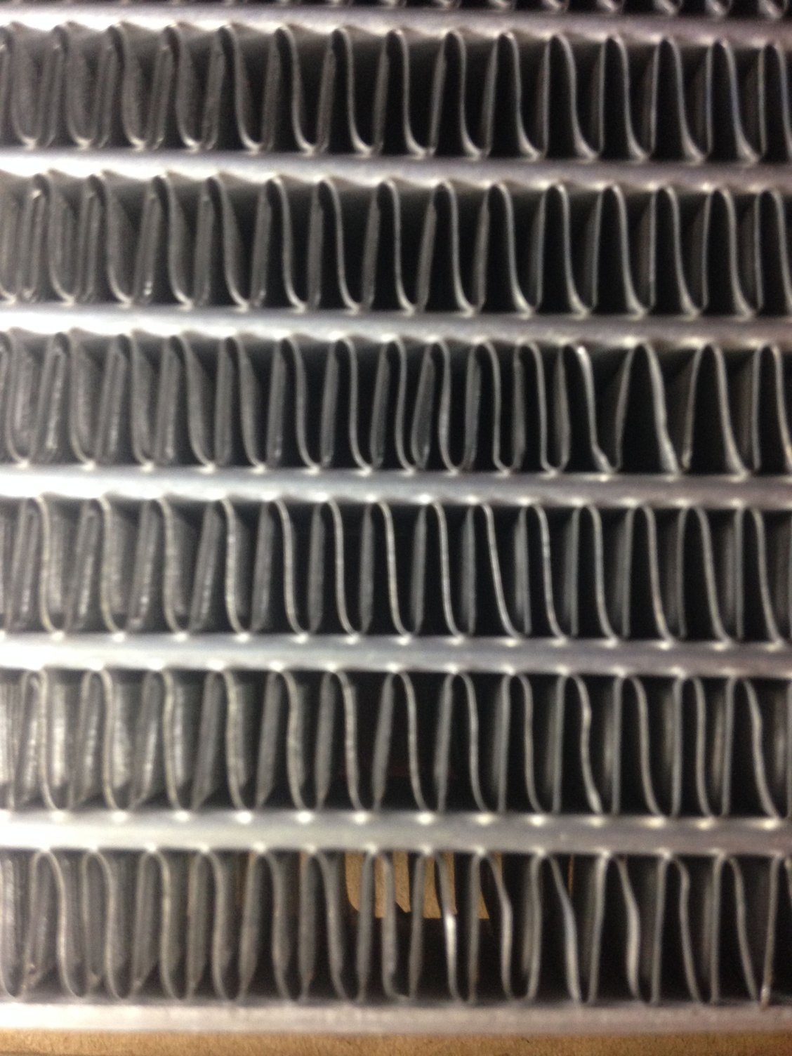

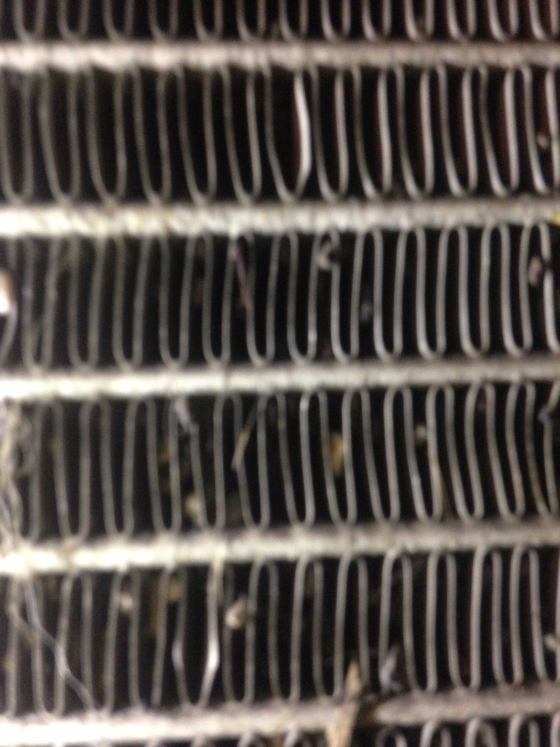

In June I tried washing the radiator and condenser out, backwashing from engine side to front, spent a lot of time, also got between radiator and condenser and backwashed best I could.
The condenser is still plugged up with sand and tiny rocks from going down the road, putting a light under one side shows how plugged it is.

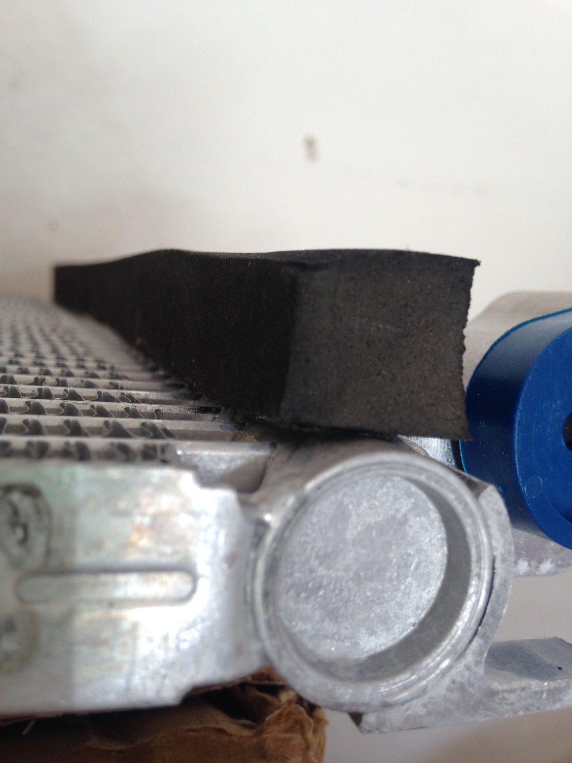

Old
New

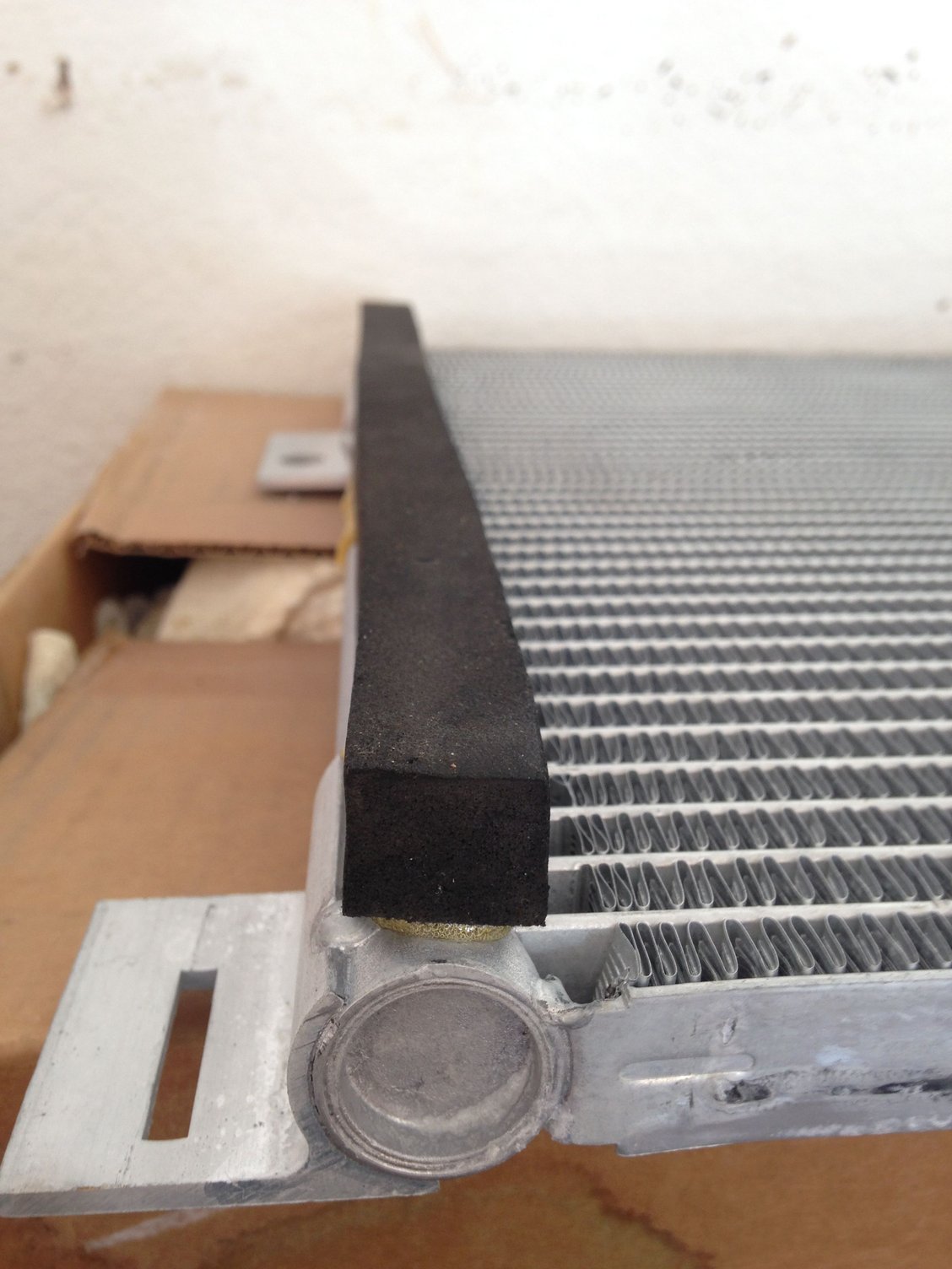

Old
New
New mounting pieces from True Value

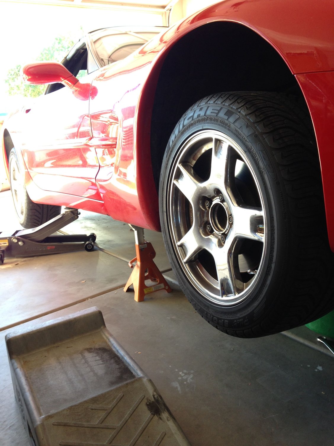

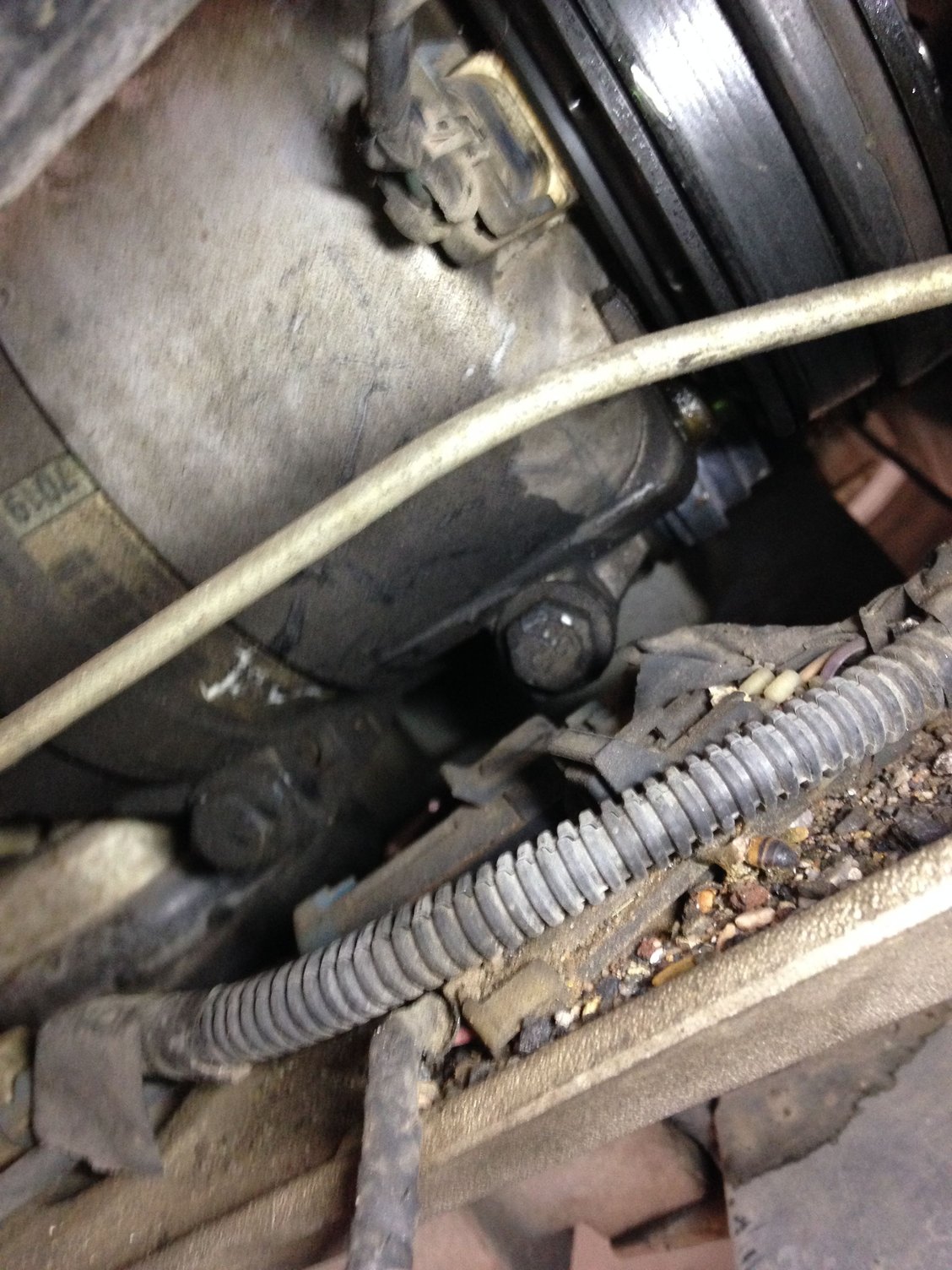

Getting back to Corvette I'm about to pull off wheel to see if I can access lower compressor bolts, this is first time removing wheel off car myself (never had a need to until now, and made jacking pucks and bought new low profile jack) it's a little weird compared to a regular car or pickup.
Does this look safe? Drivers front wheel still on rhino ramp.

The jack on rear puck is not lifting any, it's just there as a backup just in case.

Yep, you must remove the wheel to access lower compressor bolts.

Old strips carefully pulled off old condenser and gorilla glued to new condenser, not easy to do because old surface was flat, new surface round, used random things to hold weight on strips, took a lot of balancing and rebalancing.
Old Nov 9, 2018 | 02:19 PM
1999corvettels1's Avatar
1999corvettels1
Joined: Jul 2010
Posts: 3,994
Likes: 386
From: Chandler AZ
Gorilla glue dries extremely hard, probably should have used something else that would allow these to be peeled off again if needed in the future.
This was a cheap condenser for 80.00 on Amazon, if any of you are replacing one try to see if any have the foam strips already included, to save time.
