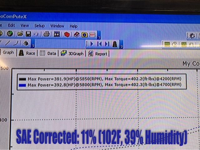

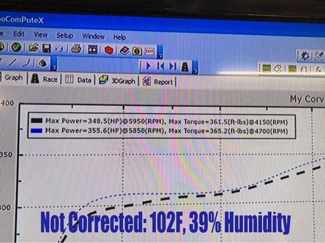

Now, before I go install this stuff, I needed to dyno the car to see what it's making before the mods. Just based on my knowledge of what was already done, I expected it to make between 380-390hp. I was pretty close. It made 392hp, 402ft-lbs SEA corrected. The only reason I'm going by the corrected numbers is because it was 103 degrees with 40% humidity (11% correction). Not exactly ideal dyno conditions, but I live in AZ, so not much I can do about that.

What kind of Dyno was that. Good numbers but it seems just a tad too high given the modifications. Dynos can be all over the map sometimes. What matters really is measurability after mods.
I have no idea. It was an AWD dyno. I've never seen one like it.

Your planning to use the same dyno and correction later, no? Optimistic or not, changes should still be relevant.
I'm going to a different place to have it tuned, but when all is done I will bring it back to this same dyno to compare.
