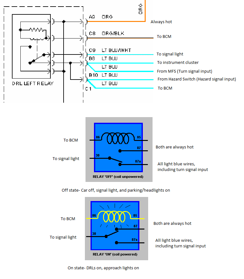

Possible bad ground? That's what I would check. Make sure your BCM plug connections are tight as well. And I would double check the front turn signal bulb socket.
The turn signal goes through the relay to get to the front turn signal lights. It makes sense that removing the relays caused your front turn signals to not work.
I see now, and agree that this would explain the front turn signals. That diagram is very helpful, thank you.
I have this spidey-sense that it's related to the Hazard Switch, especially after looking at this diagram. The hazard button does not press down and stay compressed when I push it in. The lights on the dashboard that I was seeing when I turned the front lights and parking lights on (which both worked) were both turn signals on, at once -- just like as if the hazard lights were on or were somehow getting signal input from the switch.
I'll get a grounding diagram and make sure to check them all.
