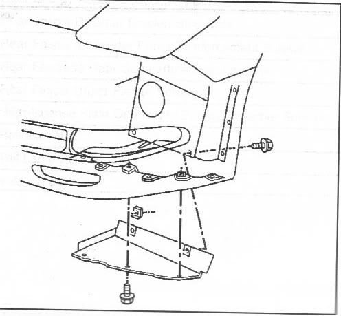

To gain access you could try to disconnect the motor linkage from below, after manually opening the headlight as far as it can go. Put the car on ramps or jack it up and open the bottom panel:

...To gain access you could try to disconnect the motor linkage from below, after manually opening the headlight as far as it can go. Put the car on ramps or jack it up and open the bottom panel:
