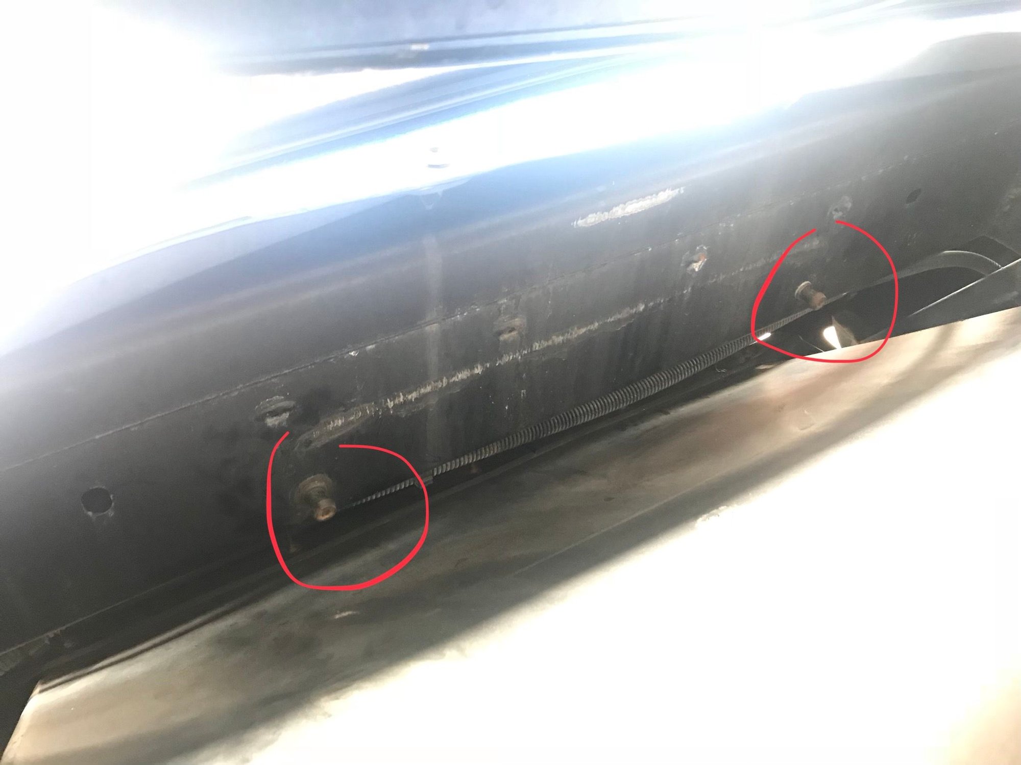

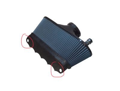

They go in the circled parts of the picture below. Thanks everyone!
I just replaced mine a few weeks ago...they are the 25099300 p/n !!!....I also have the SLP Blackwing !!

perfect, thanks so much. I’m in there cleaning the MAF now so I snapped some pics for future reference for others. Here’s the mounting location on the car.
Yep !!...that’s the spot !!...I was cleaning my MAF too when I noticed one was missing !!...have fun !!
