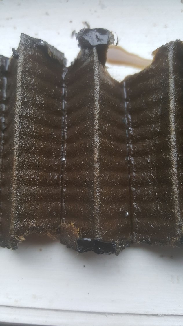

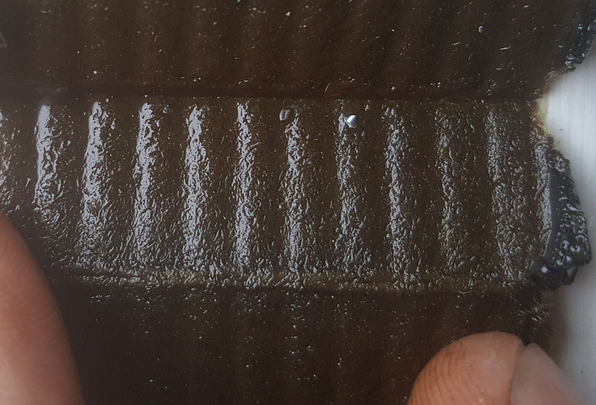

Did a oil change the other day and decided to cut open my filter and noticed some metal. I know there is always going to be metal shavings to some degree in the oil but this seemed to be a little much in my opinion. What do you guys think? This oil had less than 1k miles on it (had to change it bc I used seafoam in the oil). I have a magnetic drain plug and had fine shavings on it but not any chunks. Oil pressure is good and runs/idles fine. Doesnt throw any codes. I do have a lifter tapping pretty loud on every crank until it reaches op temp then goes away. I'm just hoping these metal flakes aren't a cam lobe. Opinions?

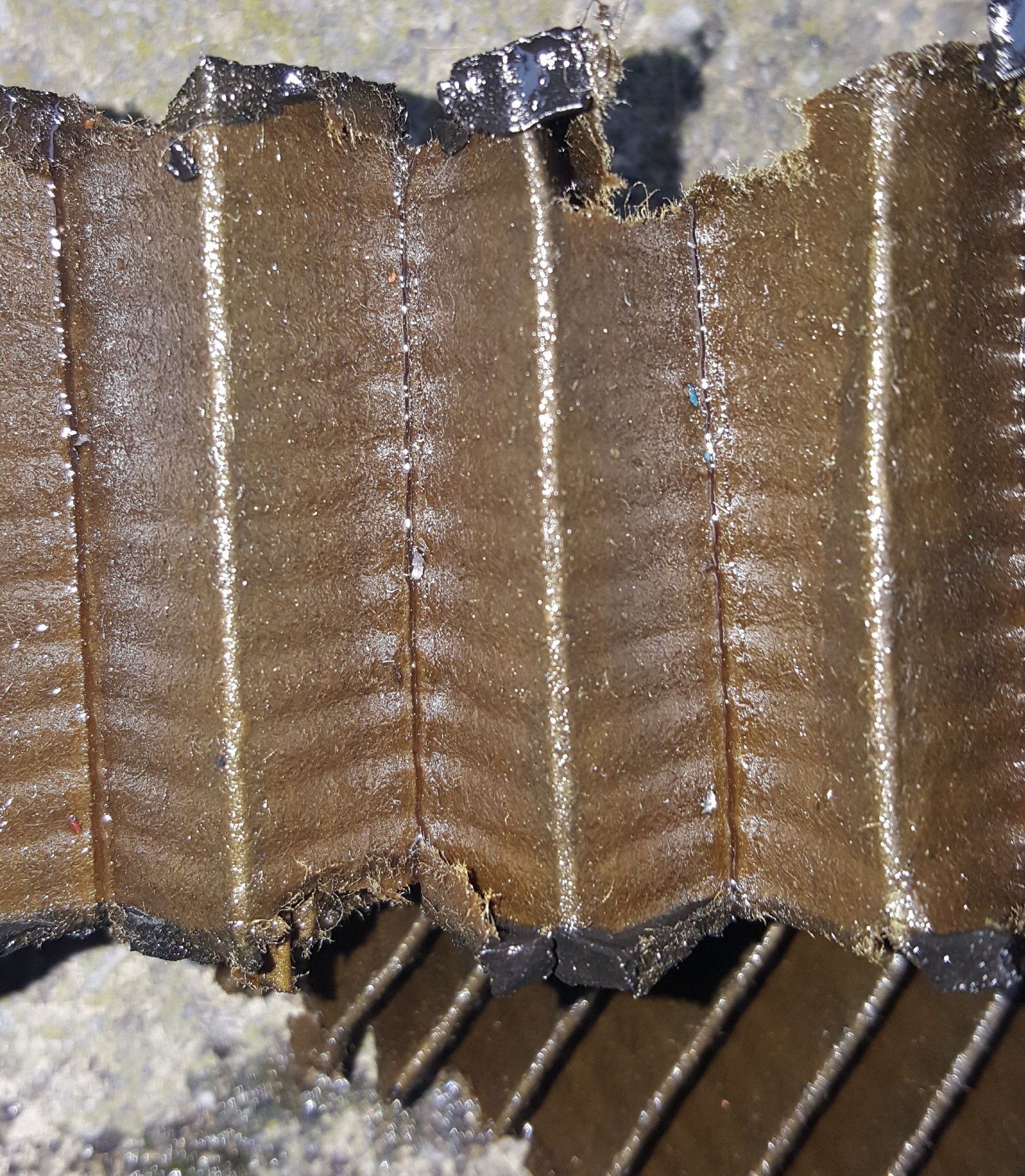

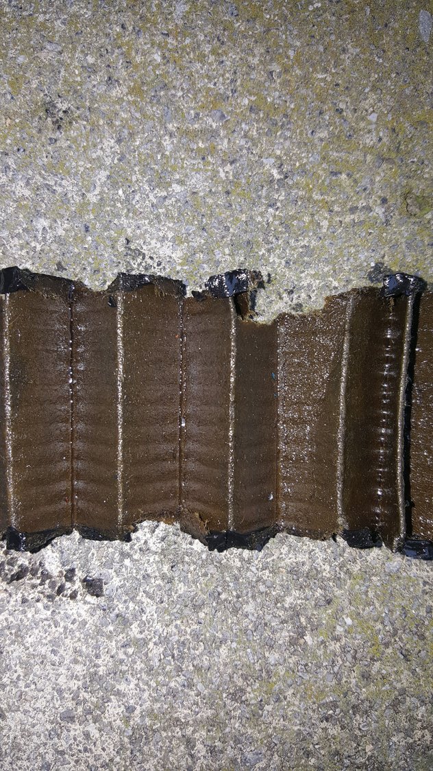

A couple more

My gut says you are probably ok but you need to keep an eye on it. You never mentioned the miles on the engine?
Remember, you put the SeaFoam in the system to loosen up trapped debris (gunk, metal shavings...etc) and trap them in the filter. So, far the product worked as intended.
Now, you just did an oil change, so drive another 1000 miles and pull apart the filter and see if there are any shavings. You will know what to do after that.

So guys according to the pics would you say I got an issue or prob normal to have a little metal?
Some big piece's for metal in that filter. Like the one guy has said the next oil chg I would do this again & see what that shows you & take it from that...Robert

I went through the filter to get a better look and feel of the metal. Not of it is metal chunks they are all very thin shavings.

I woudnt worry about that one bit. 70? Drive it
Most these make some crazy lifter noise sometimes. Almost convinced I have a bad lifter at 180k, oil is clean. At this point why worry.

Is that big chunk magnetic or alum?
Aluminum apparently, magnet didnt grab it
