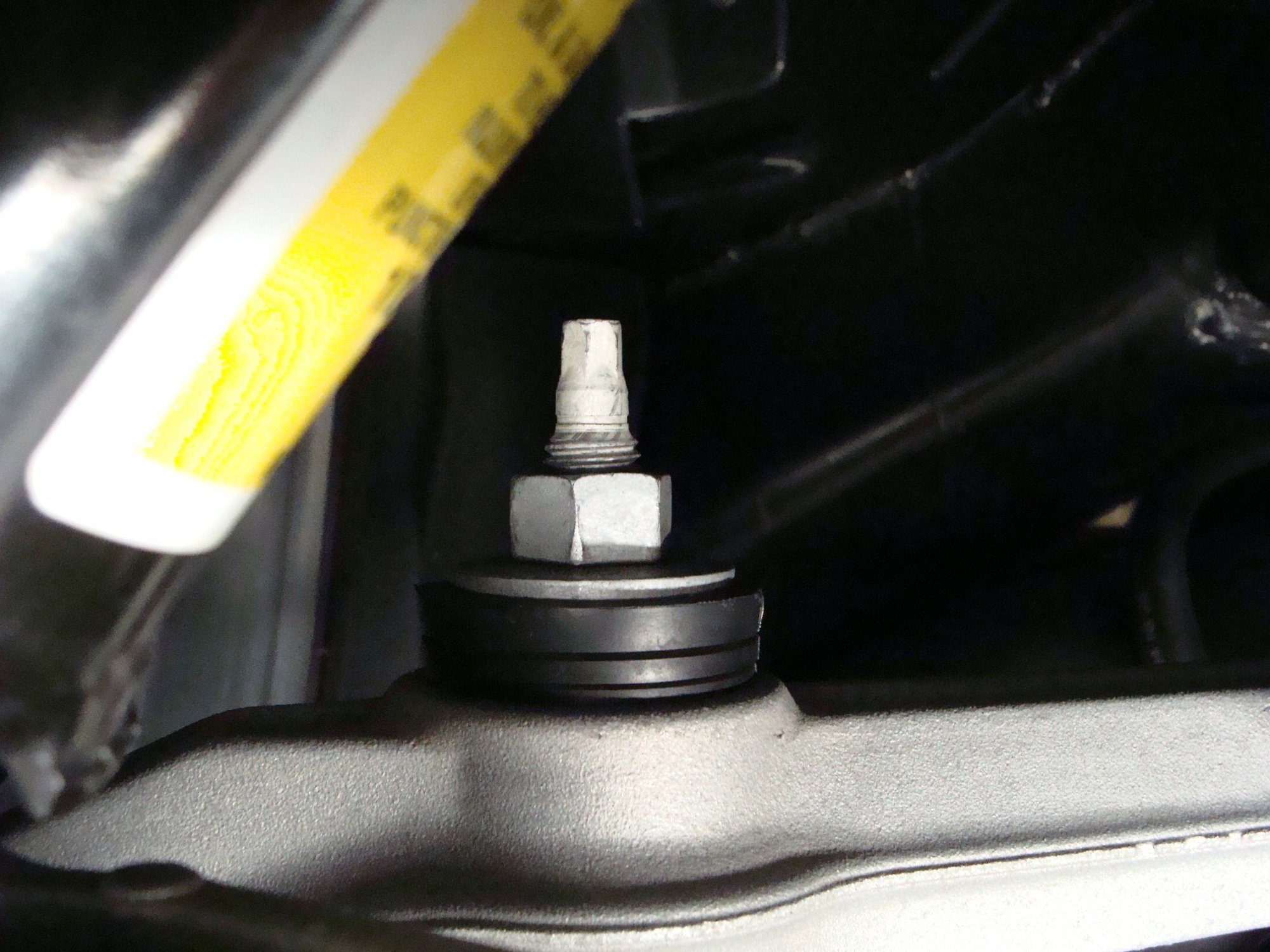

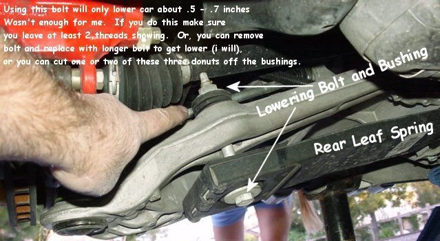

Bolt pictured is what you would use to raise or lower the car, more threads showing on top of the bolt raises, & less threads lowers.

Thanks Steve, already did that, but still need 2 more inches. T
