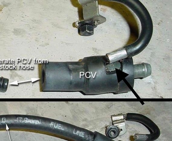

My car was running just a little rough a while back...not much though...hooked up the scan tool and looked at some fuel trim data PIDS.....no DTC's except long term fuel trims were running around 13% (anything over plus or minus 10% you worry about) but not enough to set a P0171/0174 DTC...it was a vacuum leak. Hooked up the smoke machine and found a pretty good vacuum leak at the PCV valve where the "condensation band" exits the PCV connector. You can see this in the photo. You can look there !!
