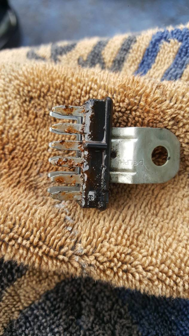

Update on what I've found, after looking deeper into the codes, I found that I had 24 codes all but 1 had an H, 1 had HC which is the horn, because I had to disconnect due to being woken up 2 or 3 times a night up as it would go off at 2:30 am. Codes seem to be lights and battery related for the most part, my questions is, do you get codes when you changes interior lights, turn signals, etc.? Also after reading the post by Bill Curlee, (http://www.corvetteforum.com/forums/...tion-long.html). I found a mess with the 2 under the hood.
After extensive cleaning and protecting both from happening again, still have issues. Next step is the battery?????
