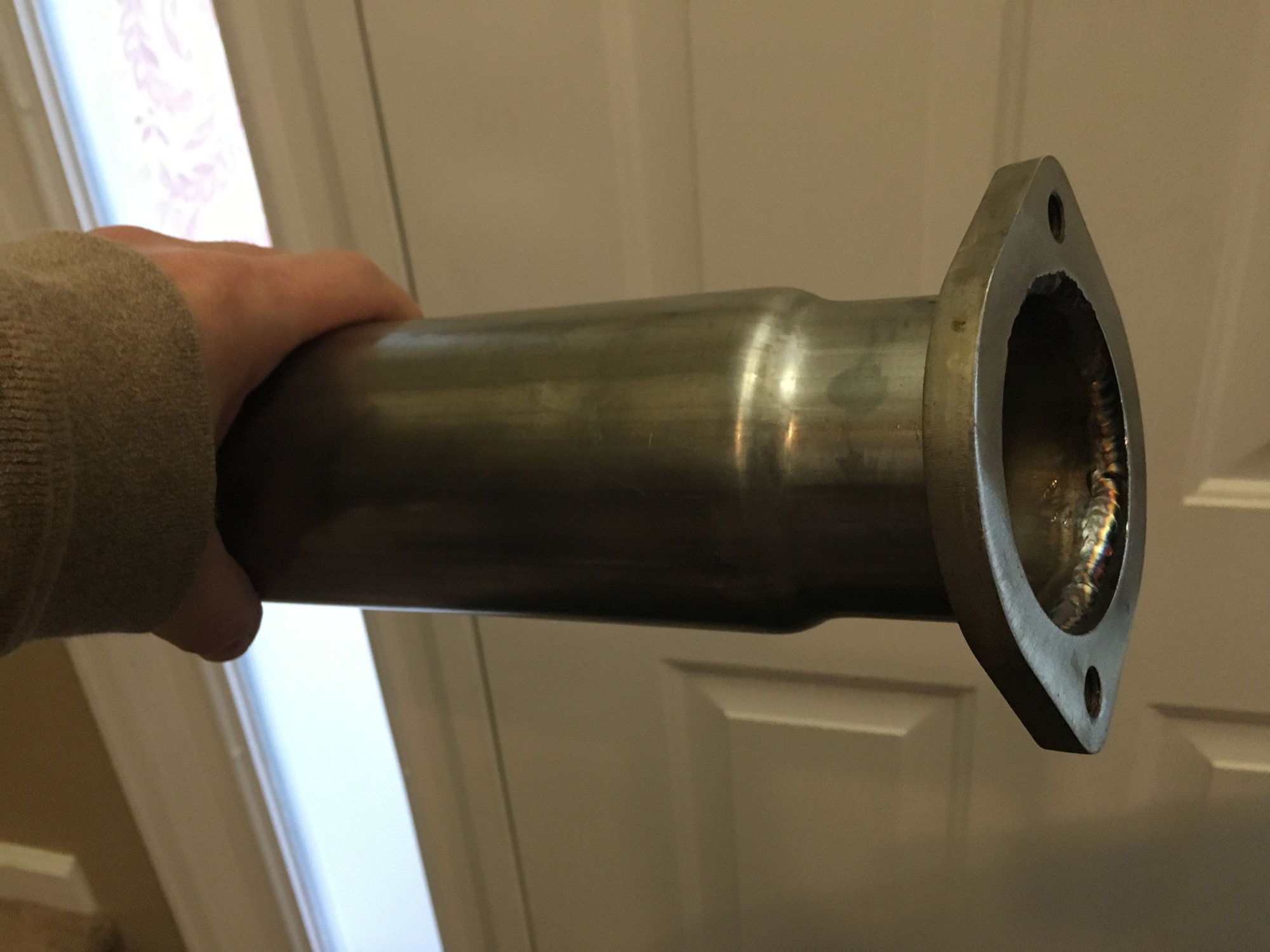

TSP x-pipe came today and what I thought was going to be a problem is...well, its nothing. Here is a shot of the new pipe that mates up to my existing Pypes exhaust:
The 3" is down converted and has a flange that matches a standard exhaust. I was not expecting that.

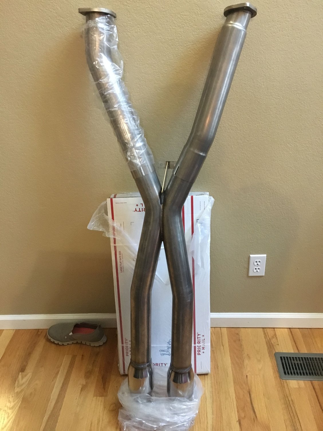

Here is the whole x-pipe:
Time to get to work!!
