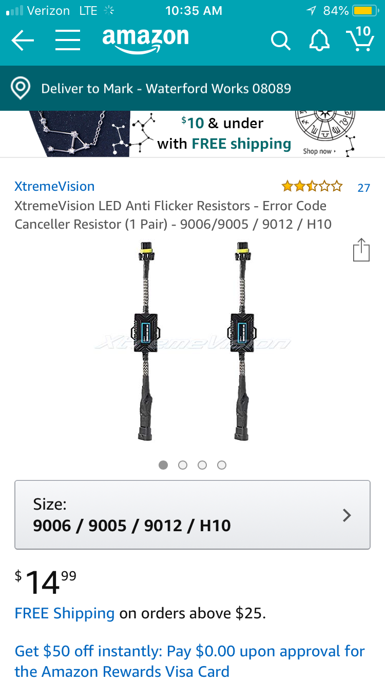

Default Is this the type I need ?
Where do you plug these in at ? Is the hazard switch the only relay for the flasher ? Is there one in the footwell that I can change for a hyper flash ?

No, those are resistors and they are not the best solution (they create their own set of problems usually from the extreme amount of heat they generate).
Another disadvantage of resistors is that multiple ones are required (if you install LEDs in the tail lights in addition to the front ones, you would need a minimum of 4 resistors), while only 1 hyperflash harness is needed.
The most efficient way to solve LED hyperflashing is by installing a plug-and-play hyperflash harness. I gave you a link in my previous post to one of the many available sources.

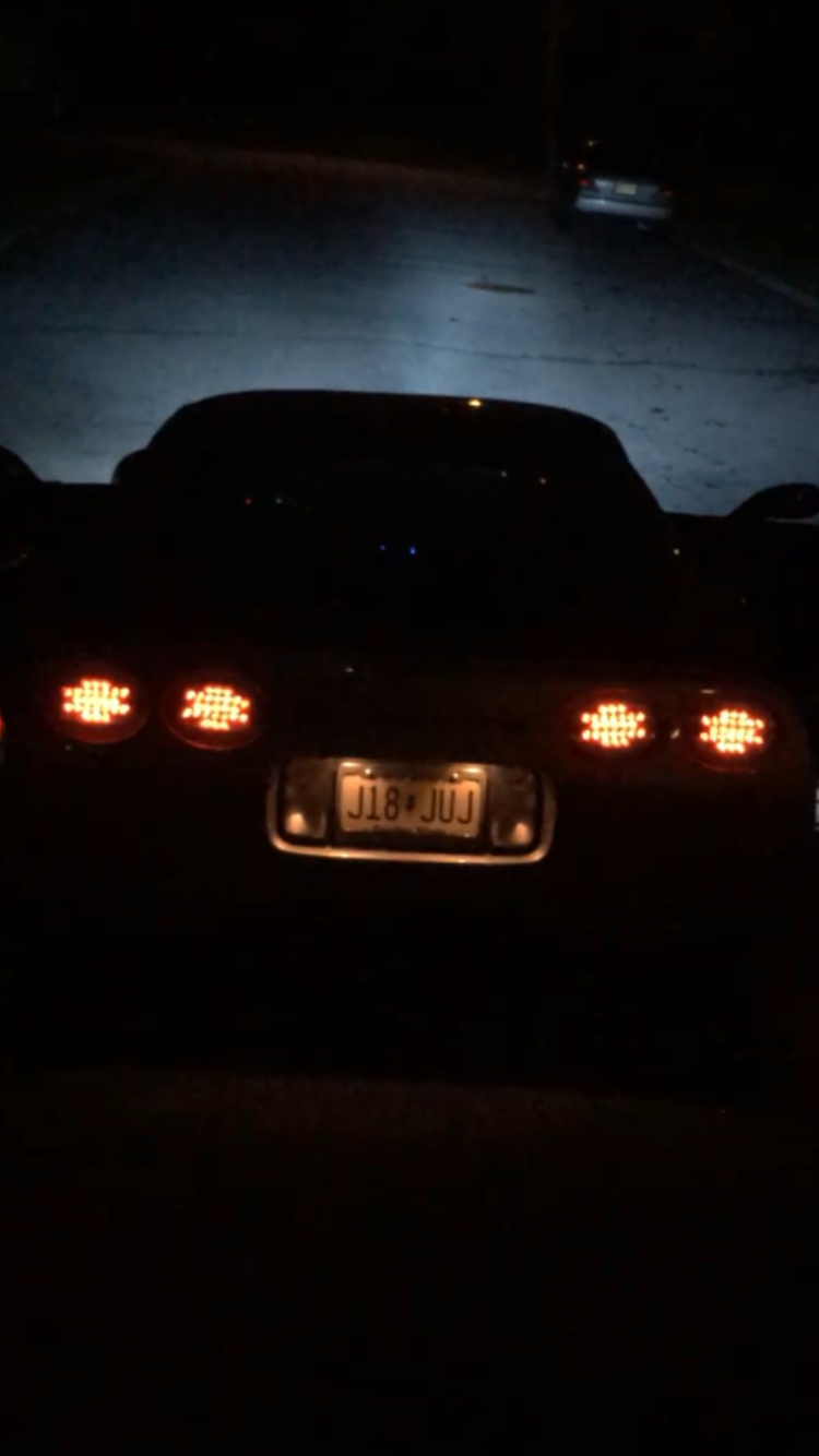

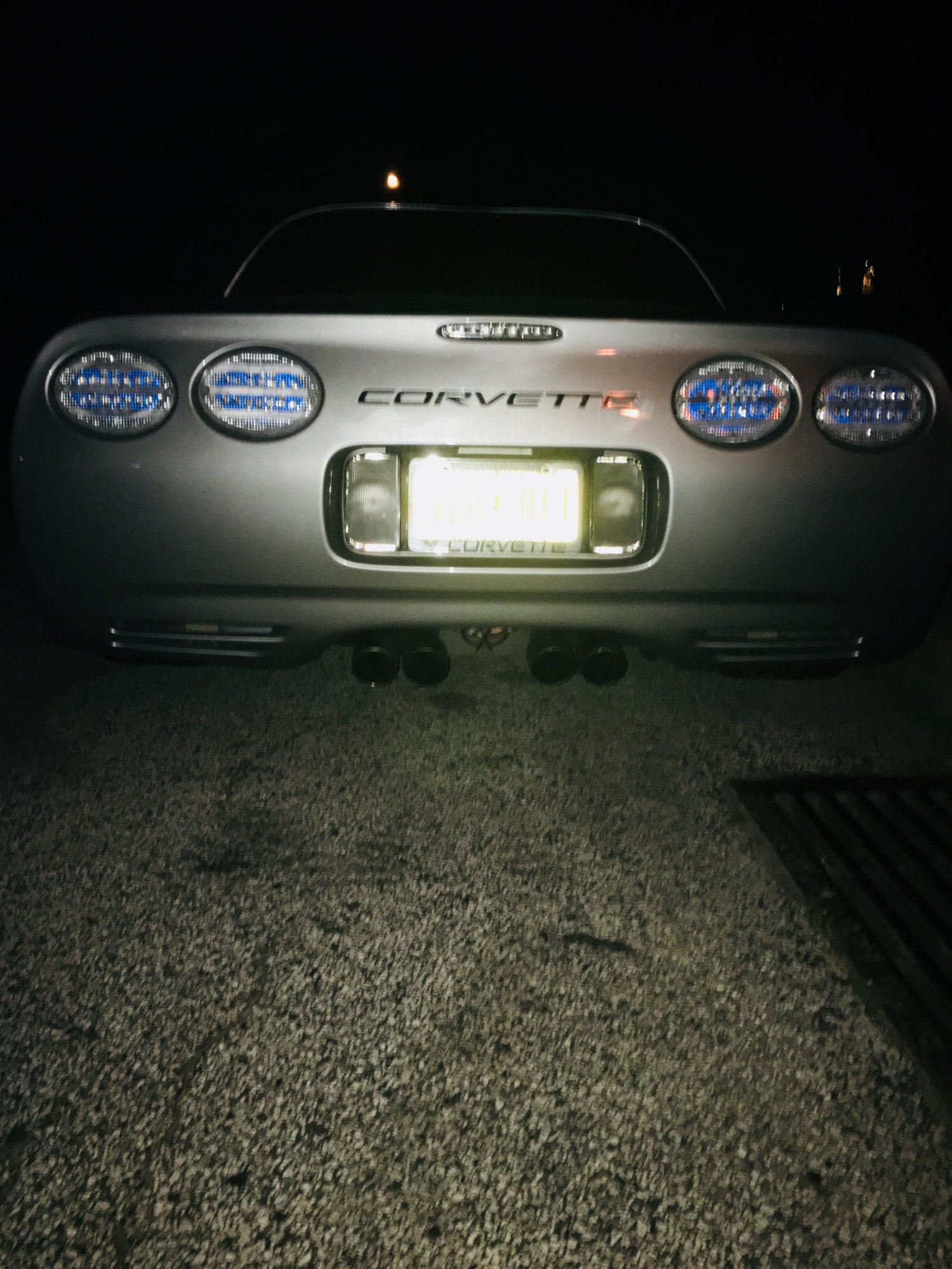

Depends on what you have for your LED taillights. The halo LED taillights have resistors built into them already, and won't cause the hazard to hyperflash. Obviously LED bulbs in the taillights won't have resistors and will hyperflash. Same with the RV LED taillights.

My tail lights. Got them from a member here. Weren’t in the best shape but they worked. If they have a resistor inside of them I hadn’t noticed.
