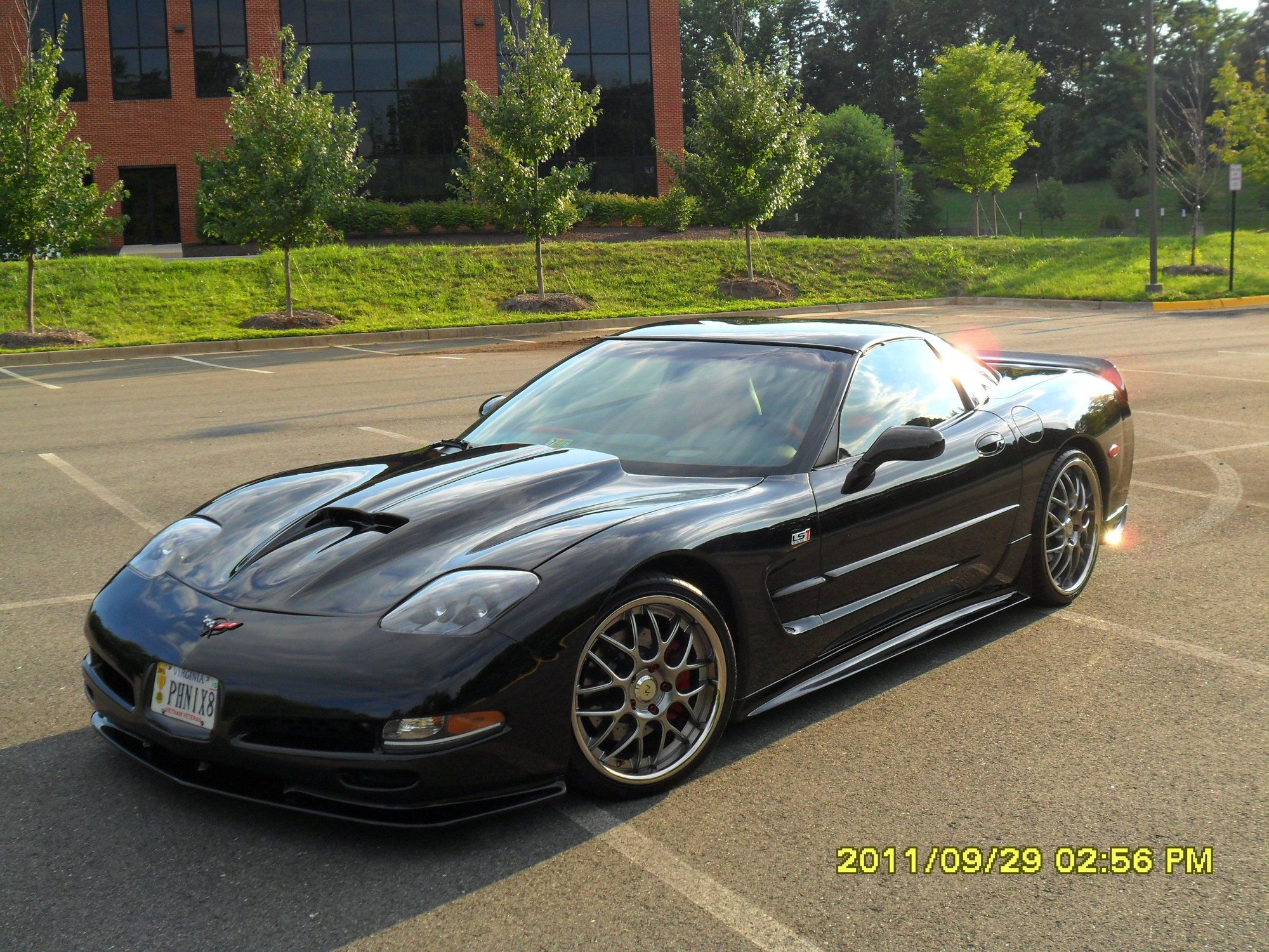

Happy to help with both type of headlights: Both have nearly identical performance.
identical optical performance.
I really like your flush mounted headlights, most others bulge out a little.
Mind sharing what brand? Thanks
Also, when the first response is what type of education do you have? And being a 10+ year army grunt for uncle sam, responding in a manner which I feel like the other person would understand only comes natural.
Thought I was clear, obviously i wasn't but the education level is high enough to have owned 4 corvettes, 3 which were Zs and good enough to have a c5 Z as a beater car. Never claimed to be an English major but I appreciate the help.
Radioflyer brand. It is his own in-house build using Morimoto HID projectors.
