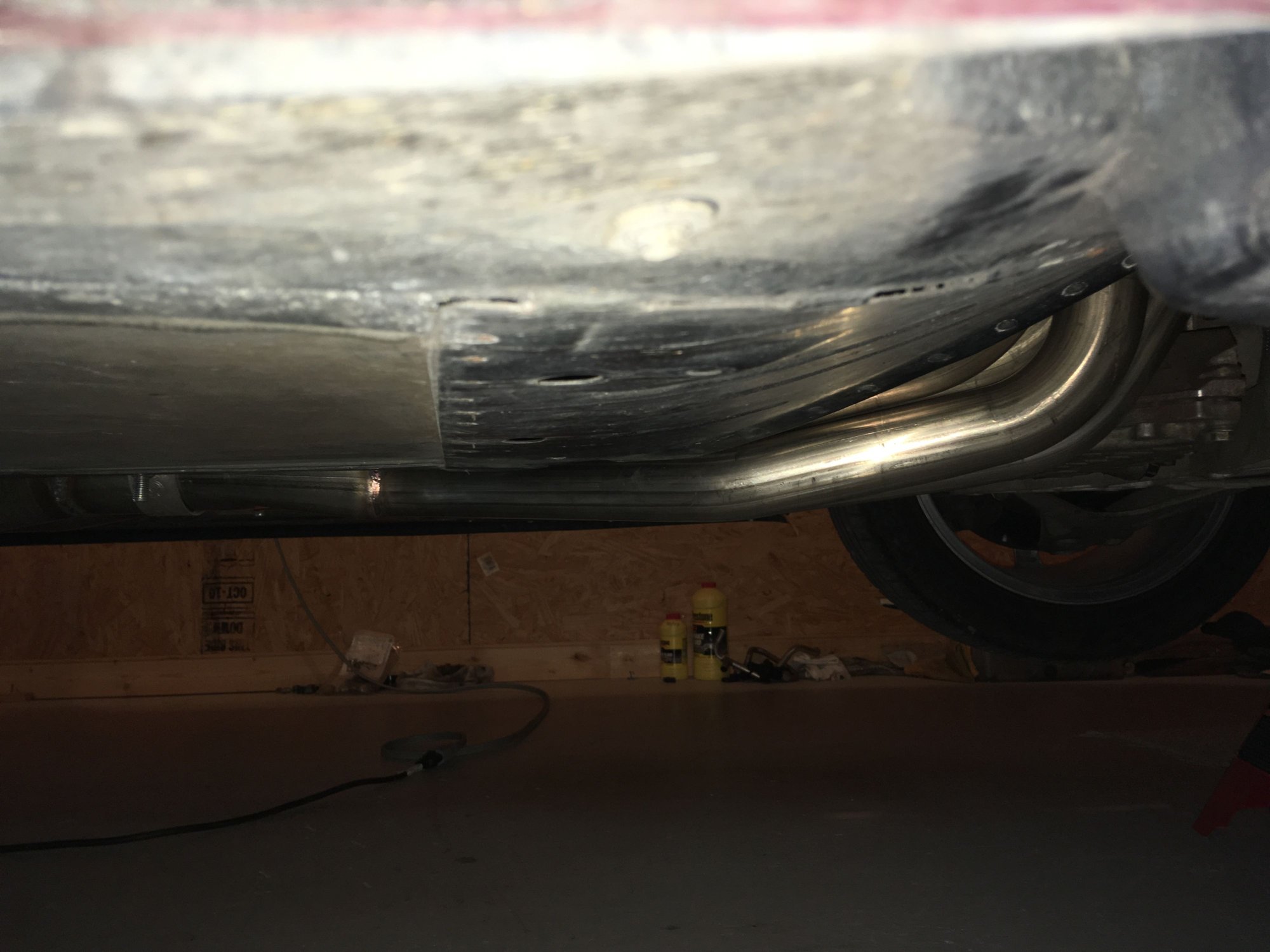

After a 150 miles I can say that I don't regret these headers but they are not perfect. They do work however and I have no leaks anywhere. I can't vouch for power gains at this time. Will be months and much heavier mods before dyno tuning.
My three biggest complaints,
One tube on the right hand header hangs down lower than anything else. Already smacked it on speed bumps twice. No real damage (just scratches) and this is not the first car I've ever owned with speed bump header contact problems.
The steering shaft does in fact rub every once in a while on one of the primary tubes. I've never felt it in the car, not once. I'll dimple the tube when the crappy 806 heads come off.
Last but not least and of course I knew this going in........SLIP FIT collectors kinda suck. No leaks at this time but I always pack slip fits with high temp RTV. I have no doubts they would have leaked without it.
Overall I am happy with the installation and for 540 bucks if they last I'll be OK with the purchase.

Here's the weird part Danny, the collectors in the tunnel are level. I think I posted a picture of that earlier in your thread. Its just one primary tube on the right side that hangs down like a half inch lower than the left side.

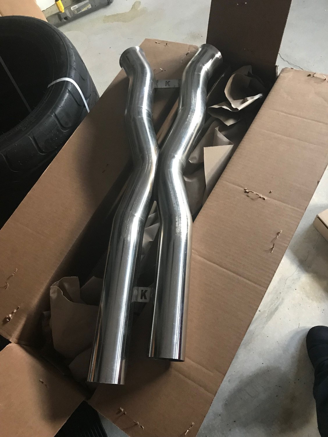

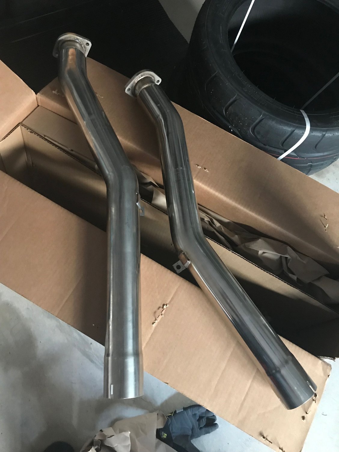

Christmas came early... Went with the Kooks 1 7/8" Race Headers with a 3" X 2.5" off road X-pipe. Sounds odd to describe an exhaust system this way but these things are gorgeous! Almost pains me to put them on the car and damage them! Very happy with my purchase thus far.
