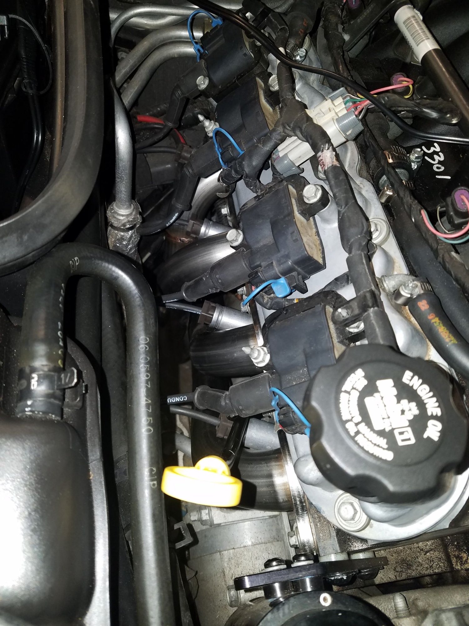

Hey Danny,
I am in the process of installing these headers on my car as I type this. The quality out of the box has been great and yes I used other brands of high end long tubes in the past.
Flanges are within a piece of paper worth of being flat. I was able to put both in from the top by myself. Valve covers off, steering shaft loose, did NOT jack the motor at all.
They're a little close to the steering shaft when installed but I don't think it will be a problem. Probably a hair over 3/16s inch gap.
Ground clearance appears to be great from what I can tell so far.
I might be able to get some pictures later today. Hope to have this job done tomorrow or Saturday. I still need to finish building up the mid pipes.

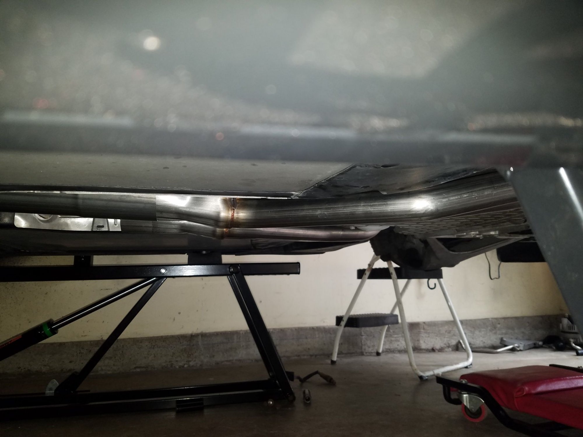

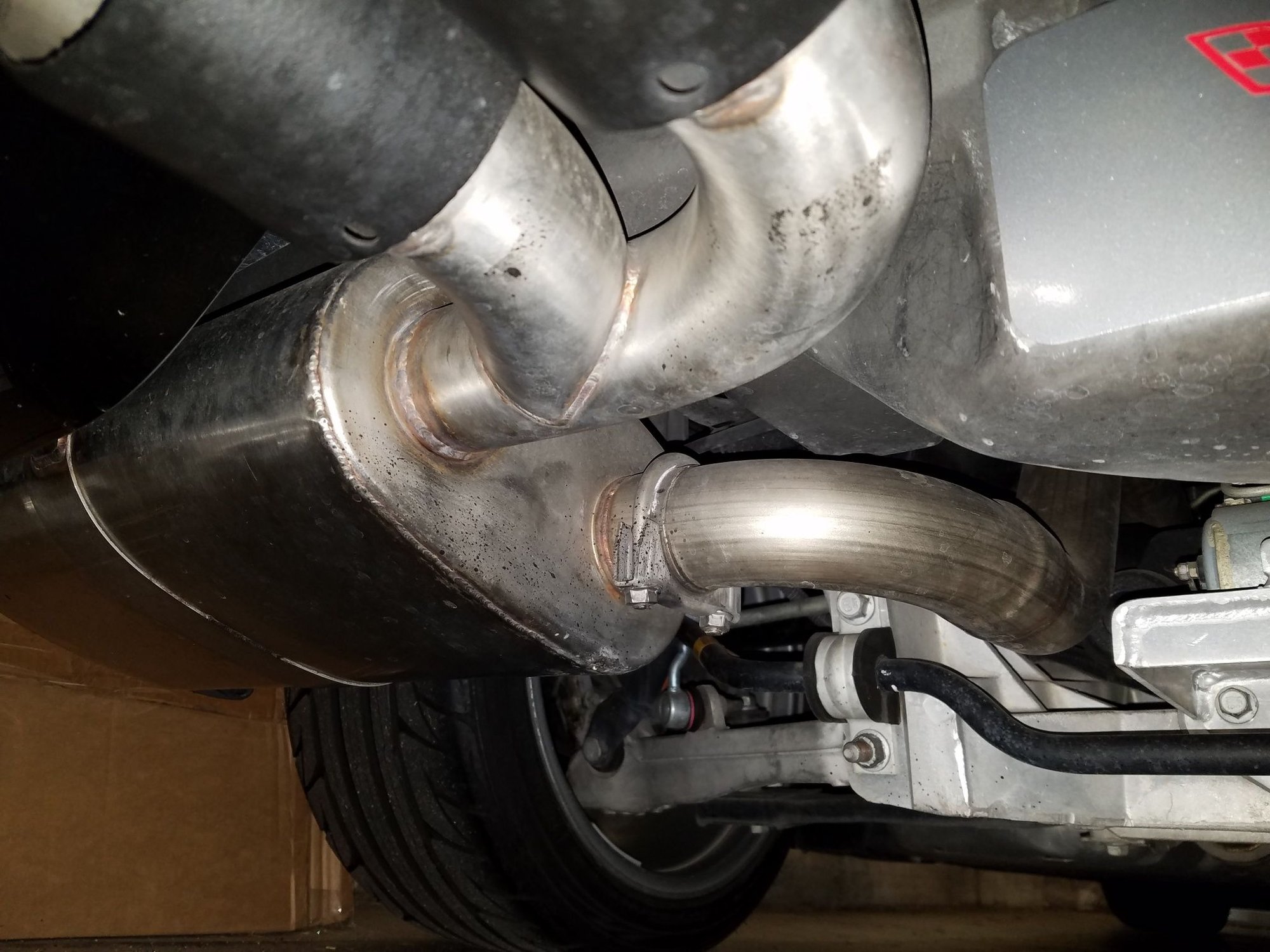

Pretty crappy pictures and it was kinda dark in the garage. I'll try and get some better ones in the day light.
It took me forever to get the 02 extensions to my liking. Needed 10 year old girl hands for some of this job.

Sorry OP don't mean to thread jack, but (Mr. Black) where did you get that plate to keep the o2 wires from touching the exhaust/headers?
Looks clean! Had trouble with wire management on mine.

It's an aftermarket tunnel cover made by TPS (not to be confused with TSP lol) and I can only guess that the holes are there for this purpose? That being said, I'm definitely not the first one to have routed the o2 wires that way on a C5. I don't see why you couldn't carefully take an 1 1/4" holesaw and make your own hole in a factory torque tube cover for the same purpose. Just make sure the hole is deburred very well.
Knowing what I know now, if I would have just routed the wires before putting the headers in place it would have been a two minute job instead of an hour job filled with expletives.

I had to remove the driver side header and finesse one of the tubes with a hammer as it was making contact with my steering shaft. So, as for fitment, they get a C. I haven't had any issues with build quality. They both bolt up fine and work as intended.

Didn't mean to scare you with the flanges. They're as flat as I would expect. Holding a straight edge on them and shining a flashlight to them there is a sliver of light shining through from tip to tip. I would consider that normal honestly. I did start it up last night with the collector extensions on there but the cat back disconnected and there was definitely nothing obvious at the flanges using GM MLS gaskets. Still have to finish the mid pipes today.
The catback on this car is a mystery. It is either a really old Corsa touring type system or possibly a copy of said system. I don't know if it's foreign or usa made, but going by the stamps on the tubing I am leaning towards USA. It sounds great for a stock cam but I think when I do my cam and heads it may go to the loud side lol.

FR, how much of a gap did you have at install? or was it touching right out of the box?
I was reading another thread in here from a year ago where a guy posted a picture from about the same vantage point as my picture of the drivers side above and he had almost a half inch of clearance. So yeah, that kind of inconsistency is a little disappointing.
