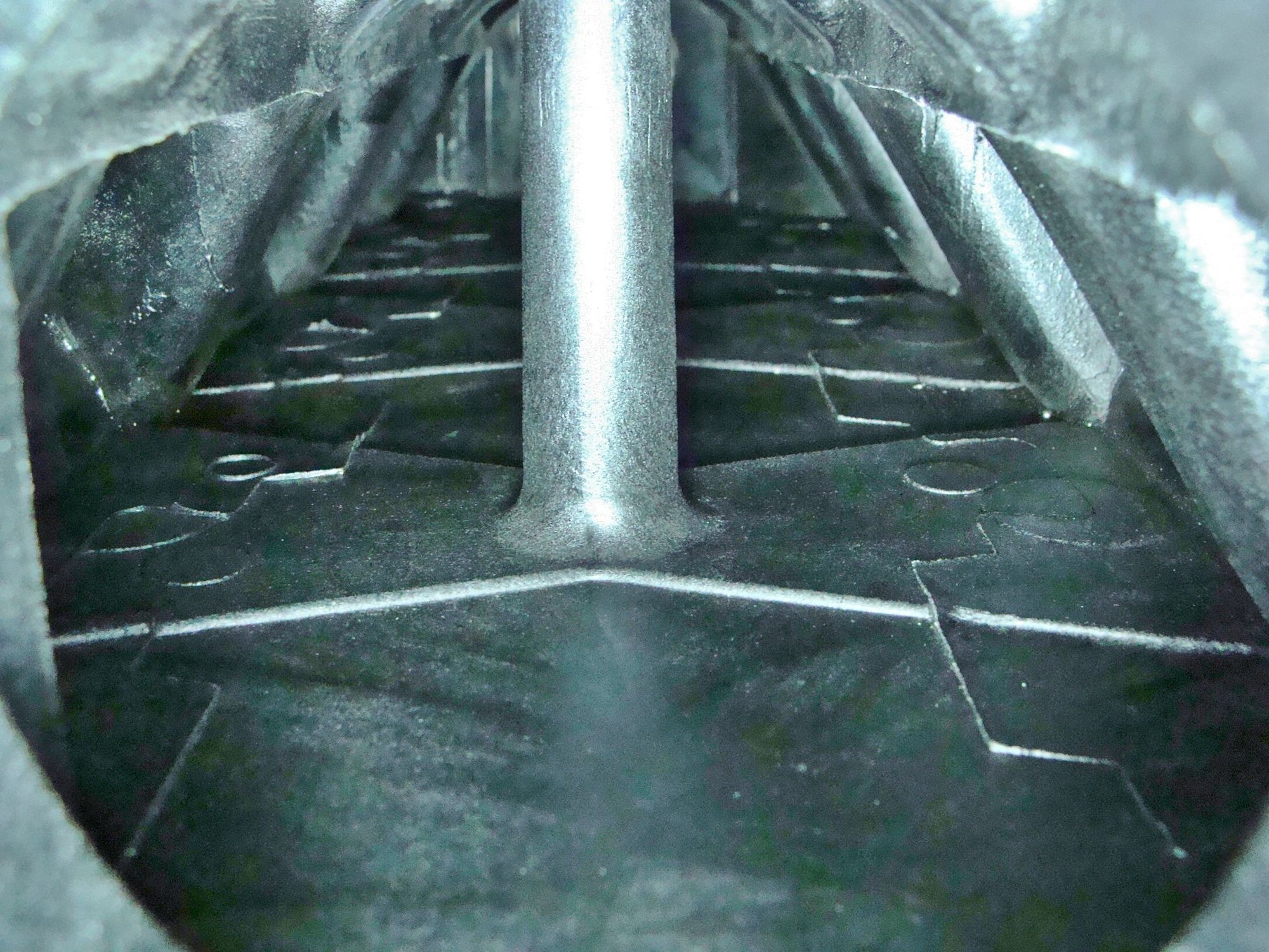

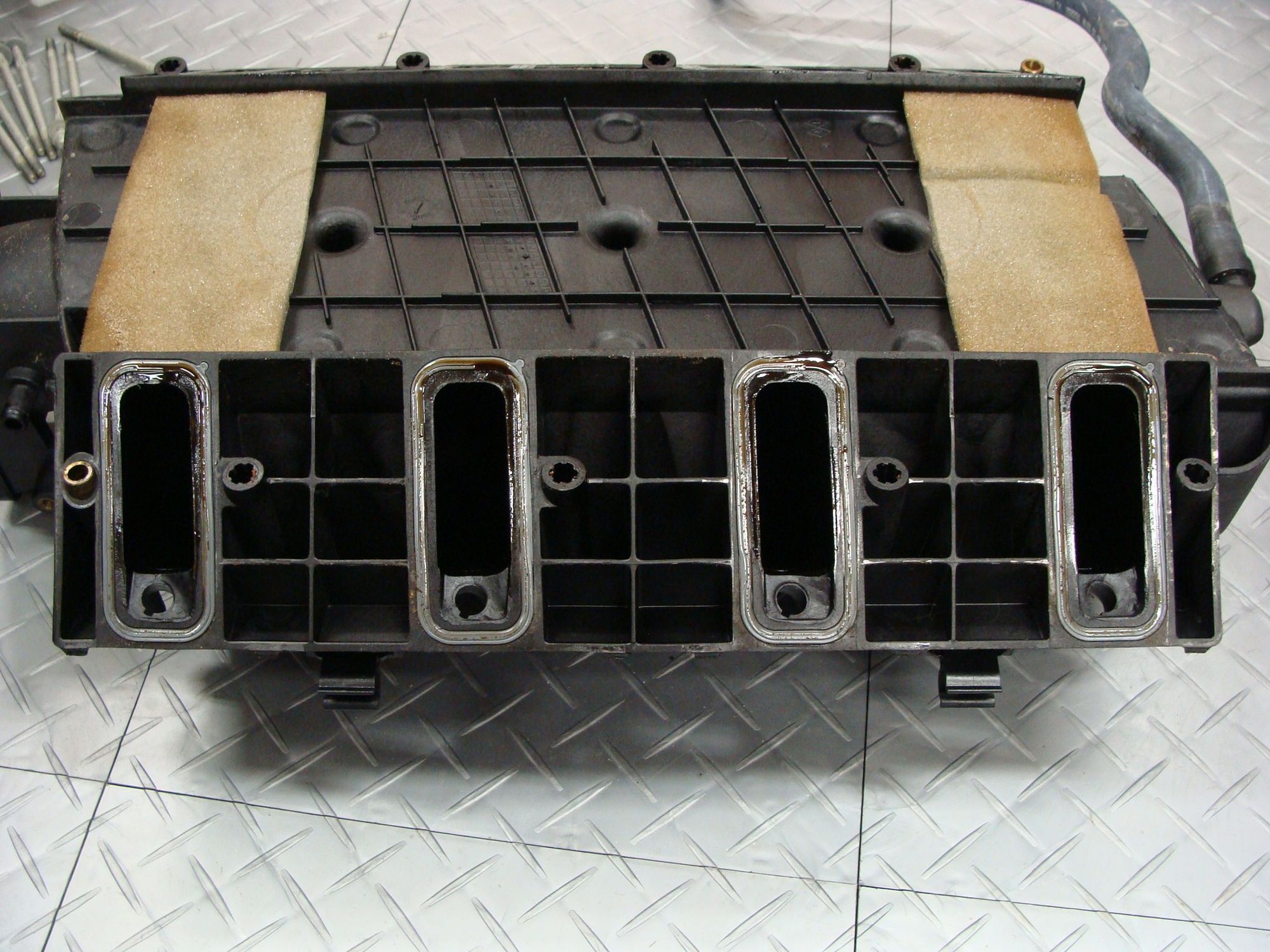

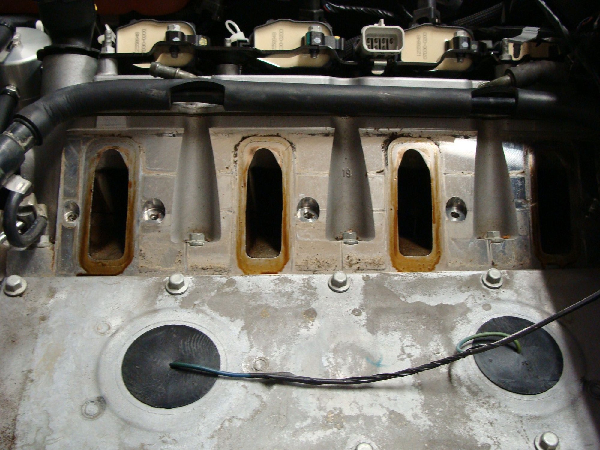

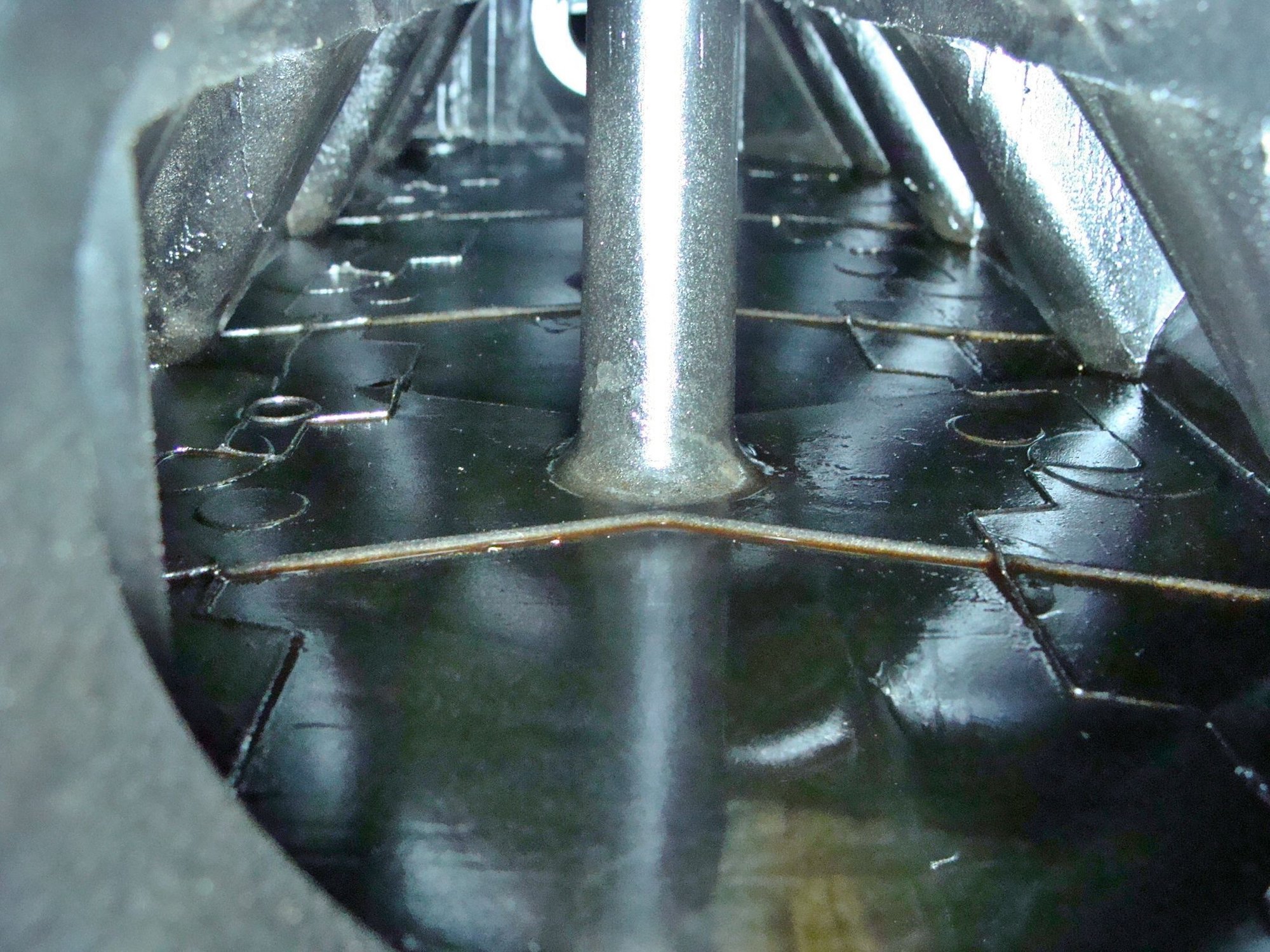

Give your intake a good cleaning when you get it off, My car had around 7,000 miles when I did mine & installed my catch can, I was shocked at the amount of oil that was in & around the intake with such low mileage.

they look good. as long as they are raised higher then the manifold and their is no dry rot and still elastic there fine. But like people said' change if it amkes you feel better.
