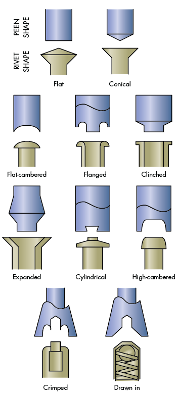

Thanks again steering_experts1 for identifying this part. Based on some rivet examples below I believe this would have been a solid rivet with a high cambered or flat head. The semi-circular shape is most likely where I have ground this down enough to expose part of the rivet shaft. I think there is still enough of the flange or head of the rivet in place to keep this from backing out. Do you agree or should I put a tack weld on there for extra security?
