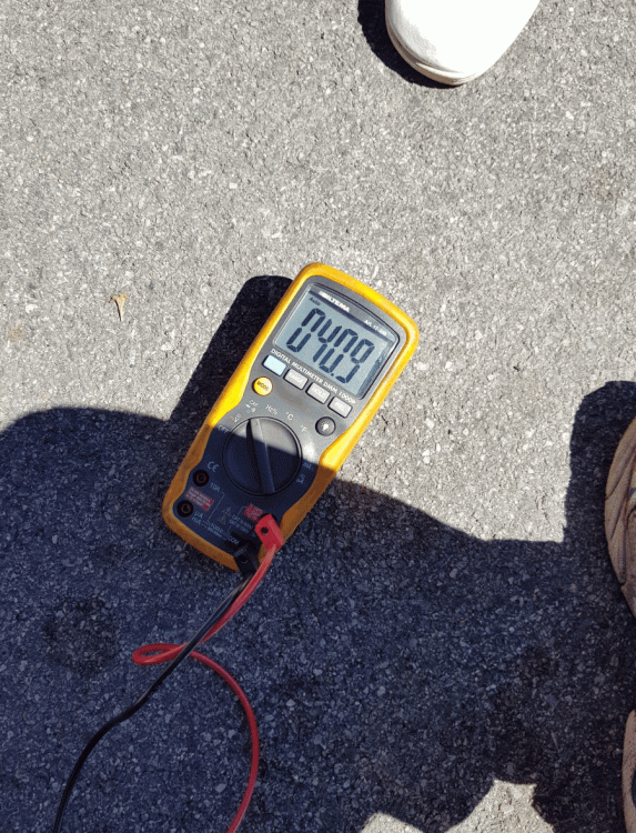

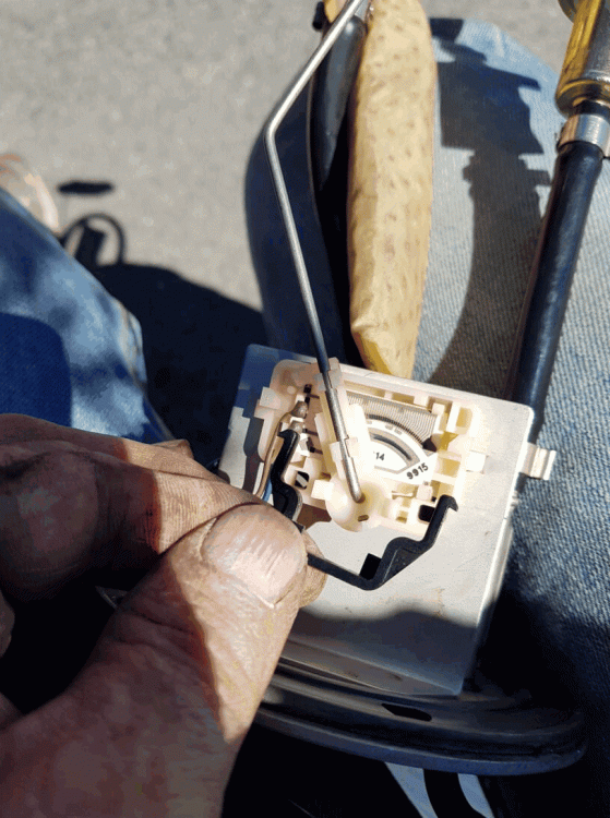

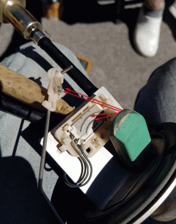

If you end up removing the right sensor then you can check the resistance on the sensor element when you move the floating element all the way . It should move between 40 ohm(empty) and 250 ohm(full tank) If the variation in resistance is not smooth , then you can try dismantle the sensor and clean the contact points carefully with a eraser like I did last summer . Do not use sandpaper , it will ruin the contact points .
