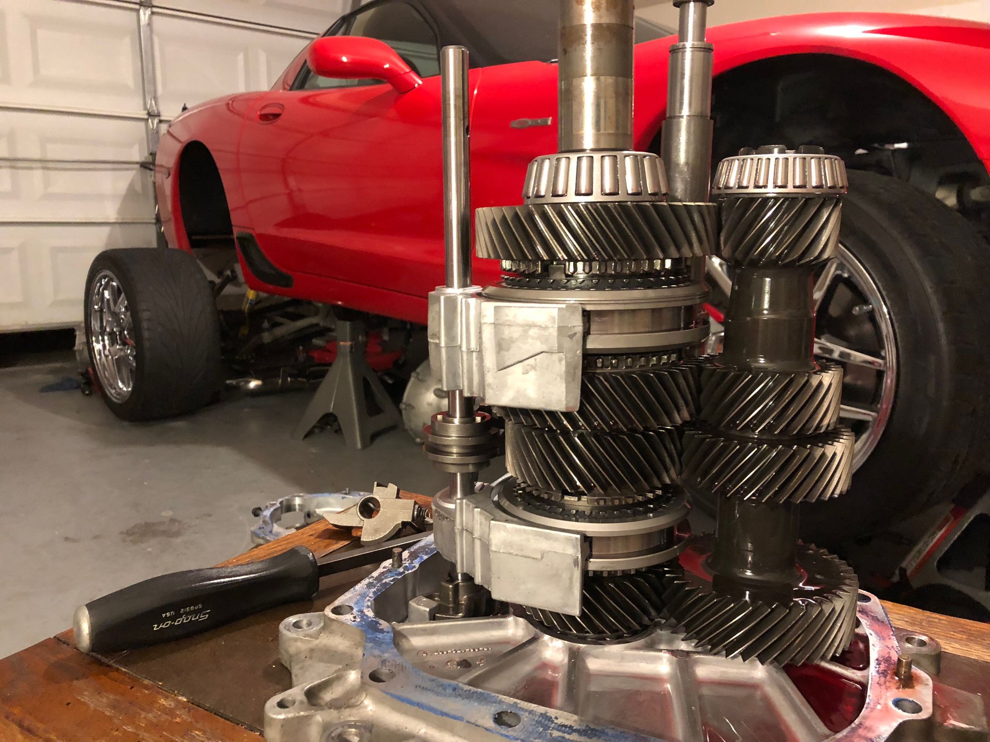

I have my gearbox apart for the exact reason.
The nubs on the 2nd gear and the synchro collar (not to be confused with synchronizers) are worn. That’s due to aggressively shifting into 2nd gear at redline over 40k miles. When the gearbox comes apart (which is needed to correct this) you’ll find that the same aggressiveness that killed 2nd, has also to a lesser degee eaten 3rd gear. -but 2nd is acting up first because it’s been used more and taken more abuse.
2nd gear from Tremec costs $311 and the 1/2 synchro assembly costs $125. What’s going to kill you is the labor.
My build started a couple months ago but hasn’t been finished as I’m basically upgrading everything in it to the tune of over $2k parts alone. Other life priorities have taken up my time. Should be done next month.
Also it’s rare but the 1/2 shift fork is aluminum and can bend slightly. It’s only $17 so I’d change it too when doing the rest.
