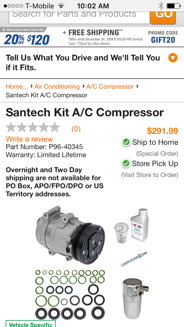

This is my exact kit, looked up the part # from my receipt. Came with both types of orifice tubes, o rings and seals, oil, drier and compressor.
Ooh you can get 20% off, I only got 15% off buying in summer.

I drained the oil out of the new compressor and it had a very small amount, when adding oil and spinning hub it puked out what I put in, like one ounce.
Decided to to drain that back into the measuring cup provided, then I added oil into the receiver drier, outside of car, then put shipping cover back on drier and put in car.
