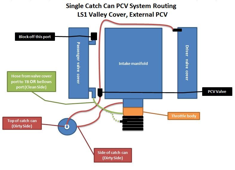

If I replace the stock valve covers, specifically the passenger side which has PCV connections at both ends, with a valve cover that only has a PCV connection at the front towards the throttle body, will I have performance issues, throw any codes, or have issues passing smog (I live in CA)?
If it is not an issue, what is the best way to bypass the connection on the rear of the valve cover? According to this diagram, the connection in question is the dirty side line on the passenger side.
Circled fitting absent from aftermarket (Proform) valve cover.

My mechanic said it would be no big deal to either install a fitting on the left side or put a T at the front fitting. My choice would be to install a fitting on the left side. Seems a lot easier than switching the entire PCV system.

I agree with your mechanic. You will be fine having only one inlet on the passenger side versus two. If you look at a schematic of the factory configuration, those two connections are T’d together before going through the PCV check valve anyway. I currently have single port valve covers with the “old” style PCV without any issues. I am running a catch can and followed the schematic below. Pretend the catch can isn’t their if you don’t have one and plumb the system accordingly. Notice the second port on the passenger valve cover is “capped”, aka not there.
That would be my new setup, as I have a catch can installed. No worries of throwing any codes?

I've been running my PCV system exactly as shown in the diagram for quite some time with no codes

sorry to bring this back from the dead but this post seemed to have the best diagrams.
being its a pain to get the hose kit for a 97 c5 i just plumbed mine with a PCV from autozone and some different size lines to accommodate the big 7/16 hose that had to go on the one side of the PCV.
but what is that dotted line that goes to the clean side. i don't have that plumbed in

Good diagram in your 97 service manual under: Engine - Engine Controls - 5.7L - Schematic and Routing Diagrams - Emission Hose Routing Diagram

Convert to newer LS6 valley cover.
LS6 PCV does not have DS/PS rear connections, only PS front for fresh air to air bridge.
