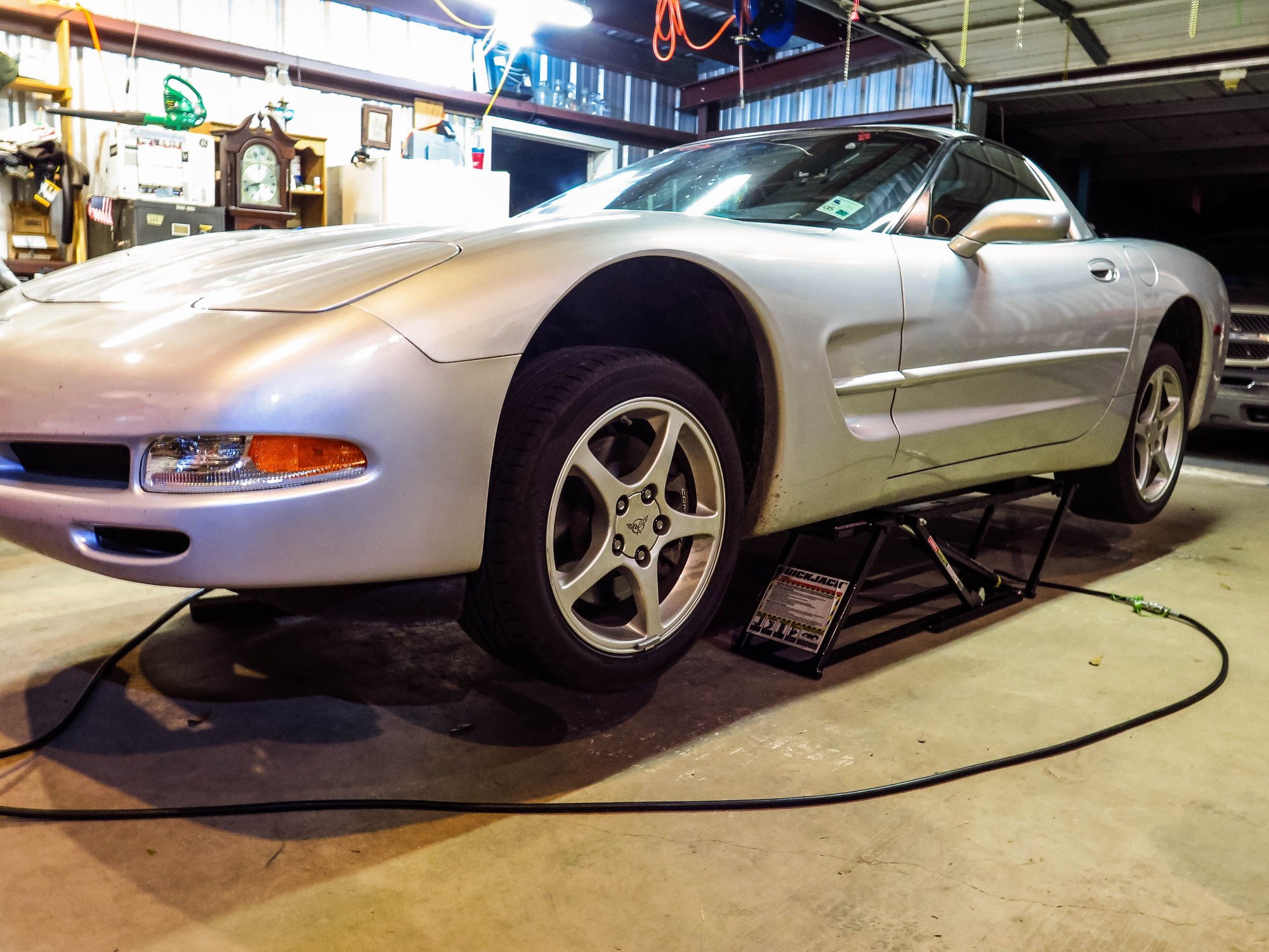

My turn signal problems all related to the socket being fairly burnt and bad connections. Had changed out the sockets last year when I repainted the nose but they burnt out again pretty fast. At times I could just tap on the bumper with my hand and they would come on. Then hit a bump down the road and the bulb loose contact and not work. I finally got fed up with it a month ago and ordered a better quality socket set, LED bulbs and a Hyper flash unit for under the dash. While there I put new lens assemblies in also. Totally satisfied now. Here's a pic of the finished job before letting the car back down. And, yes there is a paint mismatch on the nose from when I painted it last Spring. I have the stuff to redo it but not the mood yet. Perhaps this Spring. ;-)
